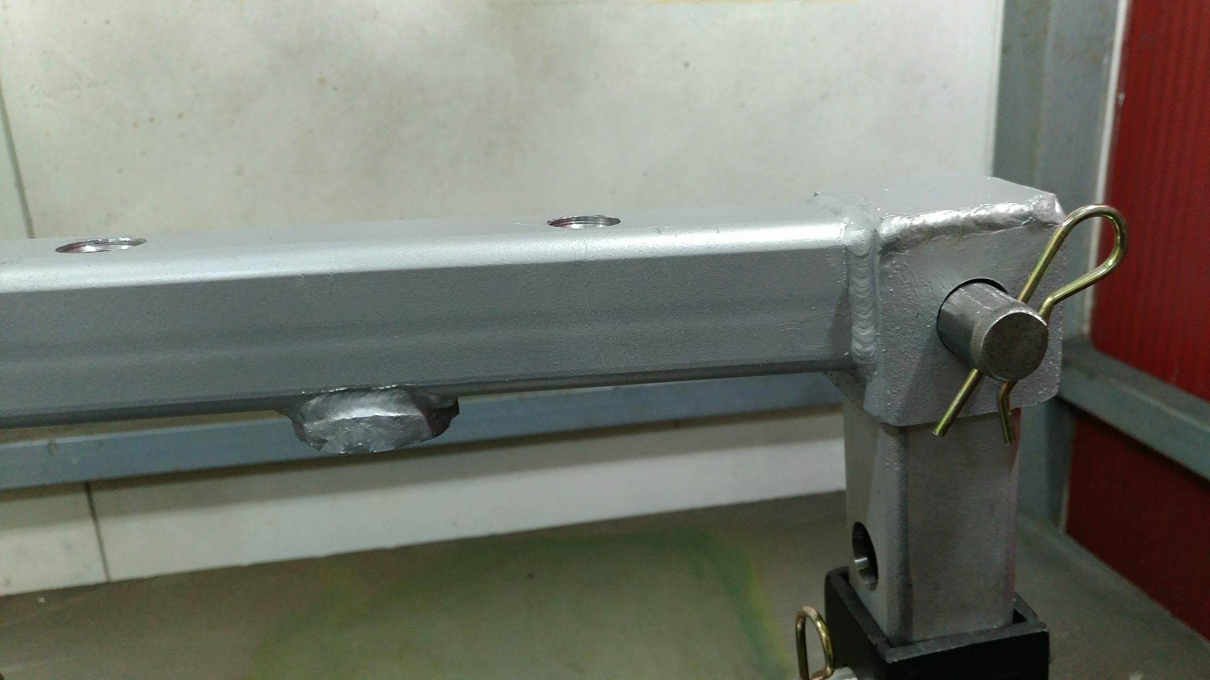

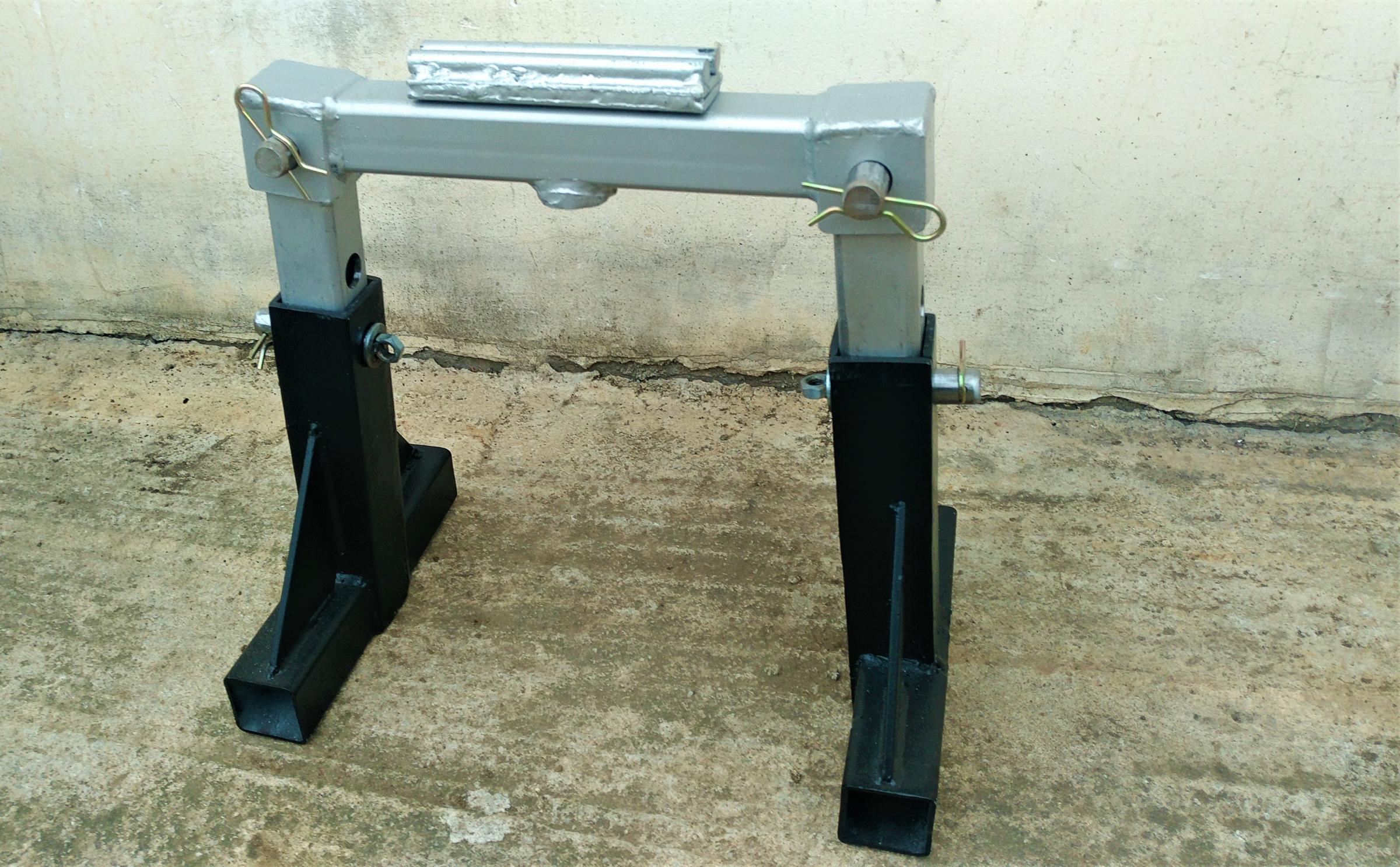

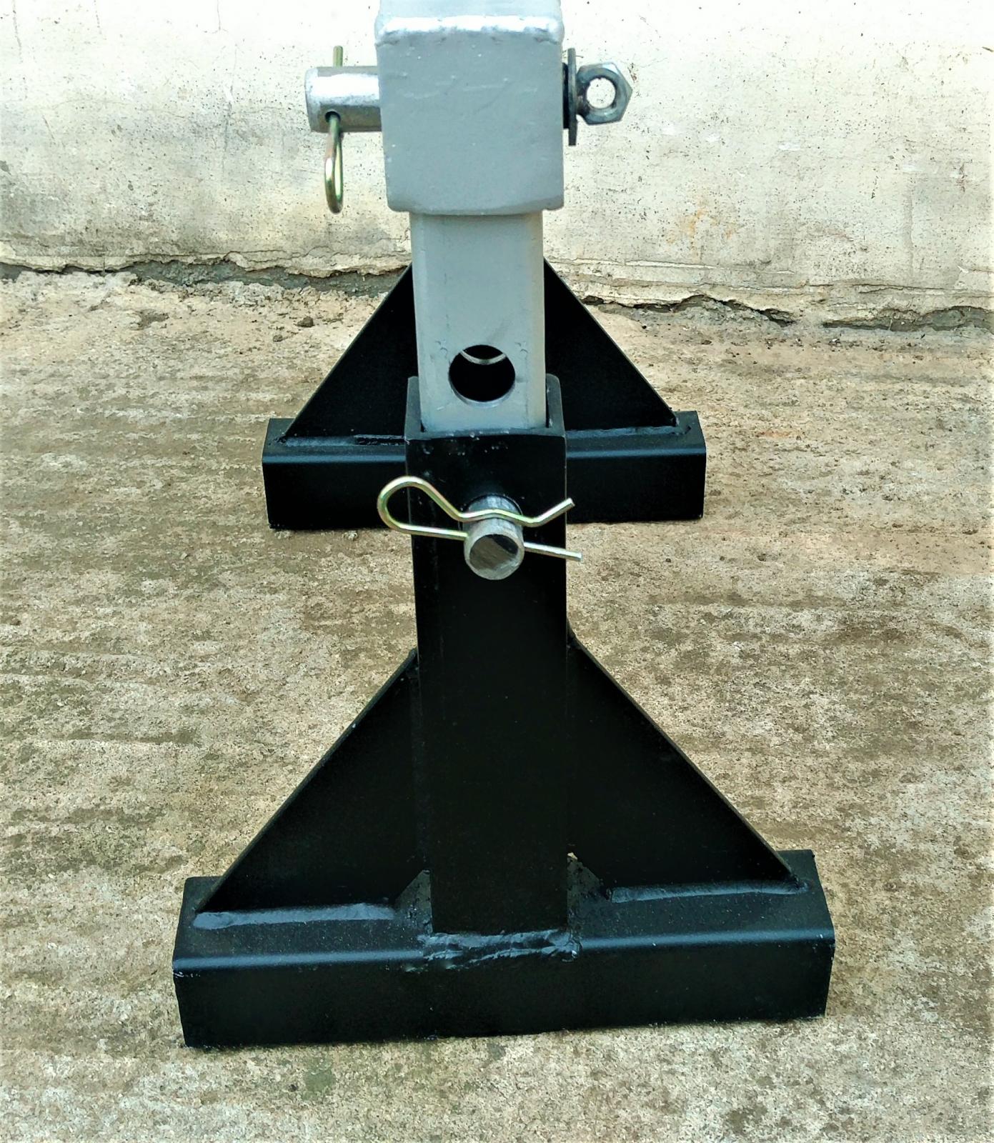

    Homemade Axle Stand
    Hello Guys I m back and thank you all for your support.
    This stand its very useful for me but expensive to buy one so I decided to make some of those.
    Dimensions :
    Maximum height is 48 cm
    Minimun is 35cm
    Body 50x50mm x 5mm -- 40x40mm x5mm

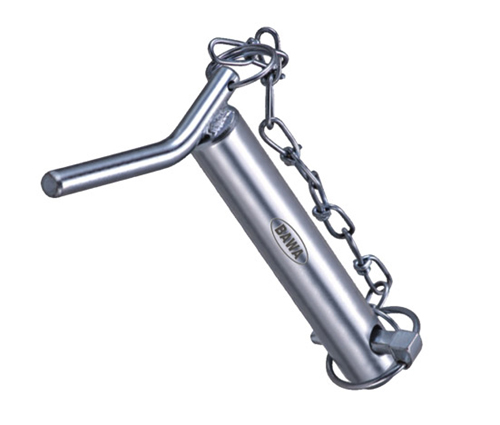

    Pins 19mm its homemade but I ordered something like this
