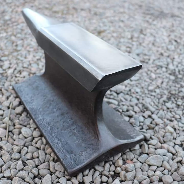

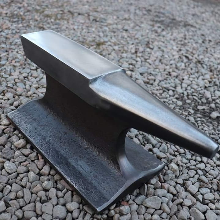

    Made a new RR-track anvil.
    Lenght 450mm / about 18"
    Made with the same way than earlier one.
    This is also for shaped for shaping sheet metals.
    Hardening was made in heat treating oven. Started with preheating it to 660 degrees of celsius, temperature was raised 200 degrees / hour. Then it was heated to 1000 degrees and hold in that temperature 30 minutes.
    After that it was cooled to water. And finally heated to 300 degrees of celsius and kept 4 hours in that temperature, and cooled to water.

    I have about 24" of 120lb rail and contemplated converting it to an anvil. Looks like a lot of grinding. I have one thing going for me I can mill the top flat and begin the tapper for the horn on my knee mill.
