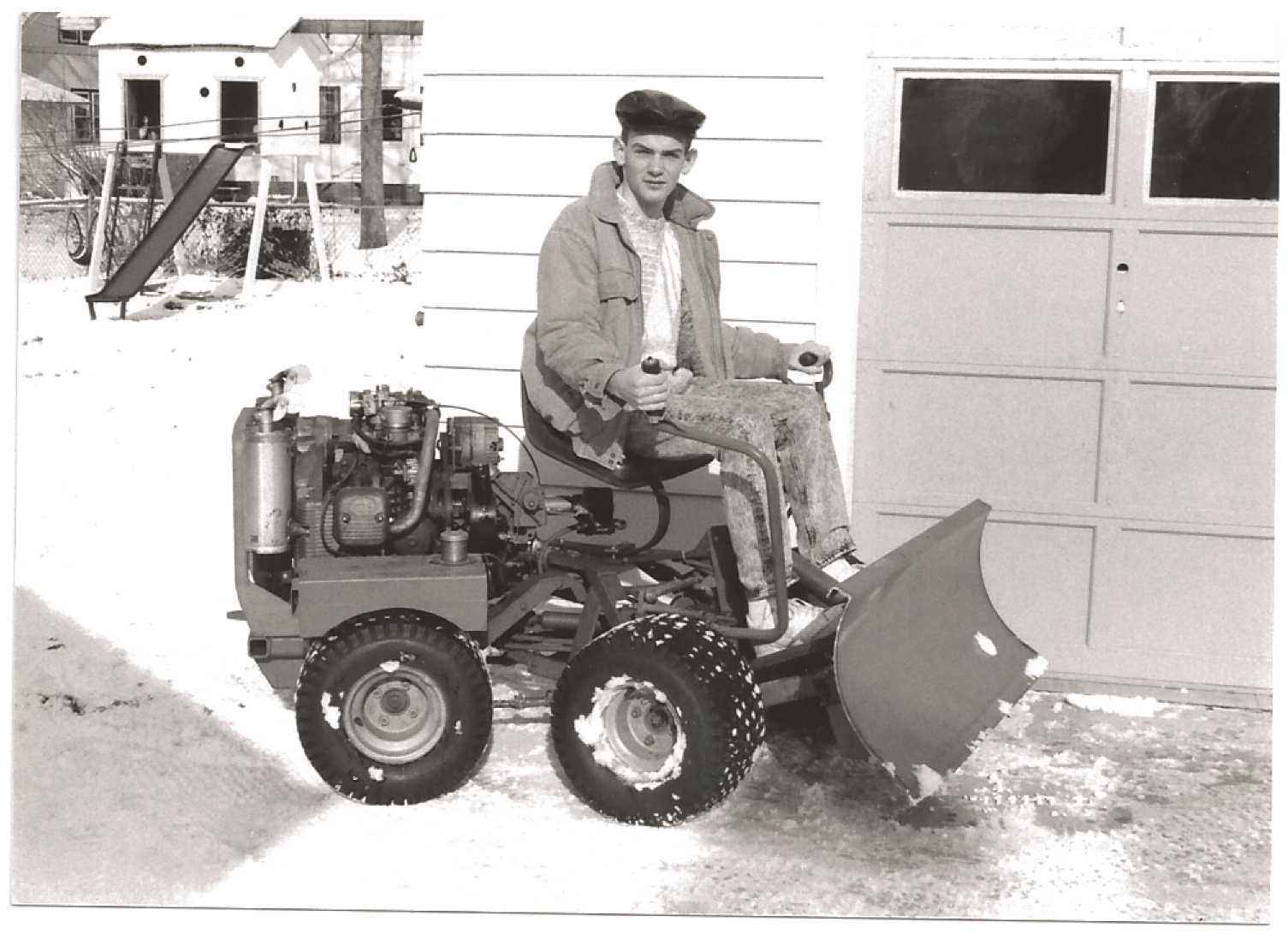

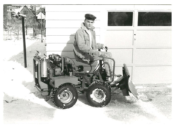

    I built this 4x4 articulated tractor about 30 years ago using 2 narrowed Cushman Truckster axles, a Cushman 2-cyl engine with a modified Sundstrand hydro mounted to it. Used a power steering cylinder from a '69 Mustang to steer it. Right hand control was via a "joystick" for variable FWD/REV & steer left/right. It had a twist throttle on it and as a safety feature; there was a button on top that one needed to push down to allow going into reverse.
    Left hand was a similar arrangement for the blade control; up/down, left/right. Blade had a stiff spring-biased link that allowed the blade to fold under should it hit a solid object, then it snapped back when backed off.
    Unfortunately, I don't have any videos of it. But it sure worked great for clearing our driveway which was quite long.
    In the "off season" I remember giving our young daughter rides around our rather small front yard. She really liked it.
