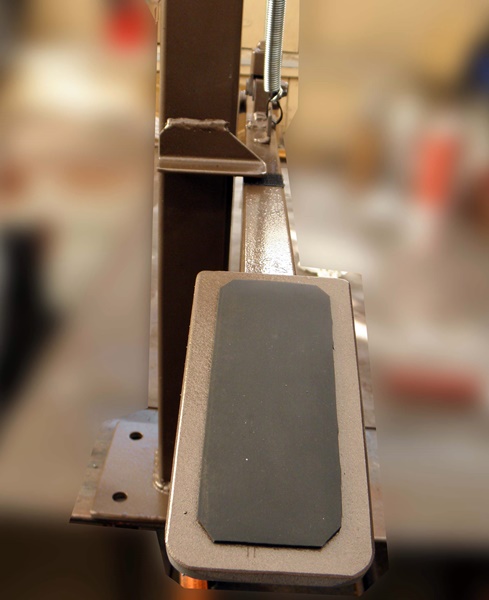

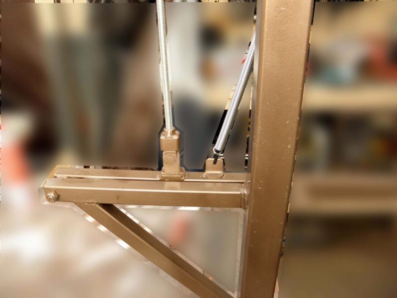

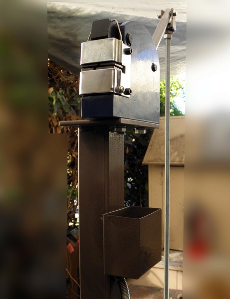

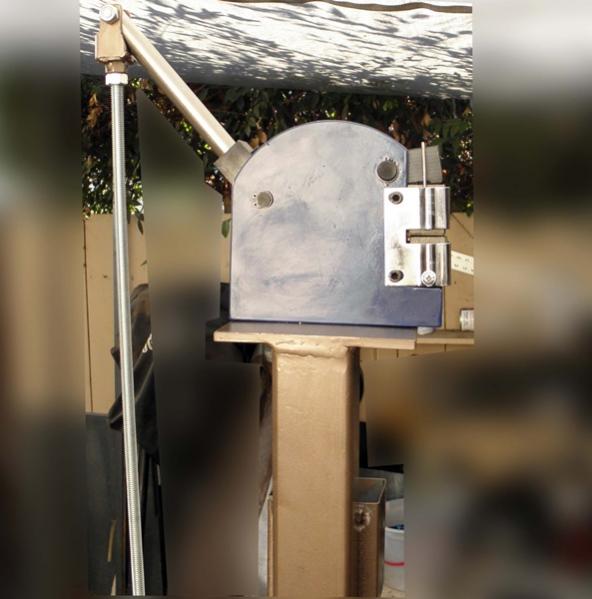

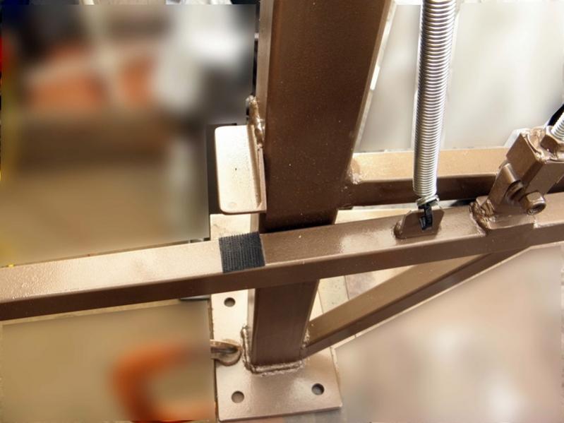

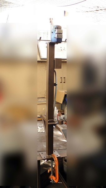

    Home Shrinker-Streatcher Stand.
    DIY Shrinker-Streatcher Stand.
    Made from 2x2x1/8 inch square tubing and 1x1x 1/16 square tubing, 1/4 inch steel plate, screen door spring,3/8 threaded rod,sheetmetal.
    Special Thanks to Ron over at metalmeet.com for the free plans for this stand which I found on youtube. https://www.youtube.com/watch?featur...&v=7ZdFtGeVJvw
    His is the double version I made a single version with a small box on the post to keep the second set of jaws in. His has a H base While mine is set up to be bolted to the cement floor.
    Home  Shrinker-Streatcher Stand.-023.jpgHome  Shrinker-Streatcher Stand.-021.jpgHome  Shrinker-Streatcher Stand.-022.jpgHome  Shrinker-Streatcher Stand.-024.jpgHome  Shrinker-Streatcher Stand.-020.jpgHome  Shrinker-Streatcher Stand.-025.jpg

    Doc Don't feel Bad. if your not in the sheet metal fabrication trade no one would know what this tool is.
    simply put it stretches sheet metal and it shrinks it by two jaws pulling or pushing sheet metal.
    mostly used for shaping auto fender wells, door jams or bowls and sometimes
    metal art projects. Thanks for asking...:O)
