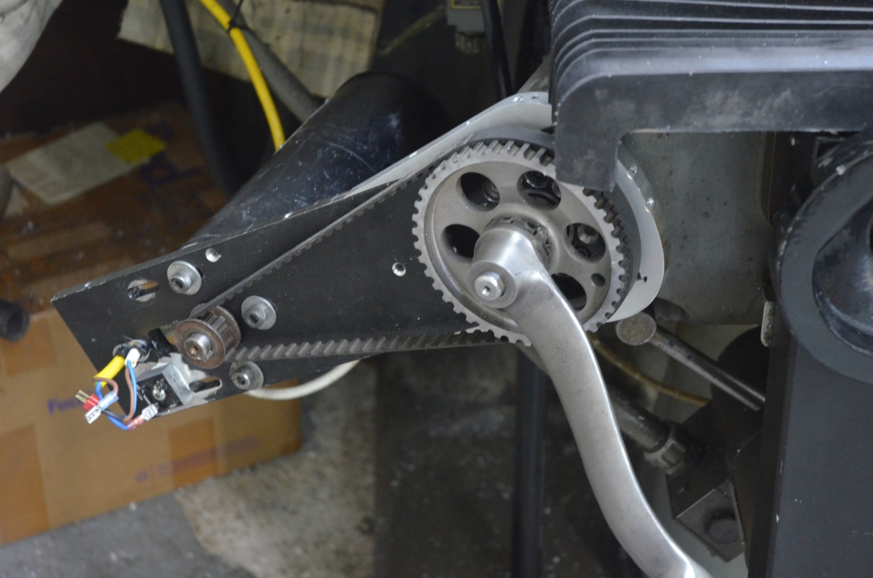

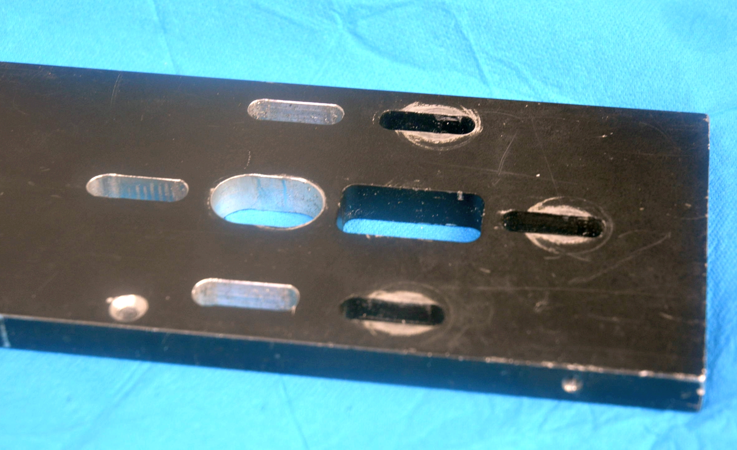

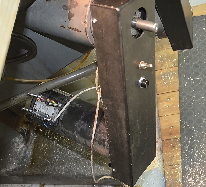

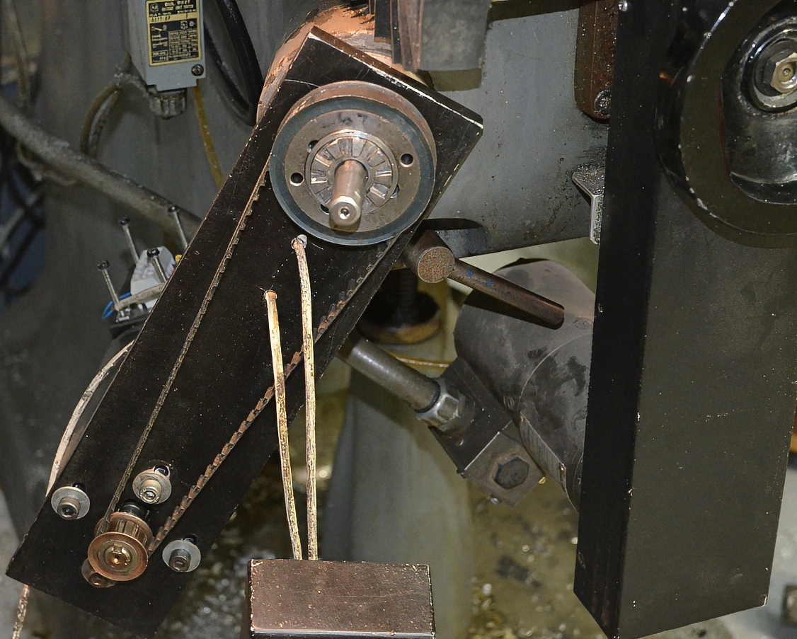

When I bought my mill it had been fitted as a CNC machine from new but with it I also scored a spare set of servo motors and all the gubbins for mounting, including belts and pulleys etc. So it was just a question of bolting the motor mounting plate to the knee and fitting the motor and belt. The mounting plate (13 mm aluminium) already had the motor mounting slots, so it was an easy and quick job. I added a two way switch to set direction, up or down, and a momentary button switch to activate.
Home made powered knee lift on milling machine.-dsc_1399.jpg Home made powered knee lift on milling machine.-dsc_1401.jpg

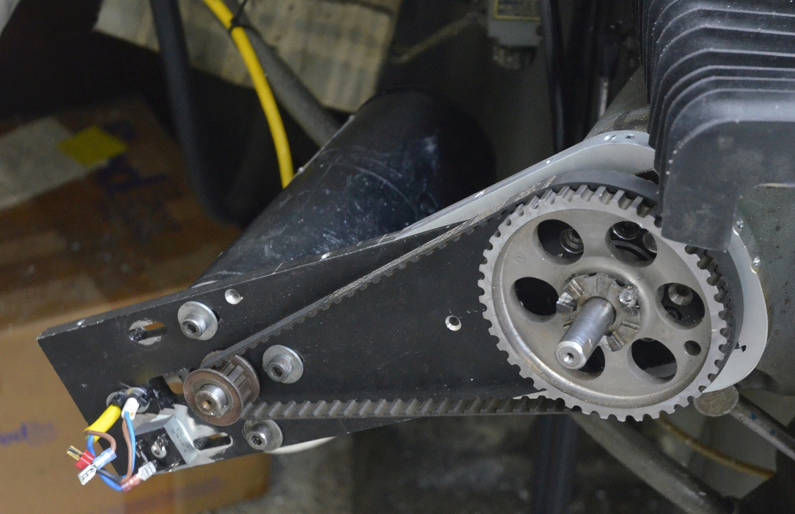

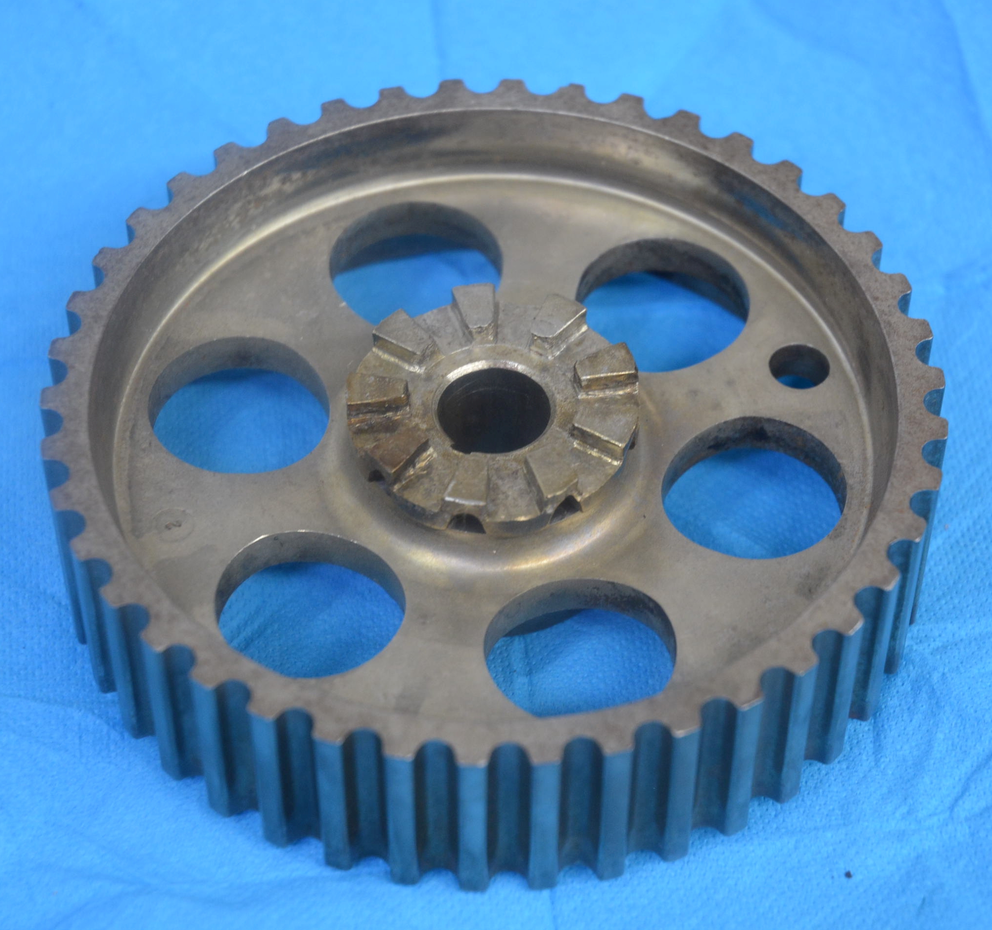

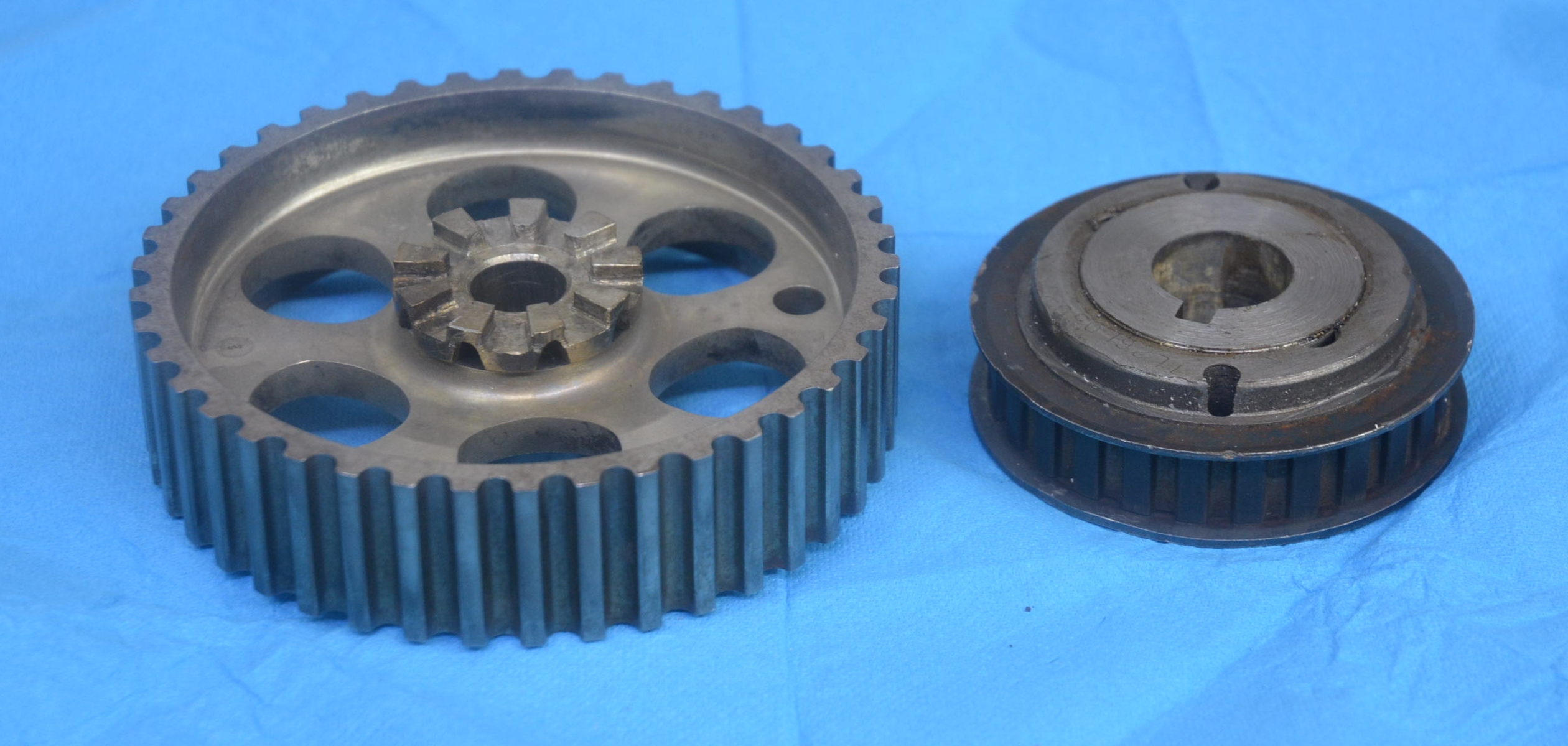

It worked but it really struggled. Then I did something that I should have done in the beginning. I measured the torque needed to wind the crank. It was higher than the motor and its gearing was rated for. I decided to replace it with a bought one but before I placed the order I came across a camshaft pulley that I had saved off an old car. It had 42 teeth in place of the one that I had fitted of 26. That would give a near 62% increase in torque. I was confident that would be enough to transform a working device that struggled into one that was adequate for the job. Even if the motor was a bit highly stressed its duty cycle will be very low. A few seconds use followed by an hour, week or month of rest. The teeth had the same pitch as the belt and lower small pulley but the tooth form did not match exactly. I considered the likely number of hours use that it would see in its life time and decided not to worry.

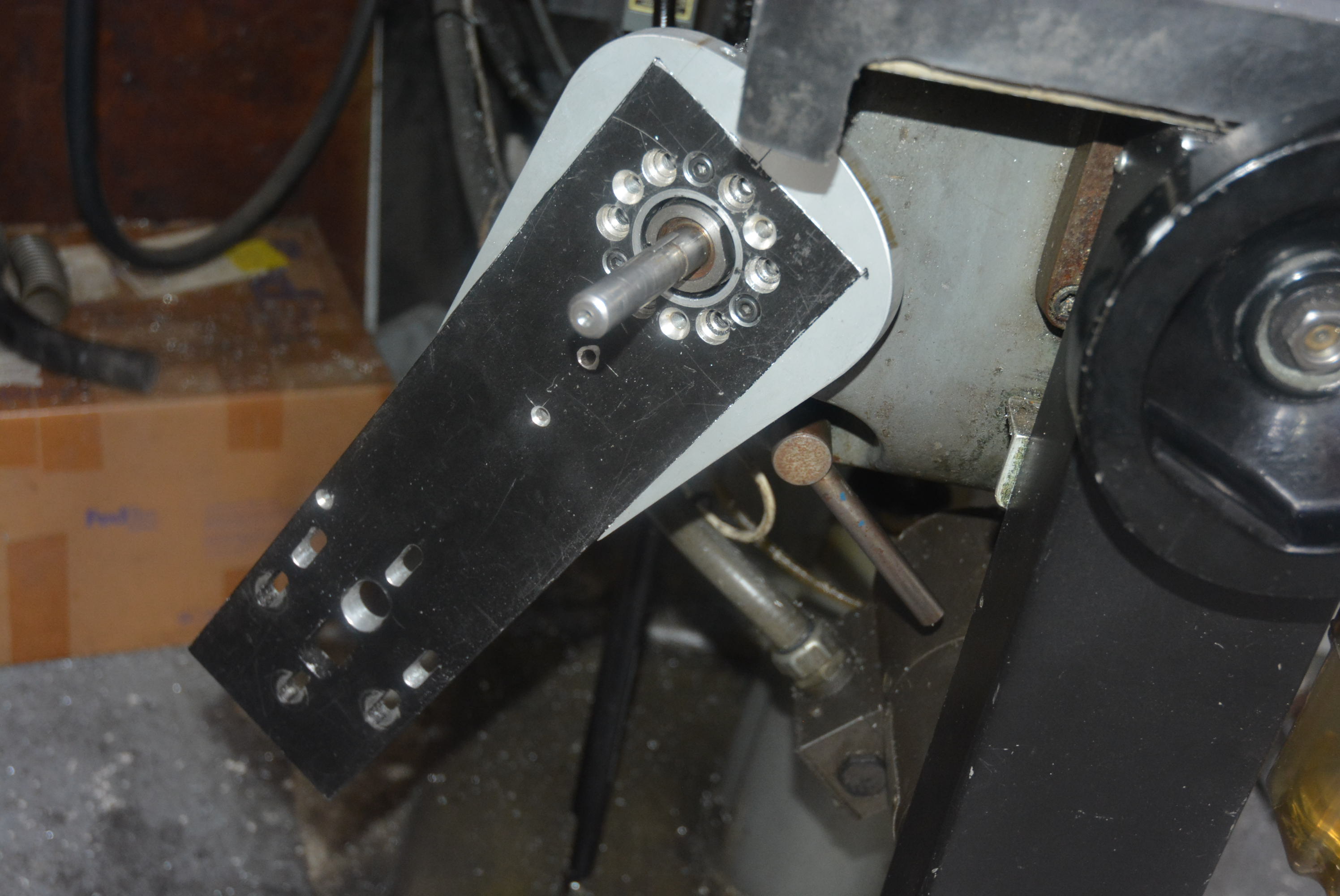

I wanted to keep the ability to use the original crank and with pure luck the sleeve that the castellated drive piece was connected to was a perfect fit in the hole of the pulley. So that saved making any sleeves for fitting the new pulley.

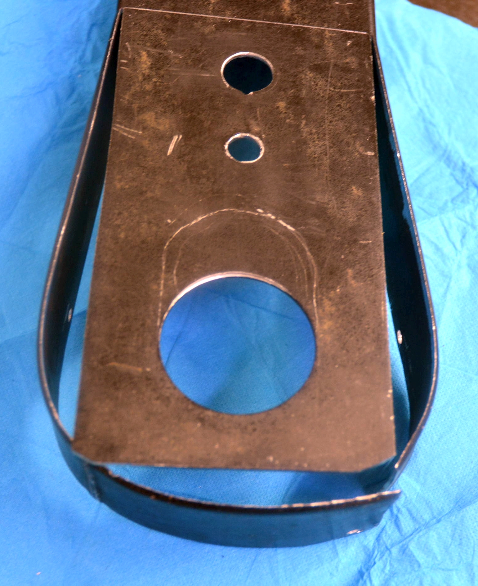

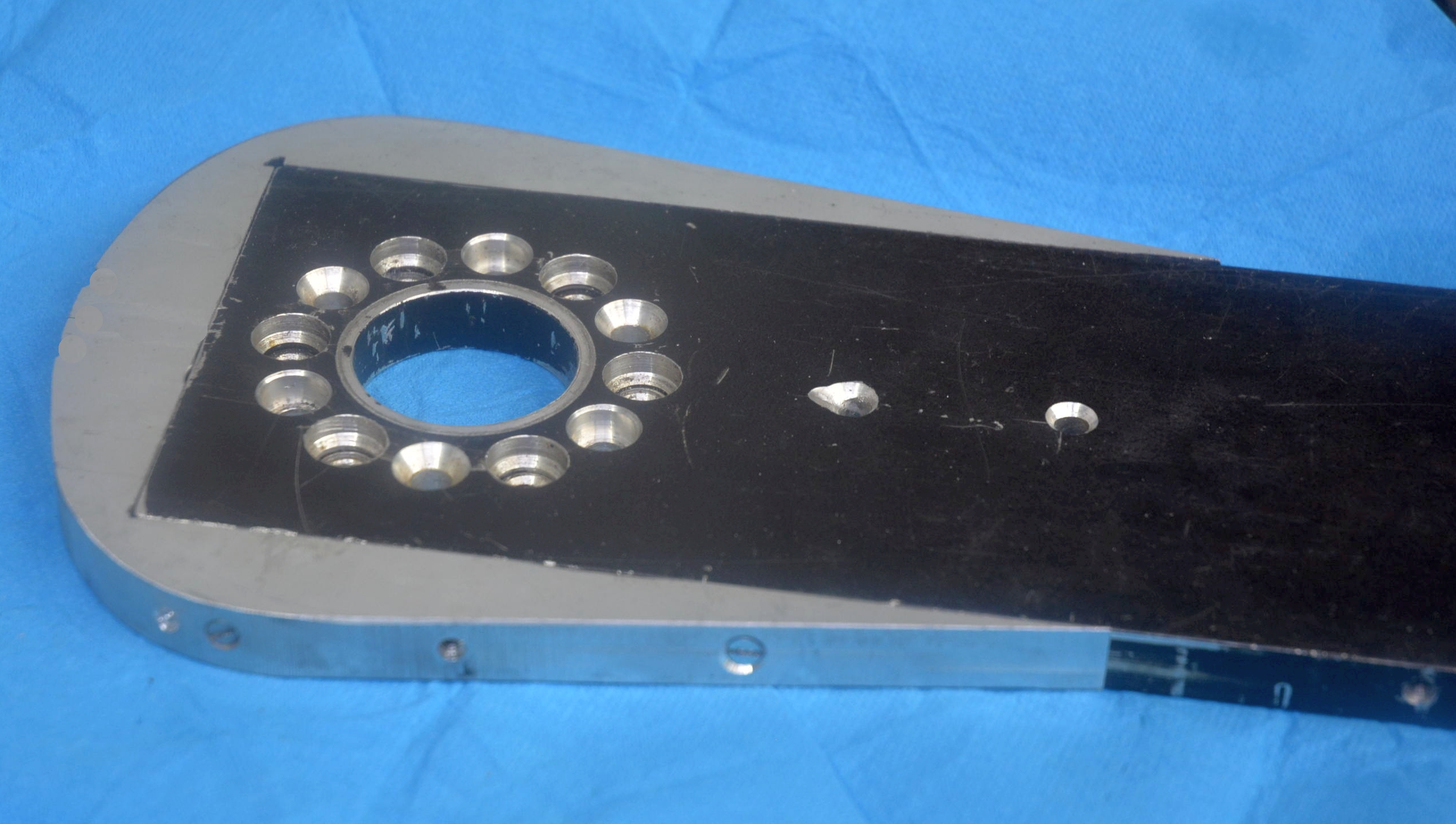

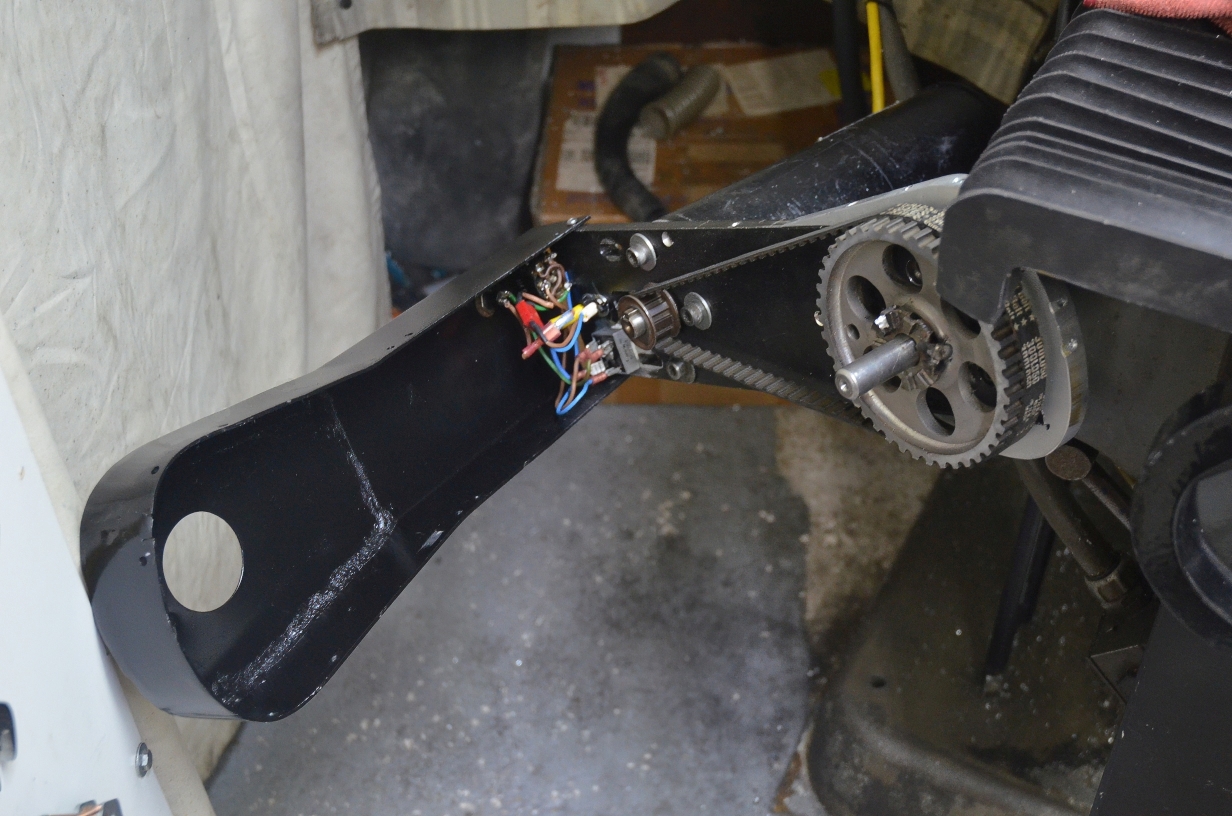

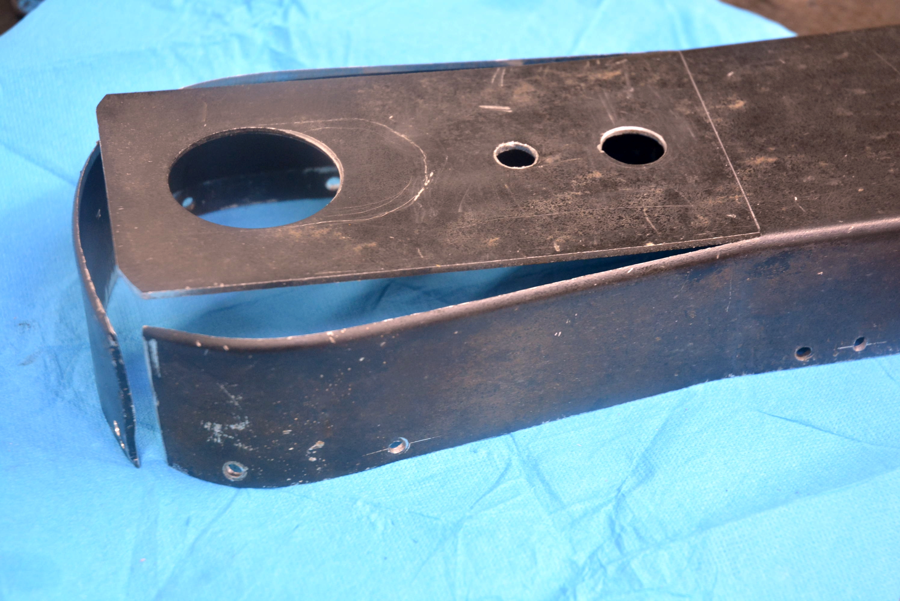

The larger pulley did not fit inside the original safety belt cover and I modified it to suit. Firstly I added a piece to the mounting plate, a bit larger than the new pulley, upon which to fit a modified cover.
Home made powered knee lift on milling machine.-dsc_6051.jpg Home made powered knee lift on milling machine.-dsc_6056.jpg
The larger pulley dictated that the motor be moved closer to the top pulley to retain the original belt, as shown below.
Home made powered knee lift on milling machine.-dsc_6052.jpg Home made powered knee lift on milling machine.-dsc_0002.jpg

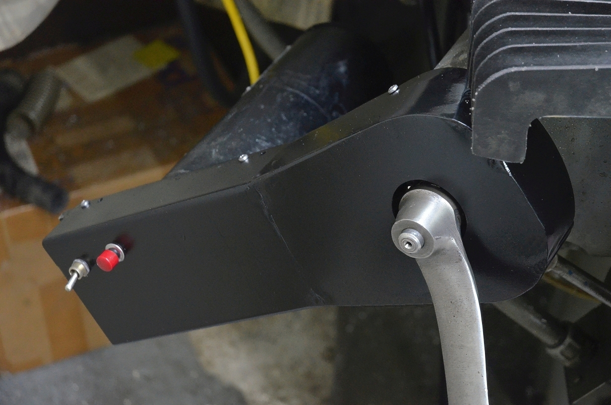

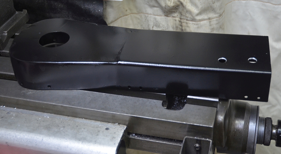

I cut the sides of the cover such that I could bend them around the new piece on the mounting plate. I cut the flat part of the cover along the line at the top of the photo and cut out a replacement piece to suit the new shape and welded it together
Home made powered knee lift on milling machine.-dsc_6054.jpg Home made powered knee lift on milling machine.-dsc_6053.jpg Home made powered knee lift on milling machine.-dsc_0006.jpg
The cover can be pivoted about the lower two mounting screws when all the others are removed. This allows to for belt tension setting and gives access to the electrical connections to the switches, without having to disconnect the switches to remove the cover.

The next photo shows how the manual winding crank still fits if needed.

I am pleased to report that the revamped powered winder is totally successful. It works as it should, it moves quite fast and makes life easier for a geriatric.
