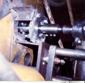

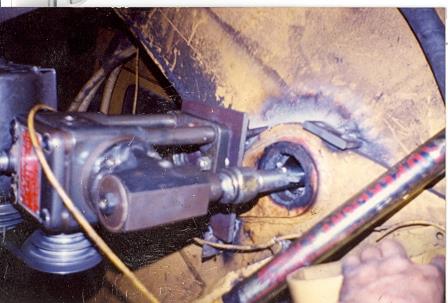

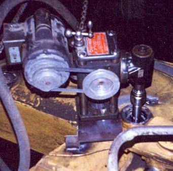

    Some have asked me about my avatar, so I thought I'd share some of the jobs I used it on
    along with how I had to adapt some bits of scrap to be able to use it
    OK the boring bar and the adapter to fit the Versi-mill are home made as well
    home made mounts for line boring-scan0382c.jpg home made mounts for line boring-scan0733c.jpg
    If I can ever get around to recovering data from a dead hard drive I have about 10 more special tools that I made for the dumore

    Thanks Frank. I made my own (mag drill Powered) years a go. Did a lot of boring with it. Glad to see someone else doing this. Love your title??? at the bottom. Never tell me it can't be done! Been my motto for years. I'll figure it out one way or another.

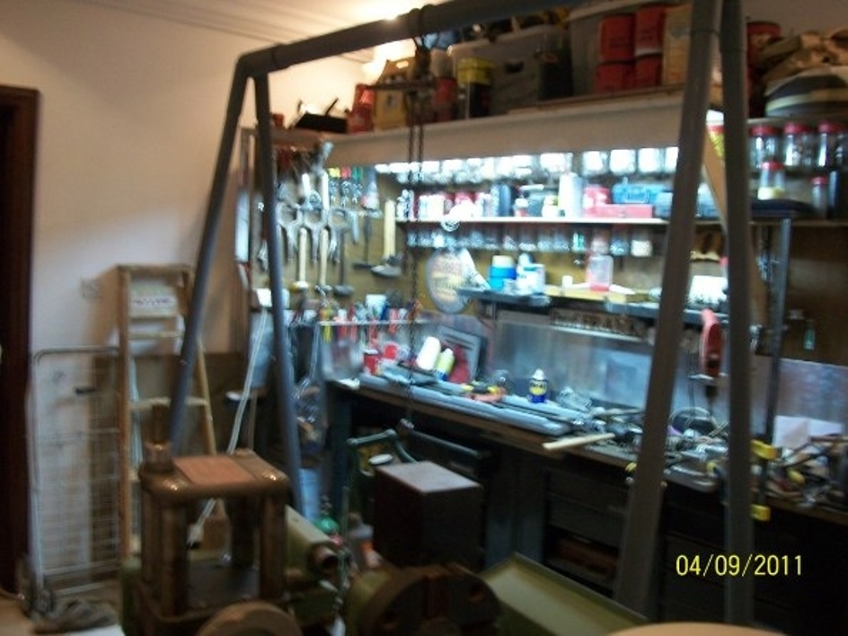

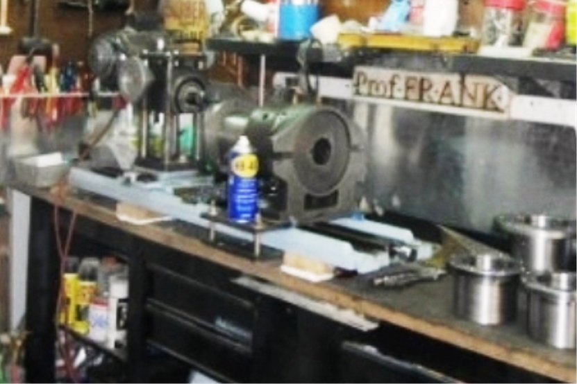

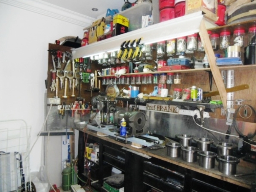

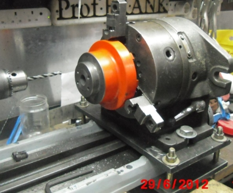

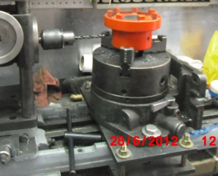

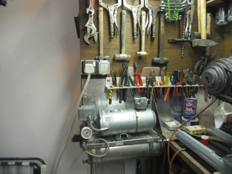

    it was the model (2) 3/4hp almost a 4 " vertical rise #3 MT with draw bolt.
    There was a 48" way bed for it 42" x and 4" Y travel Here are a few pictured with it in my home workshop I had set up in a spare bed room in my 3rd floor APT.
