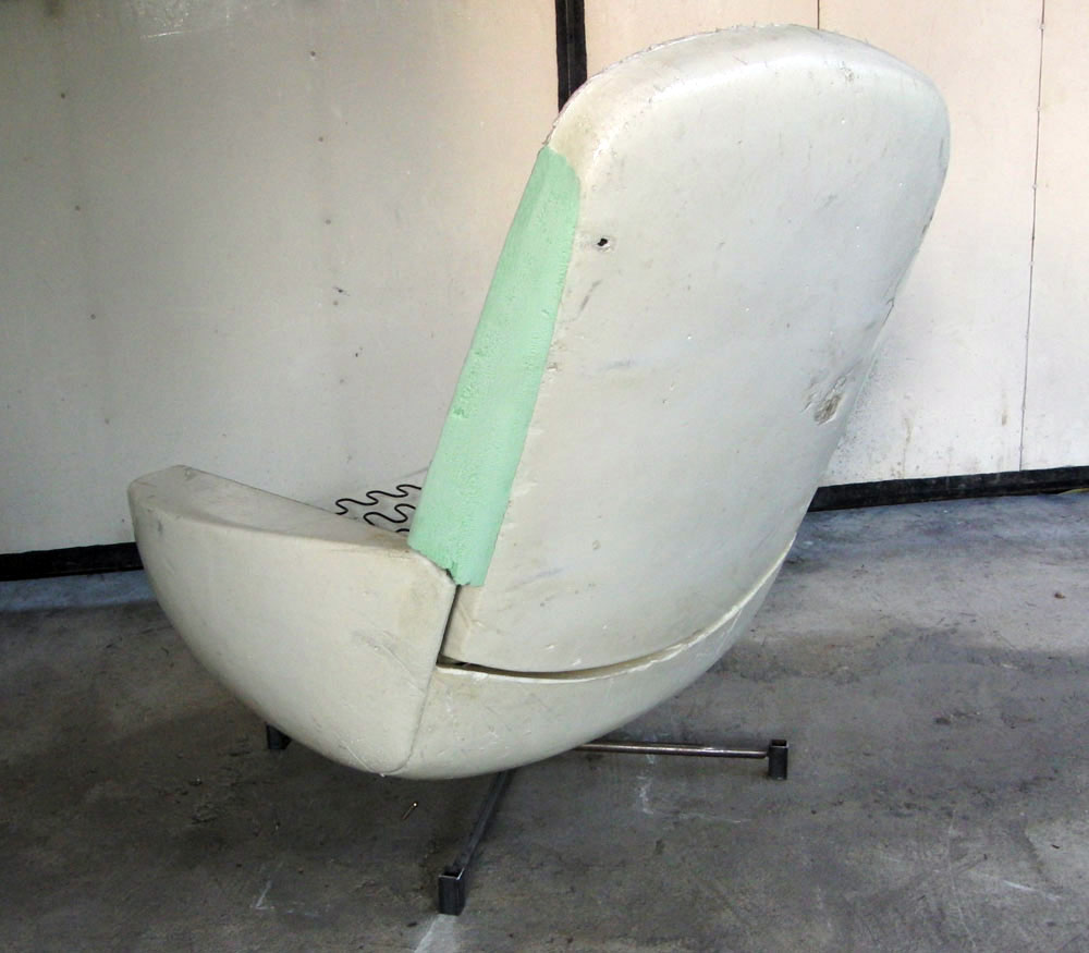

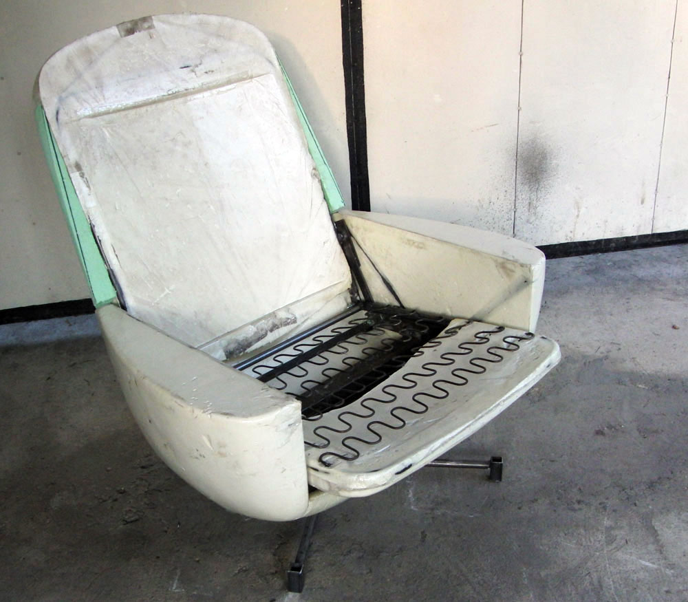

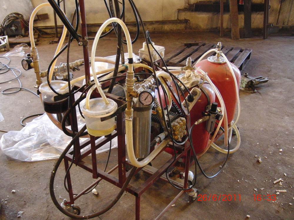

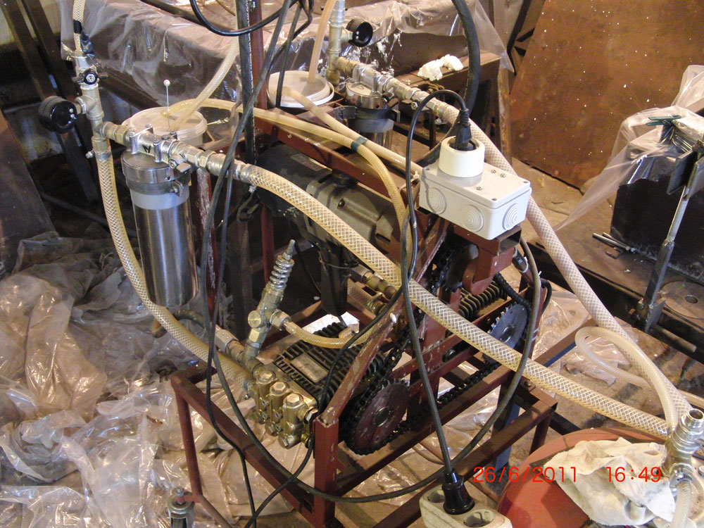

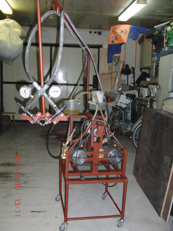

    Home made machine for mixing components and pouring foam polyurethane-ppu2.jpgHome made machine for mixing components and pouring foam polyurethane-ppu3.jpgHome made machine for mixing components and pouring foam polyurethane-ppu1.jpg

    Waste of time never see the final product, too bad, I was interested.

    Yes, you need to show the finished product

    I am interested in the output and if the gravity feed is sufficient (Bertolini pumps usually need a few psi at the input). I also see that no static mixer were used...I wouldn't have thought so.

    At the entrance to the pump 1.5 atmospheres
    Corrosion was only in the mixer, in one (Poly) of two nozzles (from the truck), the needle valve rusted, it changed every 2-3 months.
    No more has been replaced in the system.
    The system works 8 years. The system was turned on every 2 weeks. All this time, the system was charged with Iso and Poly components.
    Google translation
