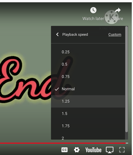

    do like I do speed up the video so they talk faster then is some point if interest pops up slow it down

    Frank, How do you speed up the video?
