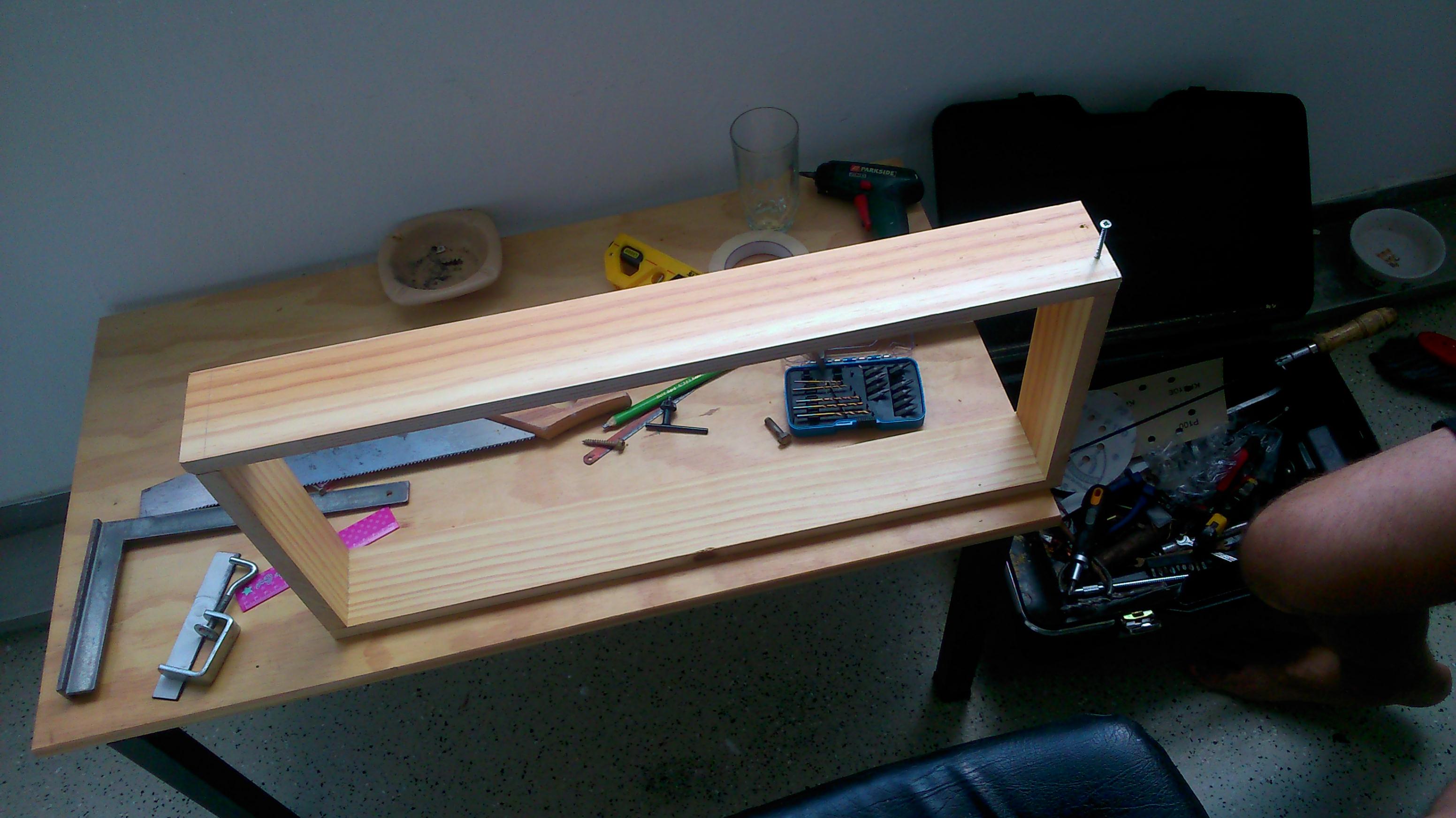

    I will show in a few pictures a project made last Saturday with my cousin.

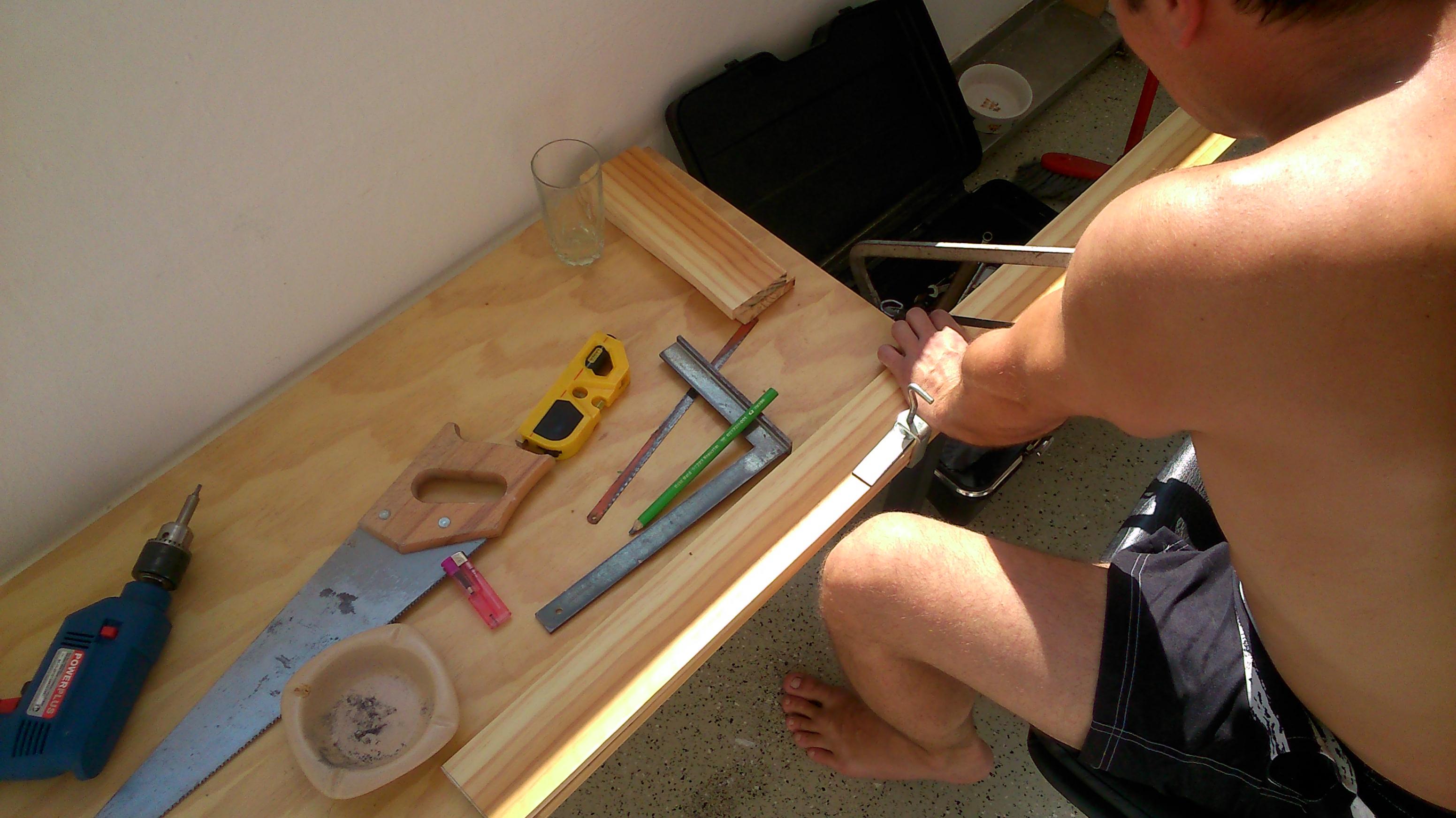

    Because currently we live in an apartment and not have a garage, backyard or something that will keep us away from boredom, we decided to build a hanger from a scrap wood with a scrap tool (only electric cheap drill, hand saw for steel and some screwdrivers).
    First we found in the basement some moldings and cut it to the desired length.

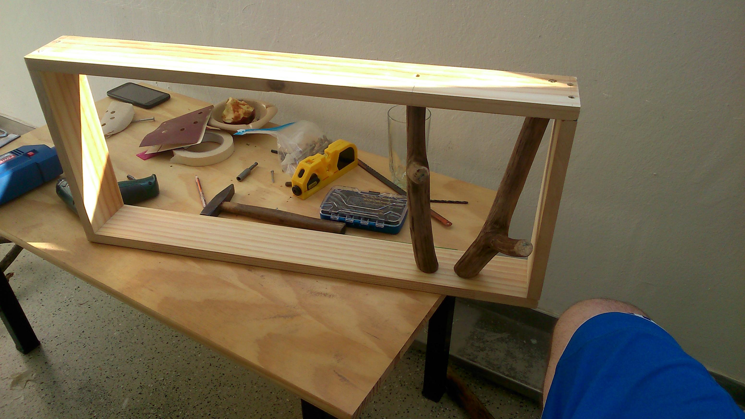

    Then drilled holes and screwed the frame.

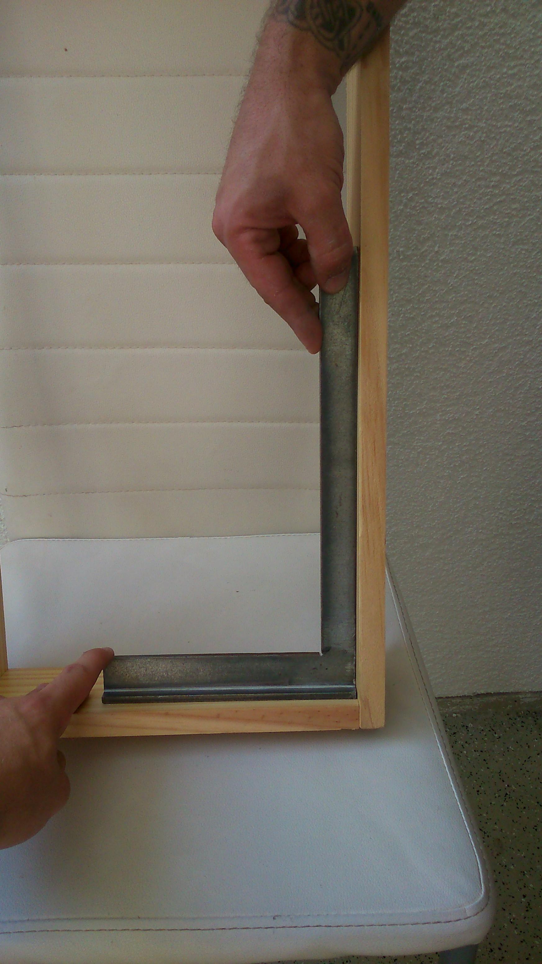

    Just to show that when using only hand tools you can get almost square

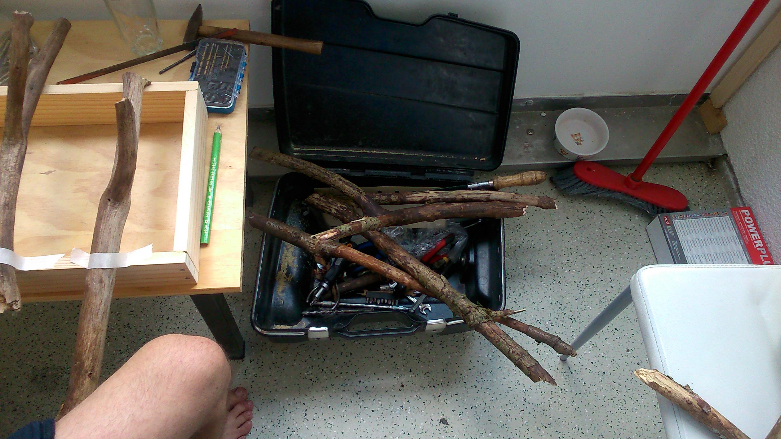

    Then we went to nearby forest and grab some good looking branches.

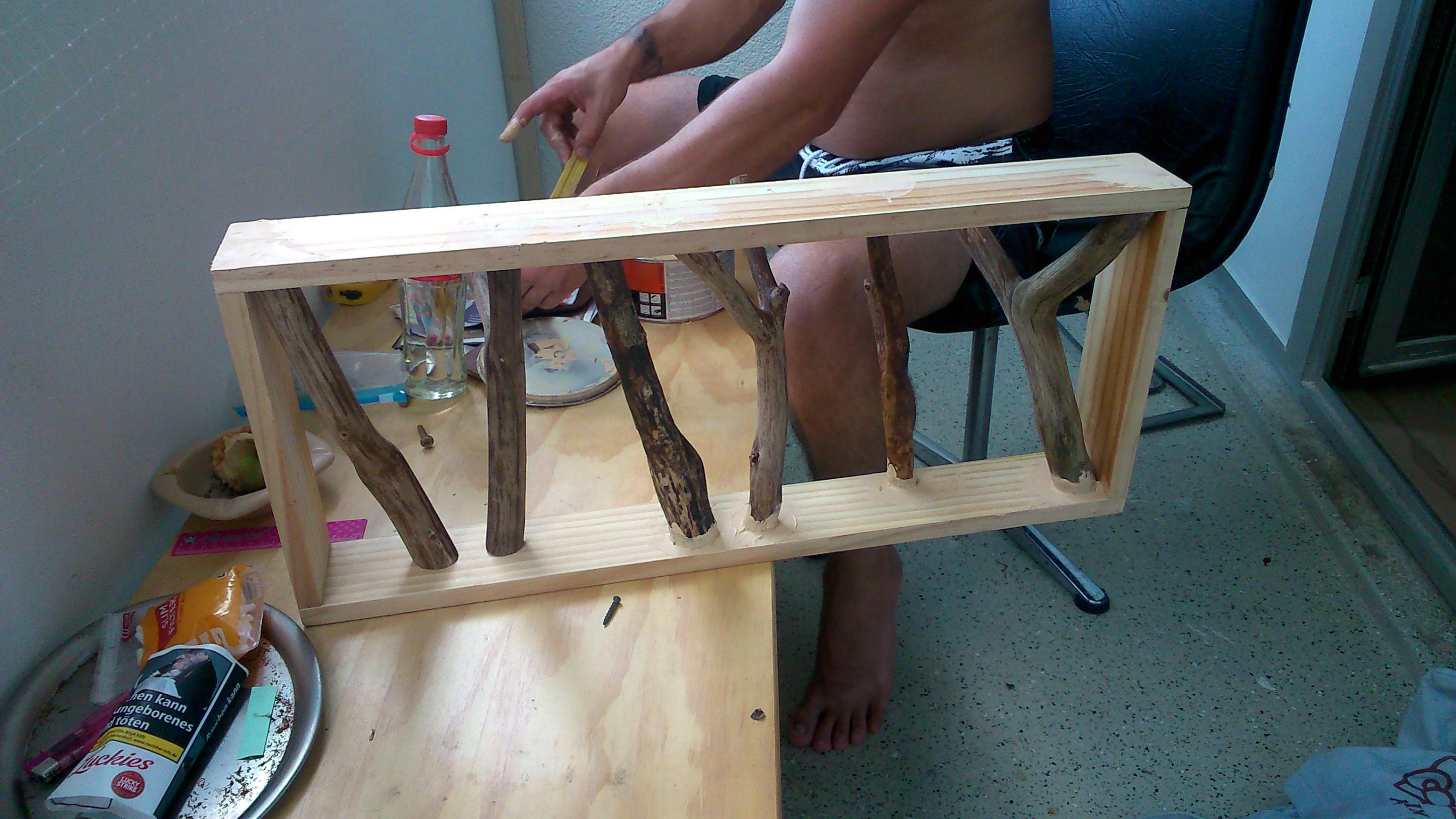

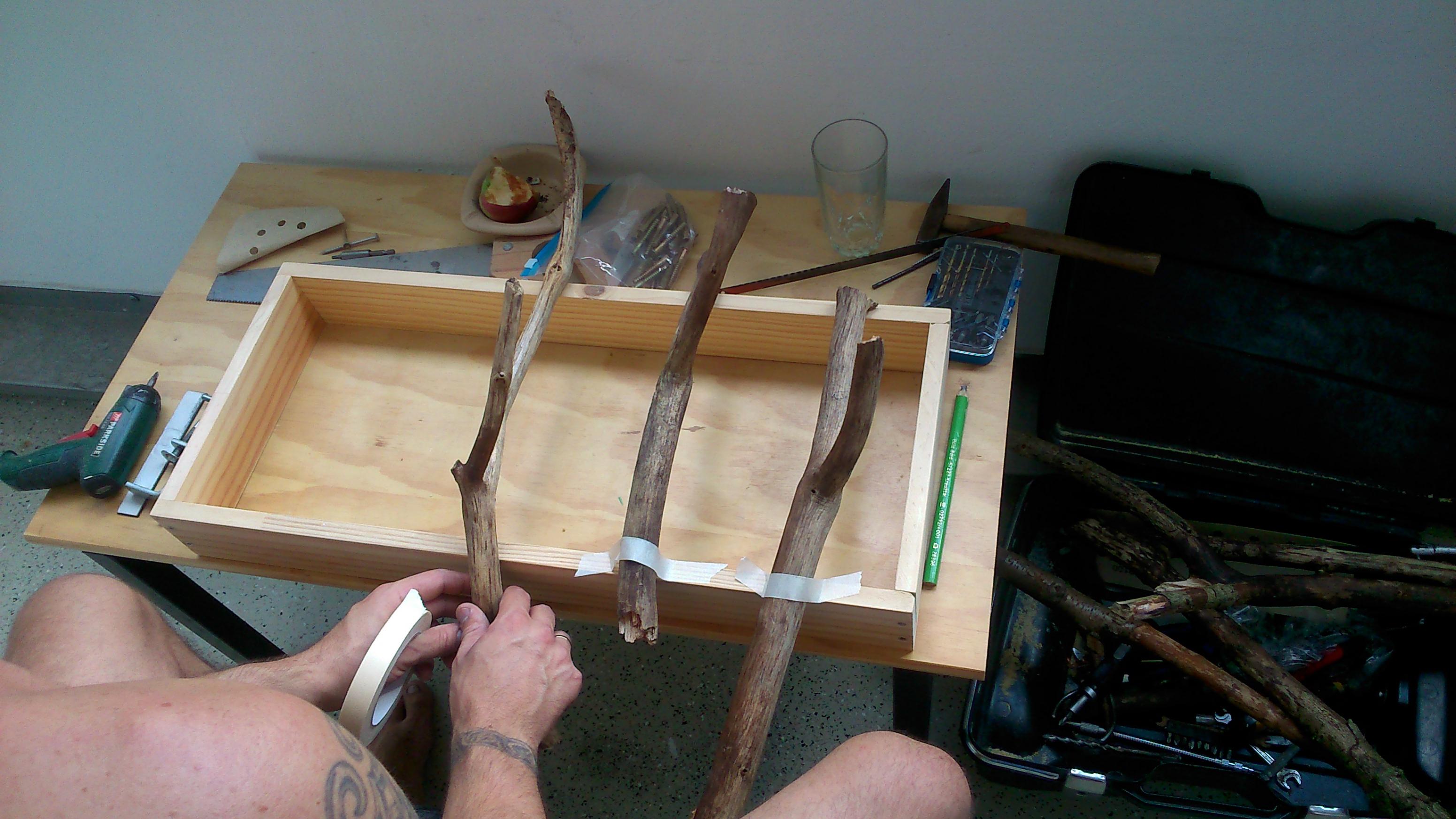

    Planning on its look and screwing branches to the frame:

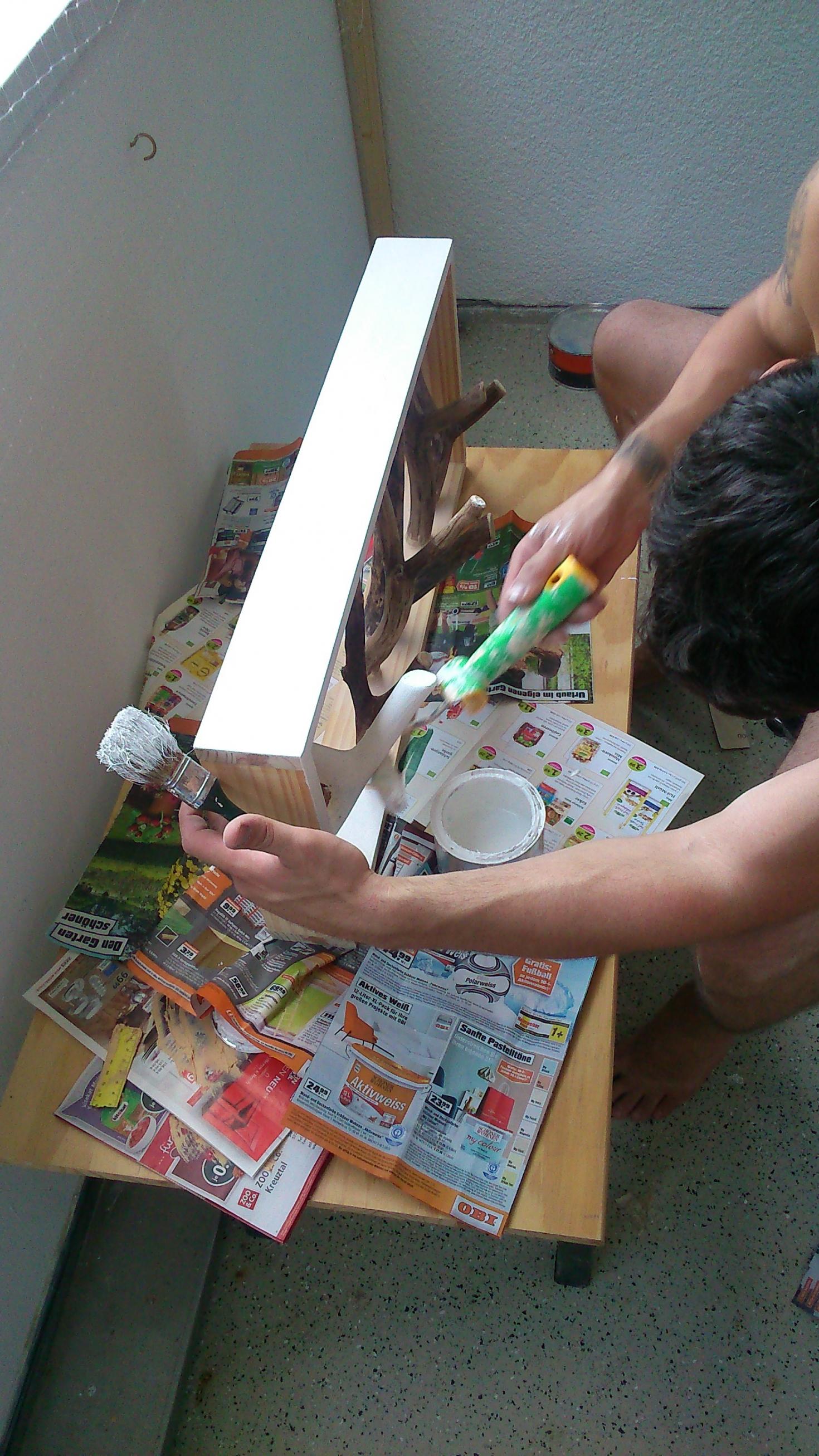

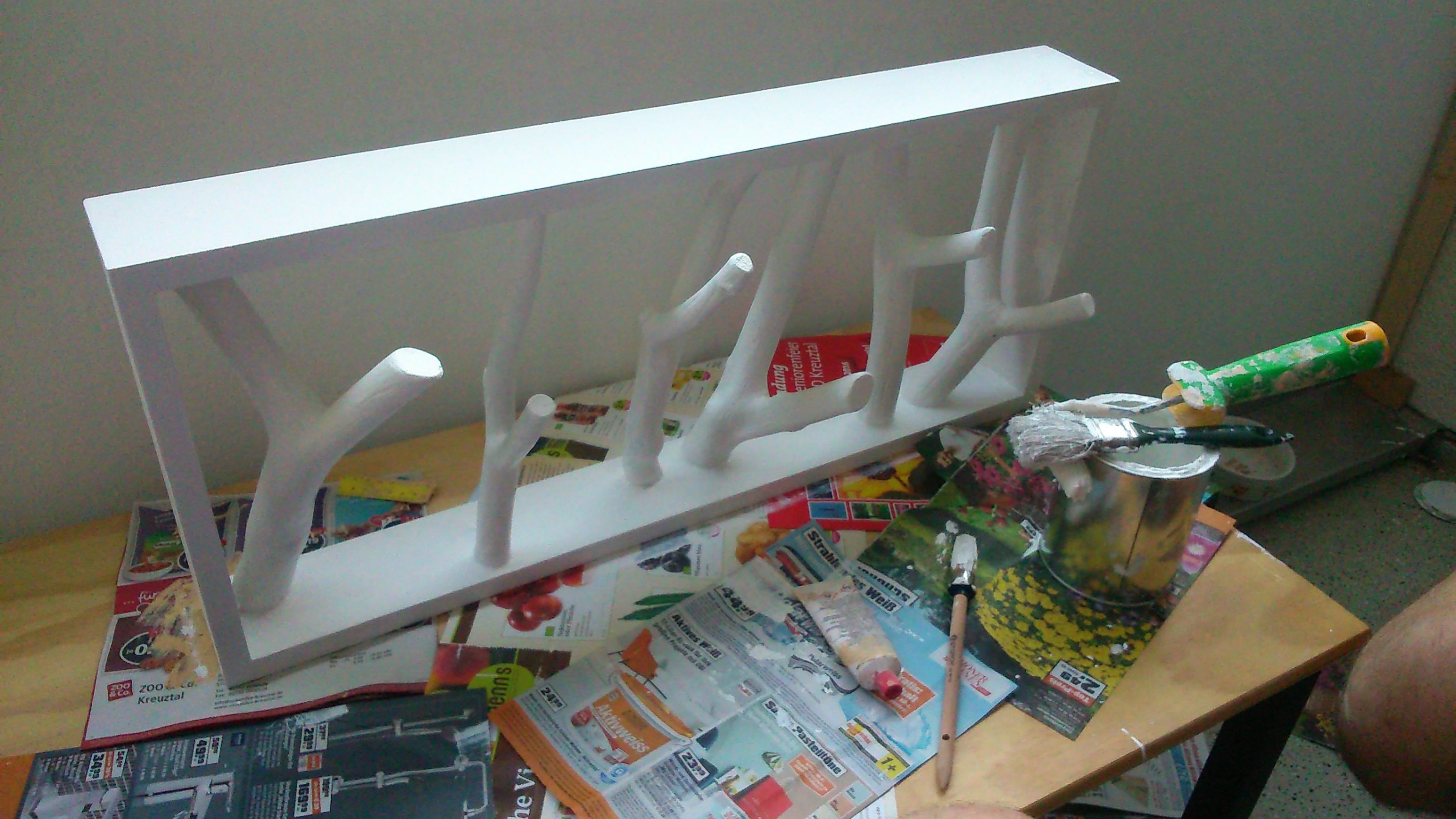

    Here we are adding some filler to hide holes from cutting the branches, because its impossible to cut it on the right angle to fit into the frame.
    After some grinding of the filler the paint came then.

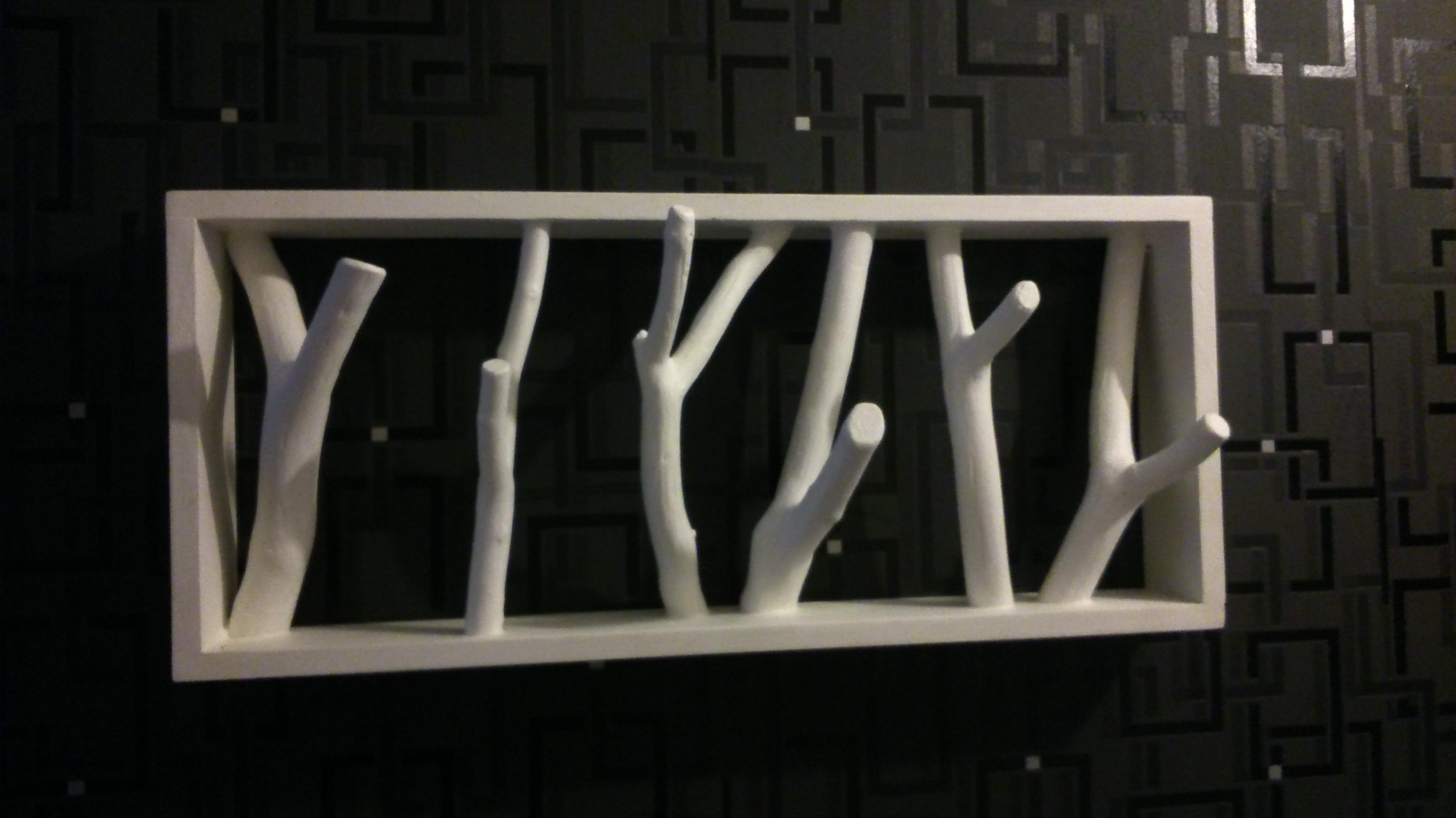

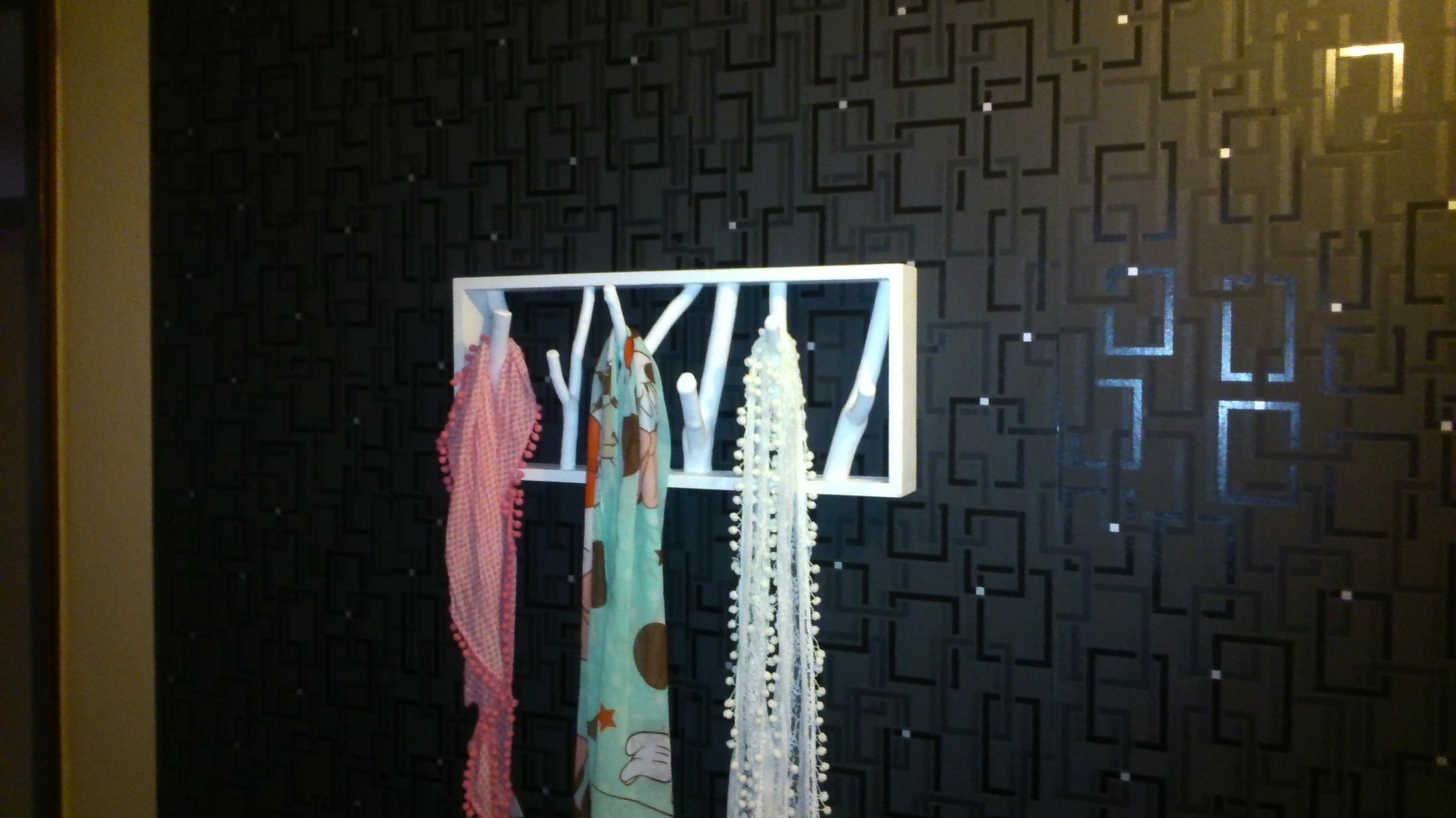

    And the final product screwed on the wall.
    For this small project we spent about 4 hours of hot and boring Saturday. Everybody liked are work, so we have some orders, only in different colors
