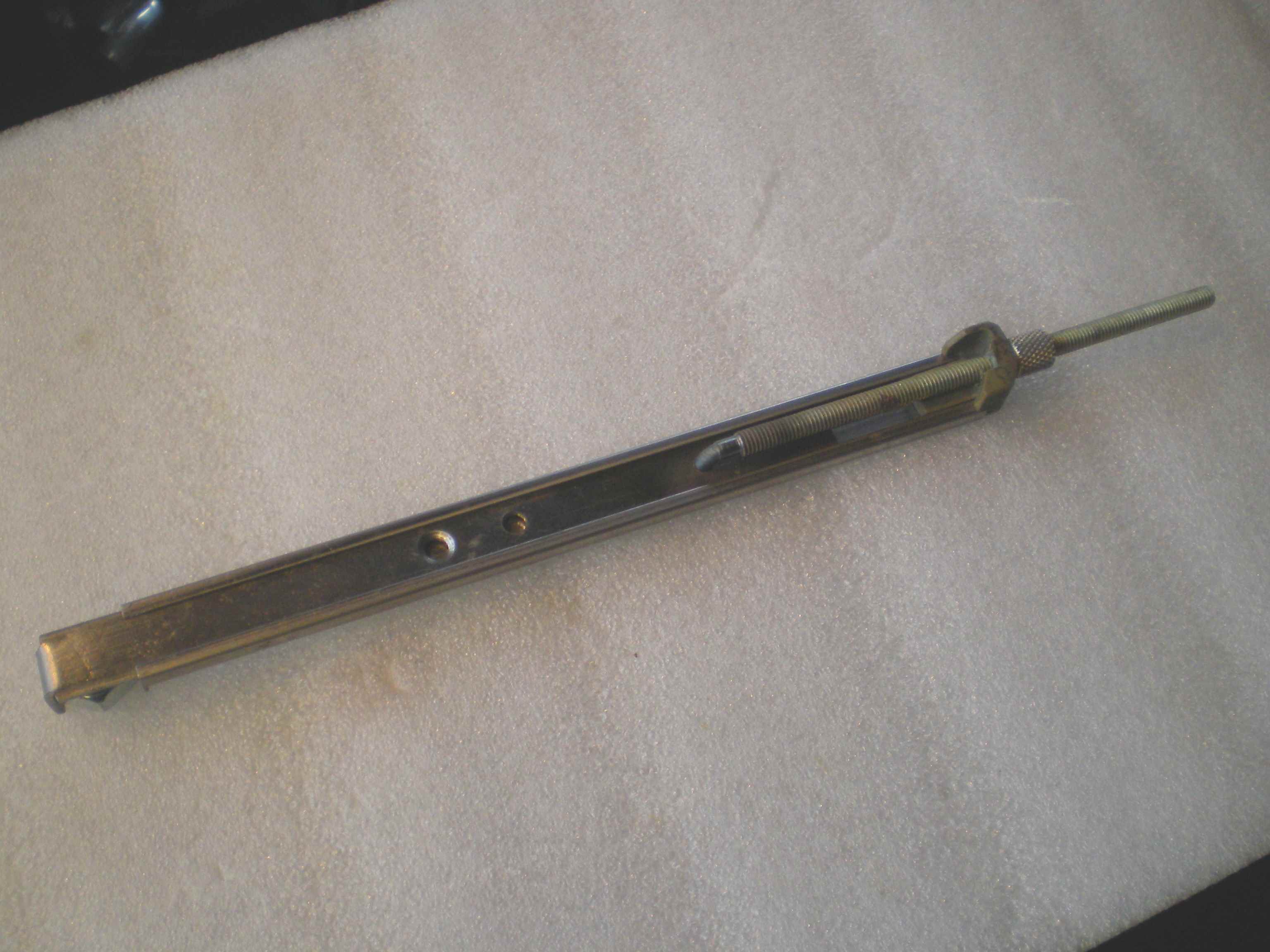

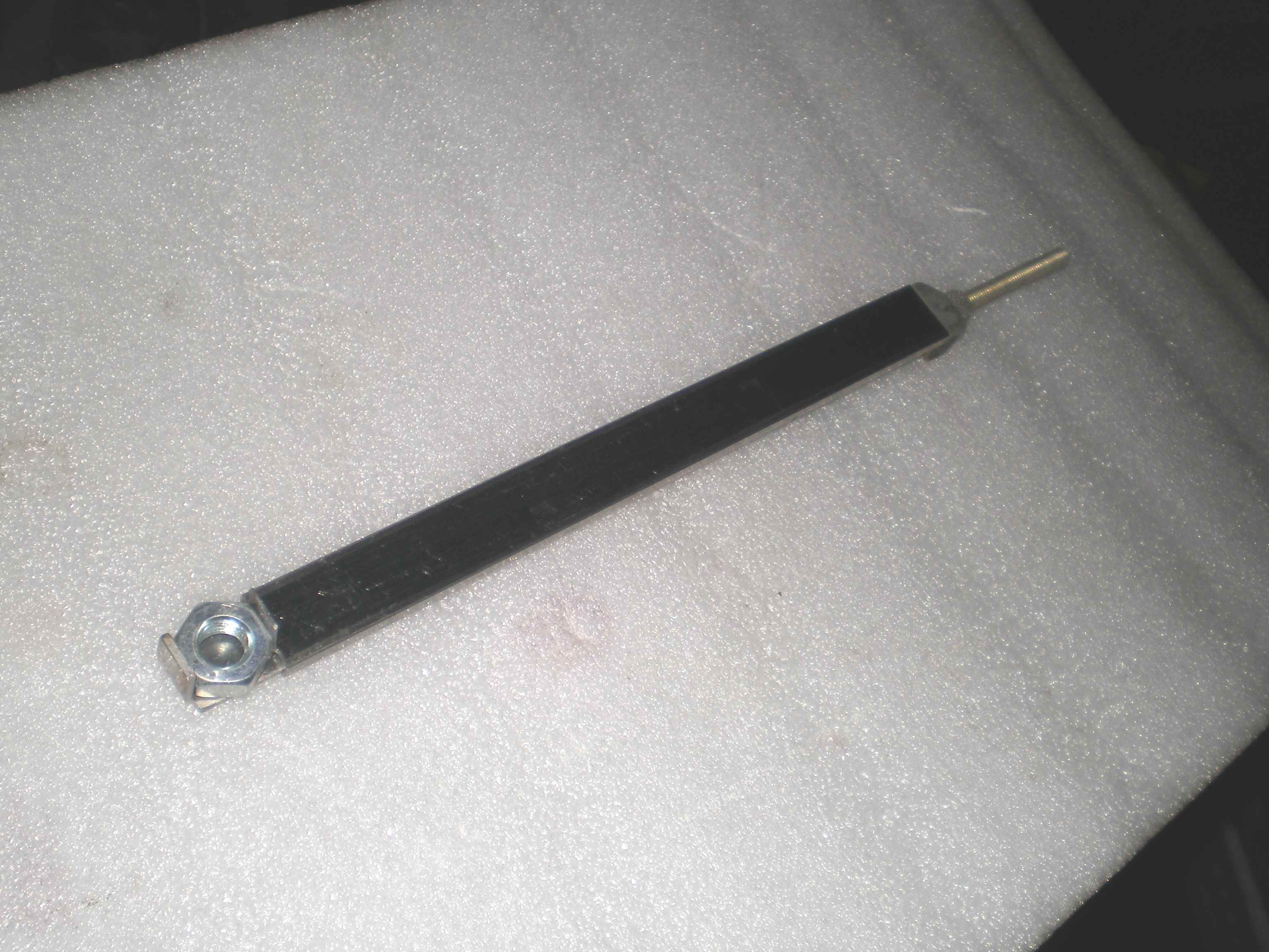

    This is made almost entirely from an old uPVC window hinge and a piece of all thread.
    Took about 1 hour to make, its not pretty but it works, cost me nothing and its only going to get chucked into my toolbox.

    That's great, the first of many I am sure.
    I will even make one eventually, it certainly seems handy!!

    saw this the other day and said that has to go to the bottom of my todo list, then today I needed it for hold a nut to mount under my luggage rack that is close to the body on my buggy. would have saved cramped fingers. although a long nose vice grip plier would have worked but it was late and I was not thinking to good.
    Yardstick + double-sided carpet tape

    If you don't have carpet tape on hand, wind duct tape onto the stick with the sticky side outward. Keeping carpet tape around is a good idea though; I've machined small parts by attaching them to a faceplate with the stuff.
    If carpet tape is too aggressive in the nut-holding scenario simply stick a magnet on the tape and hold the nut with the magnet.
    Wooden paint stirrers, often given away at paint stores, can substitute for the yardstick if one only needs a shorter reach.

    Great idea! Thanks for the share. I've used a piece of flat metal with a hobby magnet or a piece of wood with double sided tape.

    Using yard sticks , paint stirs and soda straws with sticky tape is a great quick fix solution to a seldom encountered problem, that often times hardly warrants buying or making a more permanent tool.
    Not exactly the same thing but back when I was modifying D10 caterpillar blades I had to make several cuts as far as 5 ft deep inside of the blade to do this I clamped the torch handle to a broom handle then screwed an eyelet into the wood and tied a small cable to the cut lever then through the eyelet back to where I could pull on the cable to depress the lever worked great and I didn't have to spend over $1000.00 for a specialized demolition torch like those used by scrapers at the metal recycling places.
