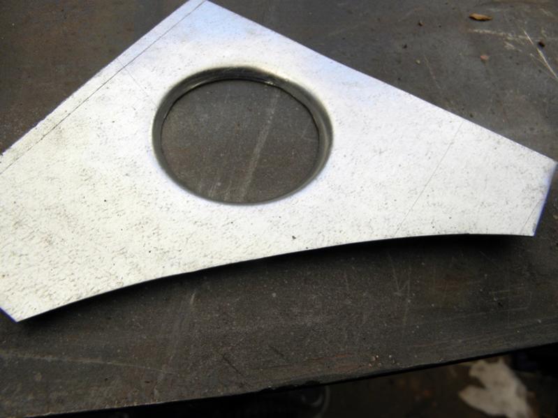

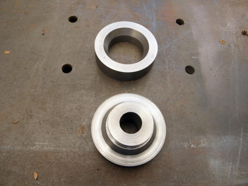

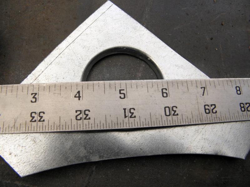

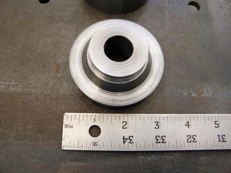

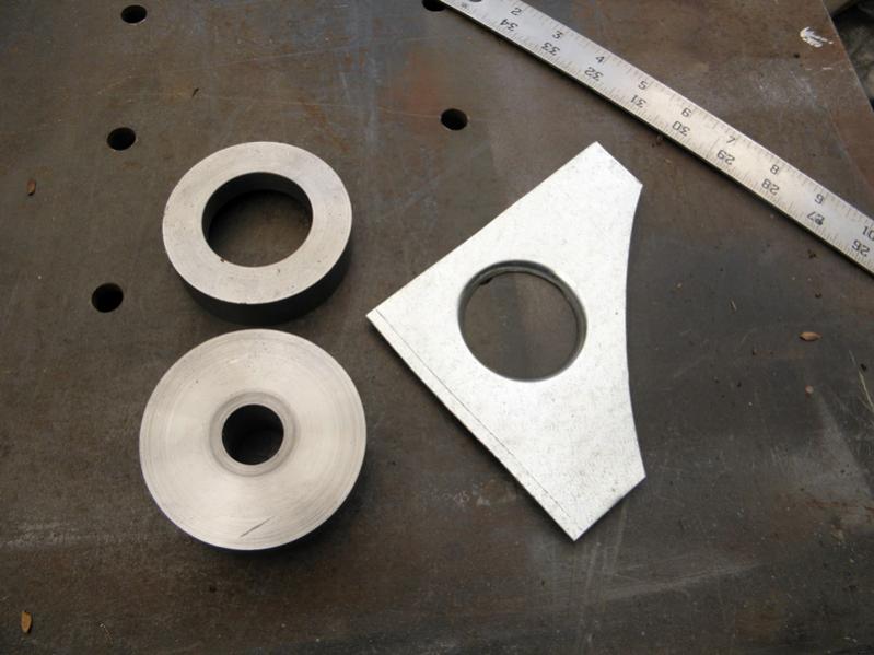

    Home made Dimple die Size 1 " 9/16 Hole. Made from CRS on the Lathe. to be used on the shop press.
    Can also be used with hydraulic hand pump type press.
