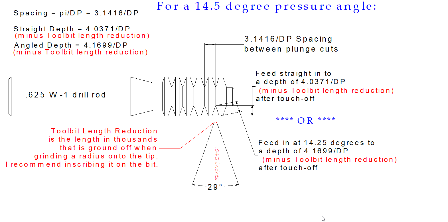

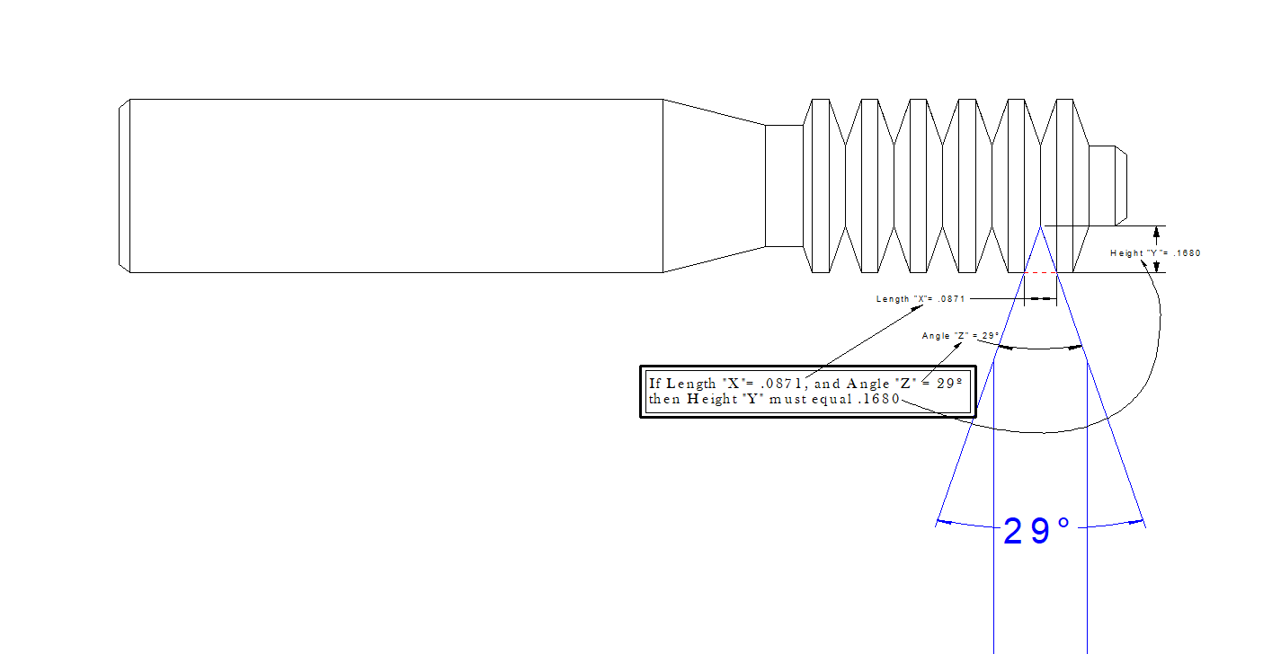

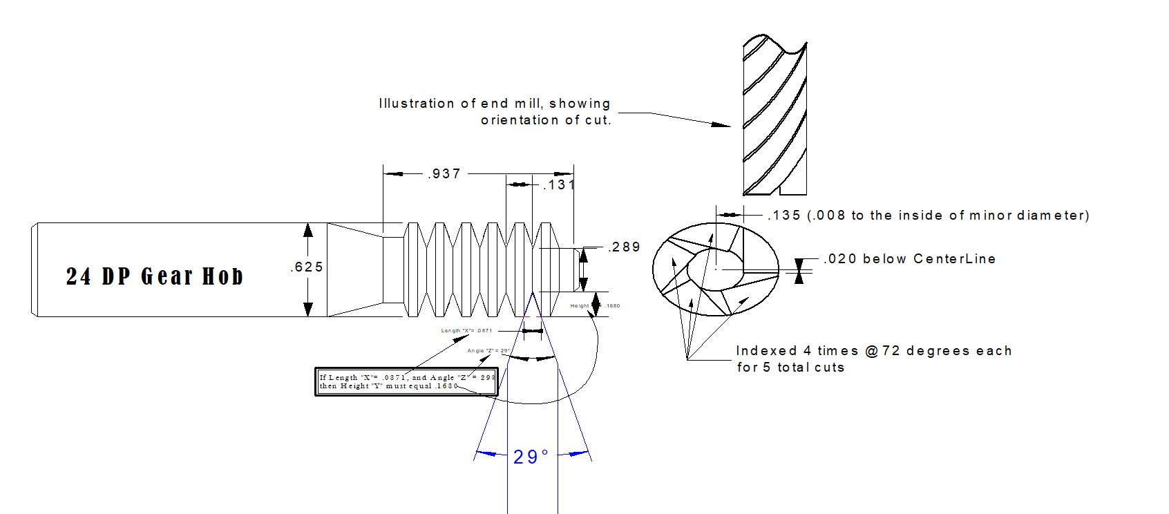

    Home Made change gears for 6 inch lathe
    Part 1 of 2:
    Shows the theory and process of creating a gearcutting hob
    Part 2 of 2:
    Shows the final cutting and testing of the gears
