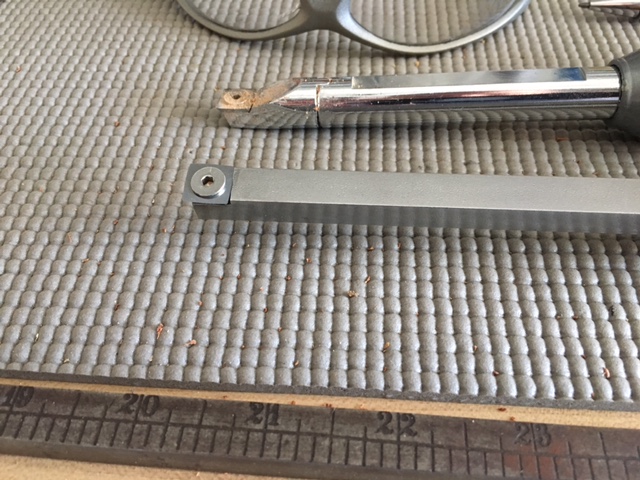

    I set out to make a Carbide Wood Lathe Tool better than the one I purchased. Photo contains the purchased item on top and home made tool on bottom.

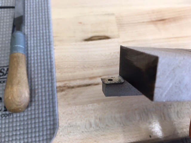

    Drilling, Tapping and Grinding SS Bar
    Attaching Carbide Insert

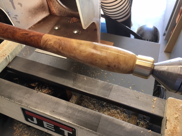

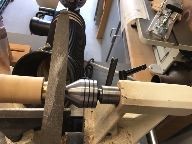

    Turning Handle front for Brass Nut

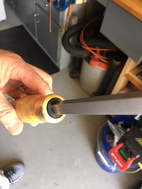

    Inserting Shaft into Handle
    Completed Tool
