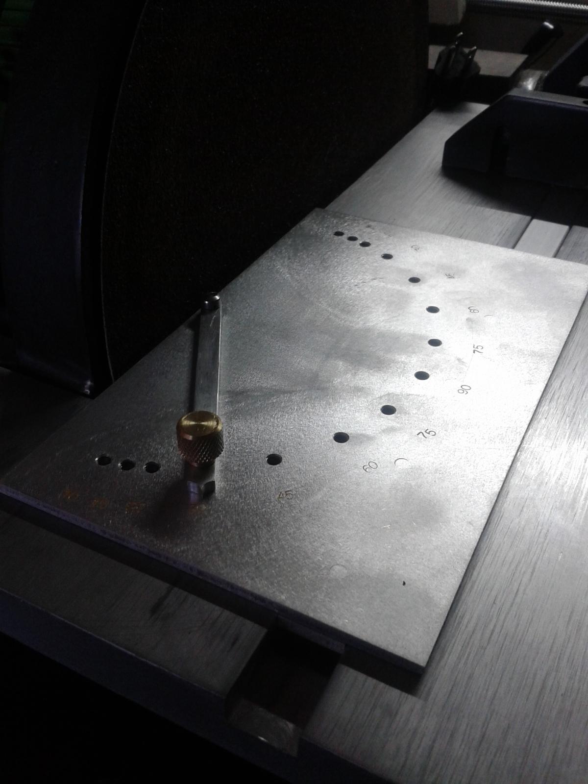

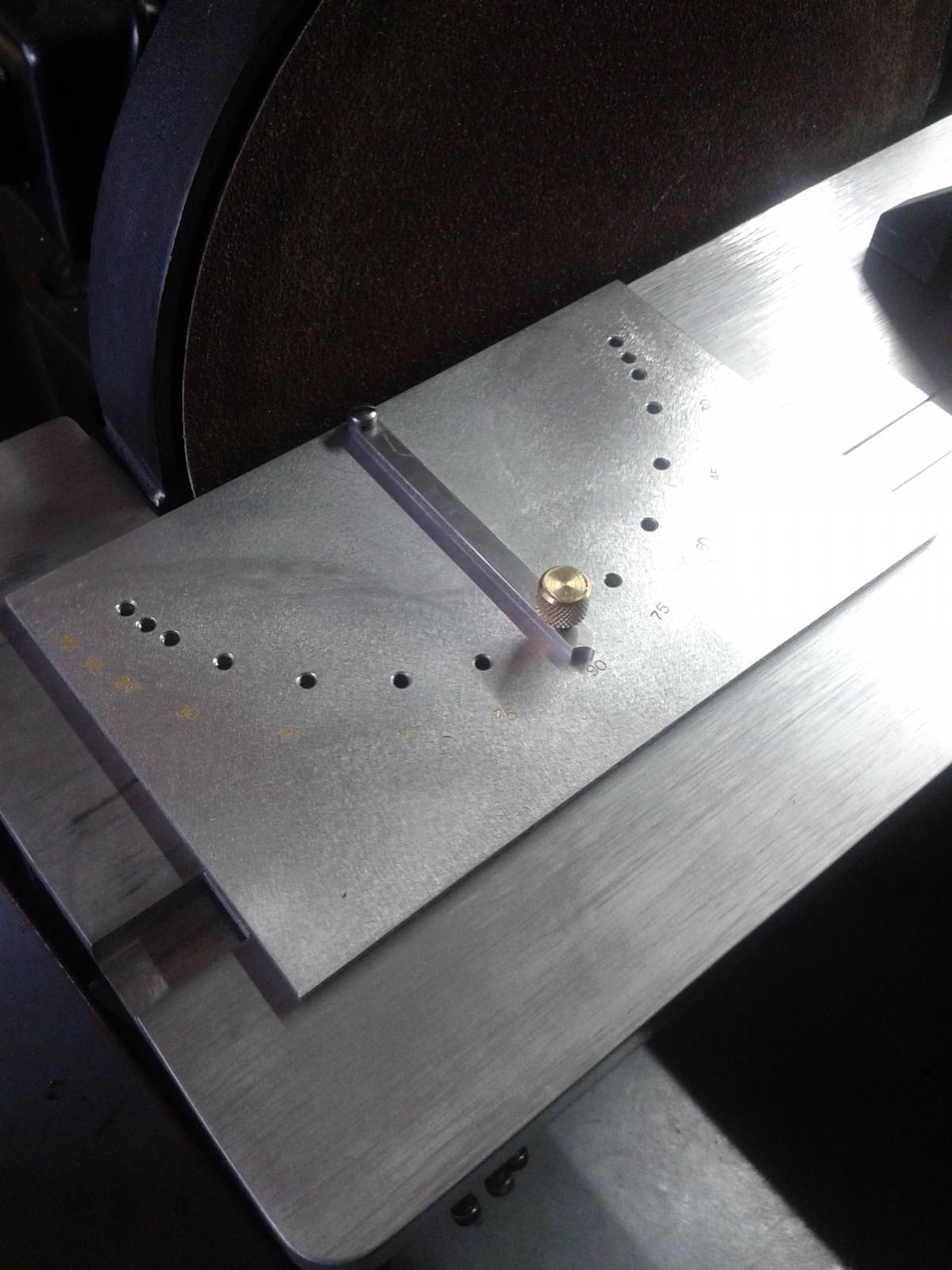

    I made this angle plate for my 12in disk sander so I could grind accurate tool bits for my lathe.

    I agree that a belt sander is nicer, to be honest, the variable sfpm isn't a concern but I would rather have a belt sander but all I have is the disk sander, I also have a bench grinder but the important thing here is even with a belt sander as long as you have a table with a slot which most belt sanders do then you could make an angle plate for it the same way.

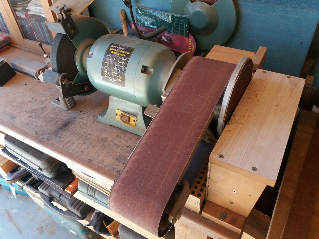

    Hi guys, my 2c...Disc sanders are more traditionally used in woodworking, whereas belt sanders are used for metalworking. Advantages and disadvantages of both types in both mediums. strip type belt sanders, 1-2' belts are pretty useless for the typical edge sanding you might do with wood, as the wood pieces are generally largish. The 12' disc sander with wood is easy and safe to use and easy to not oversand. I have a 12' disc I put in the table saw, which allows me to use the mitre gauge. I also have an Abbott & Ashby 8" grinder with 36" x 4" belt and 7" disc, which gets used a LOT...but in saying all that, metal=belt, wood=disc; far more often than not...and don't scrimp on abrasives! Buy the best you can; they cut cleaner and last far longer. Cheers
