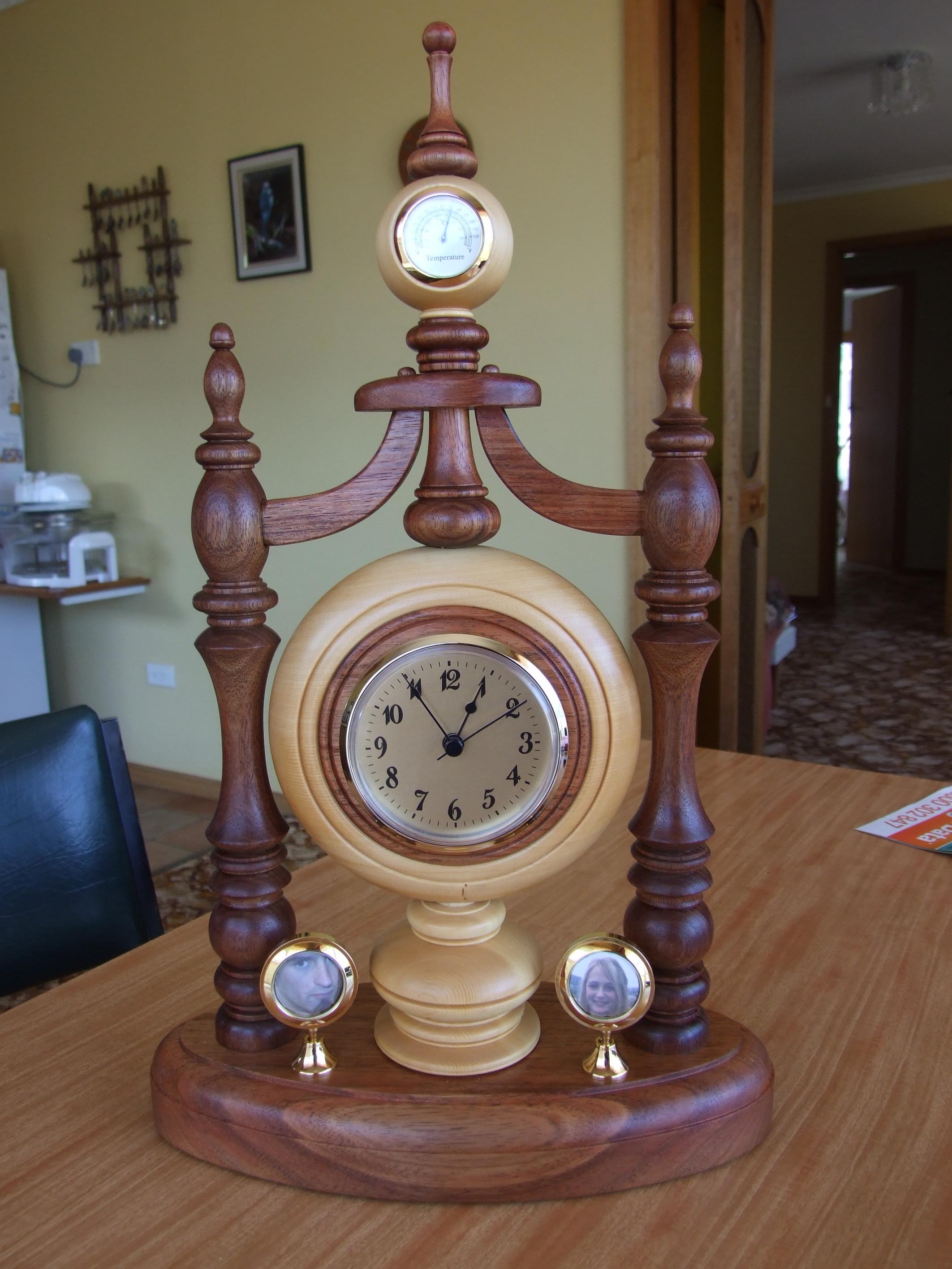

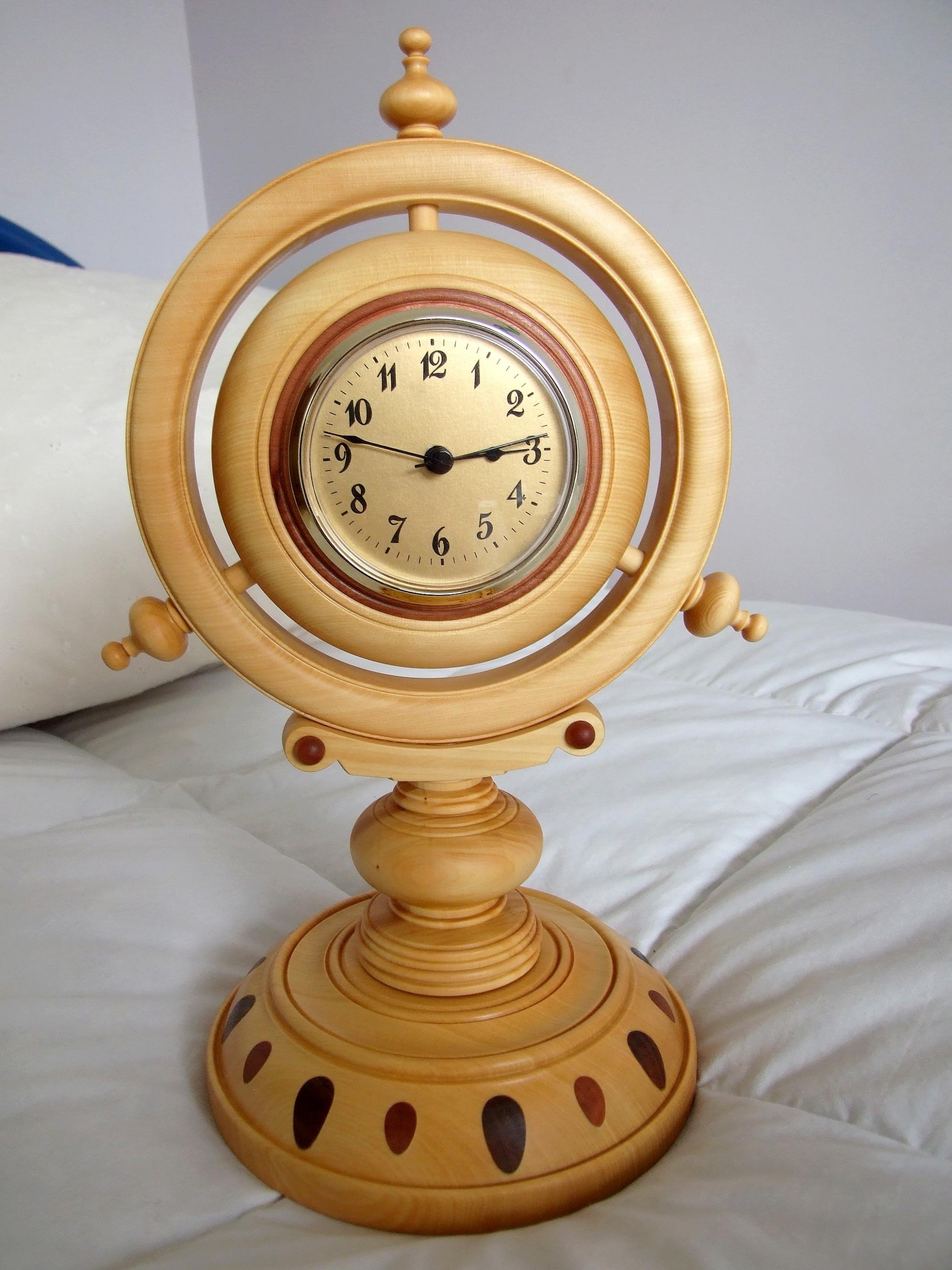

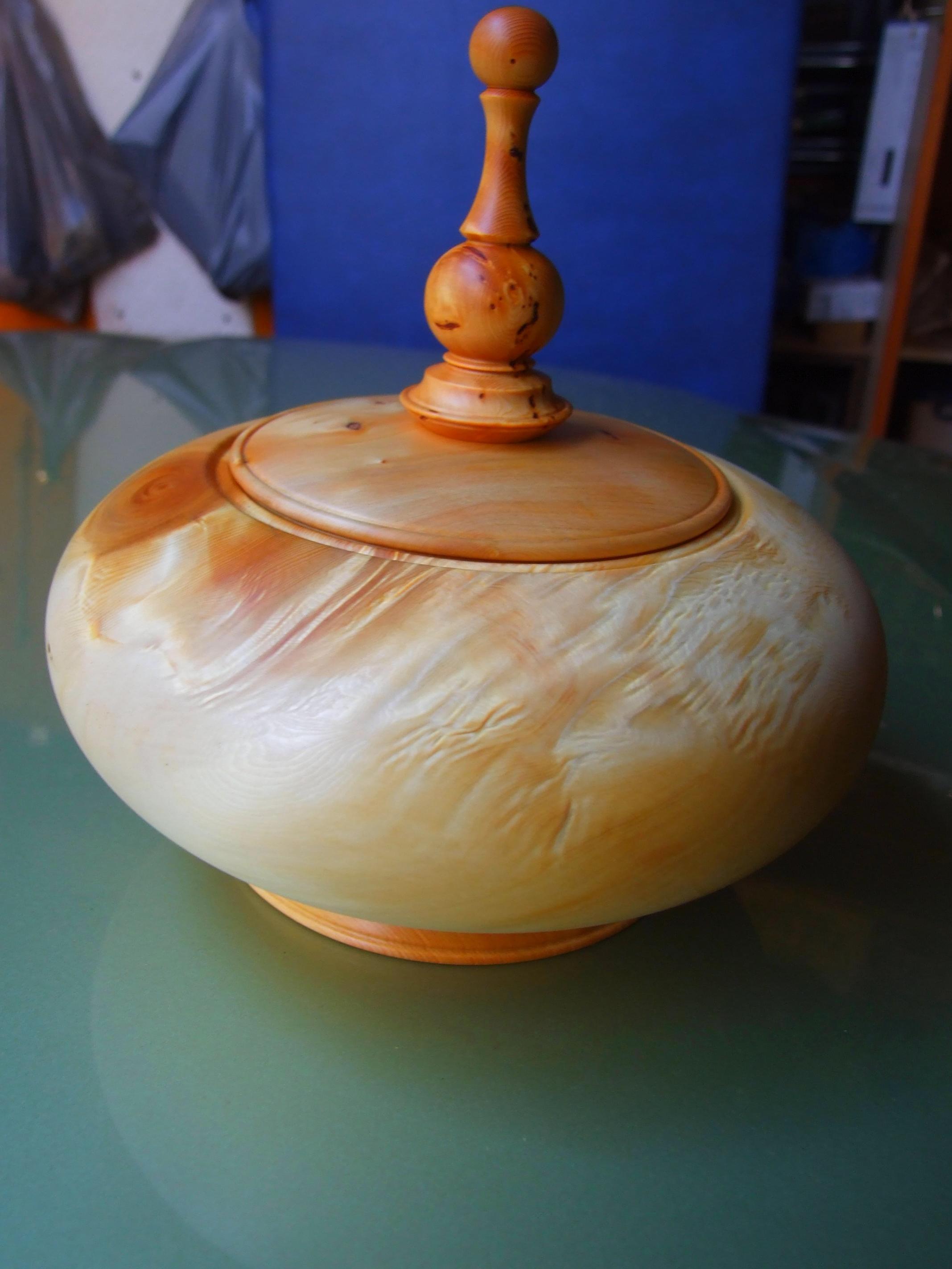

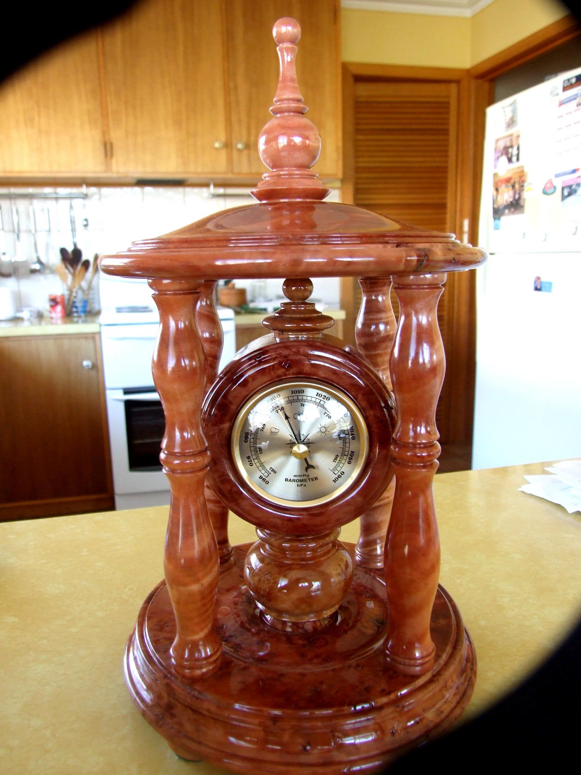

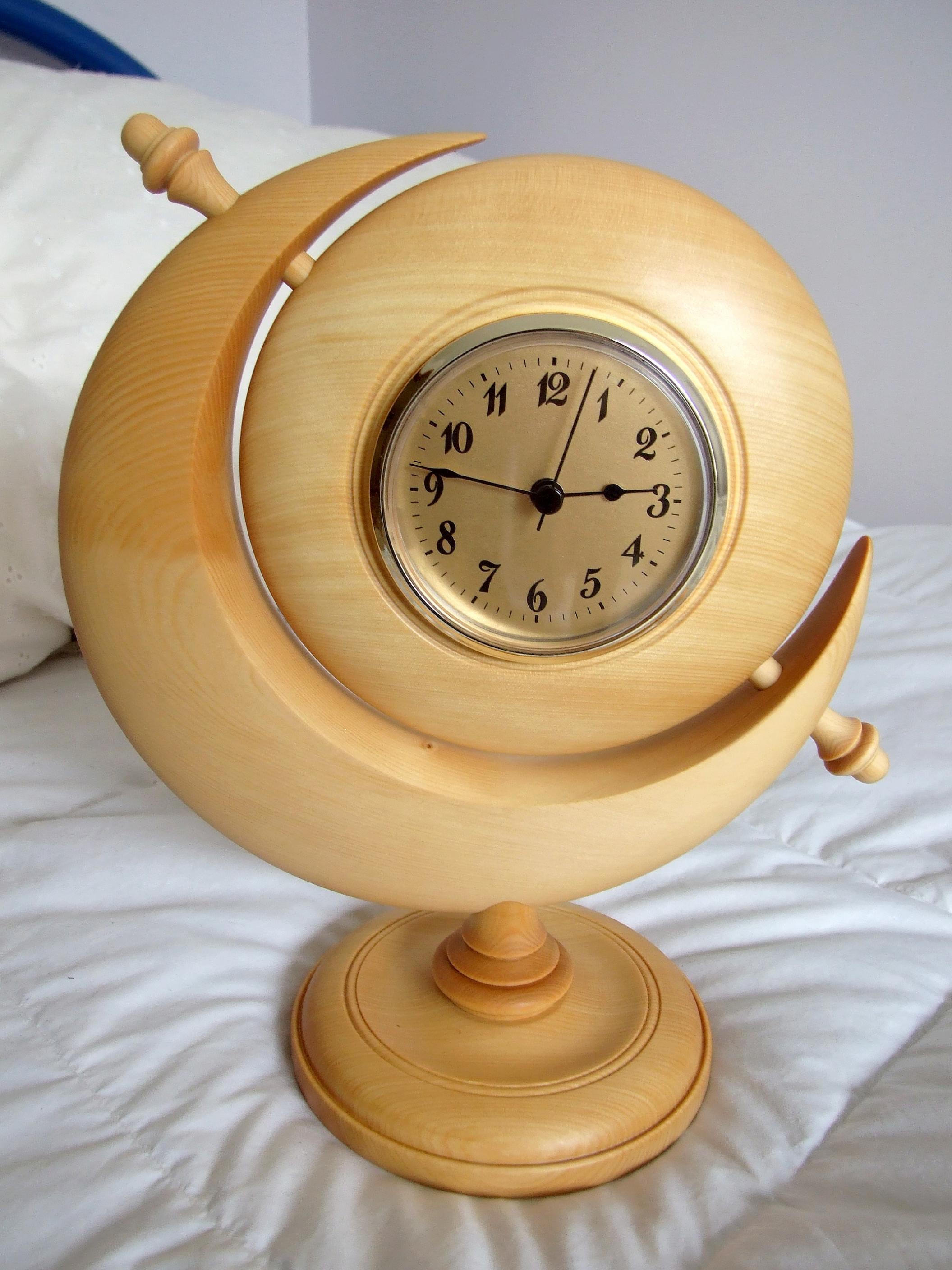

    Hi. The whole lathe is built from scratch. Spindle is made from 2" bright steel & thread size is 1 1/2" 6 TPI wit thread to take metal lathe chucks if I need to use one. I lived in Smithton far North west Tasmania at the time & I had access to big metal lathes at a steel fabrication place there & was able to turn the shaft & cut the threads & put no 2 morse tapers in the ends of the shaft. The lathe was built quite heavy as I have two smaller lathes & both vibrate far to much for what I wanted to do on them. I am getting to old now to stand for long , so my grand son & son in law are going to take them to Victoria Main land Aust. My son inlaw is an artist & sculptor I think he will come up with so good looking work from the lathes. A few lessons coming up there But he is a quick learner. I have turned cradles, Rocking chairs,& quite a lot of bigger pieces that are a bit to big to put up on here.
