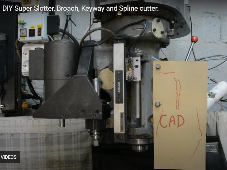

    That explains why I do not do CAD, well just one reason anyway. That is not quite true, I do have my own CAD system which is outlined in detail at
    Slotter or broach driver. Cardboard Assisted Design.
    Attachment 46702
    I also sometimes use your cardboard version of CAD.

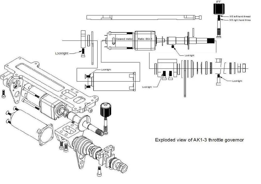

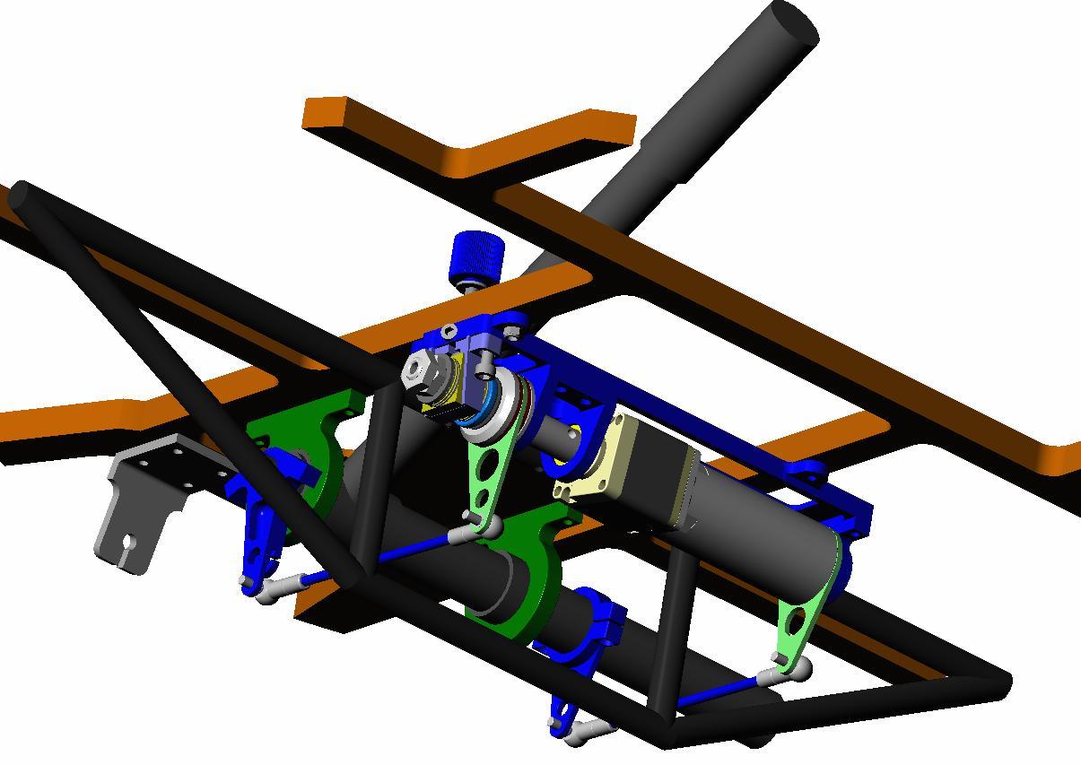

    But, after reading an article in a Kit Planes magazine some 10 years ago, written by an old toolmaker who claimed to have tried 20 odd CAD systems and always battled with it, until he came across Alibre Design which he described as intuitive and simple to learn, I decided to have a go. So I downloaded a 30 day free trial of Alibre design professional and I taught myself basic CAD literally in one day, it was really that simple, and by the end of the 30 day period I had designed the mechanics for a helicopter throttle governor system for my Ukrainian AK1-3 helicopter. I engaged a electronics engineer to handle the electronic control side as I'm useless at that, and made a number of retrofit governor systems for other pilots after obtaining approval from the helicopter manufacturer. After a month I already felt like very confident and fluent with CAD.
    I later switched to Fusion 360 which was very similar and easy to transition to, and less costly for a retired hobbyist.
    I am so glad I put in that one days effort to learn CAD, as it is now so simple to design and build the 3-D parts, then assemble them into a working project. It is easy to make changes to parts and assemblies that it encourages design experimentation of different concept ideas before choosing the best one to make.
    The best part is once you have checked your assembly and make sure the movable parts function and don't interfere with one another, there are virtually no errors after construction is done and everything fits together just right.
    I get as much pleasure creating using the CAD as I do actually making the parts. You should give it a try Tony, you won't be sorry.
    I don't have shares or any interest in either of these CAD packages so no hard sell here.

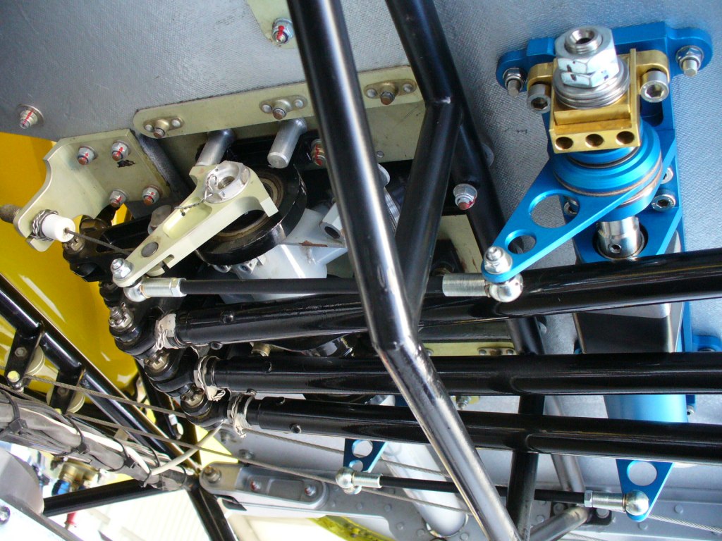

    Here is that Alibre CAD governor design after using the program a month and not full time. Also a photo of that governor design mounted to a helicopter.
    Home built universal grinder-design-governor-instalation-clutch-adjuster.jpg Home built universal grinder-governor-installed.jpg Home built universal grinder-ak1-3-governor-exploded-view.jpg

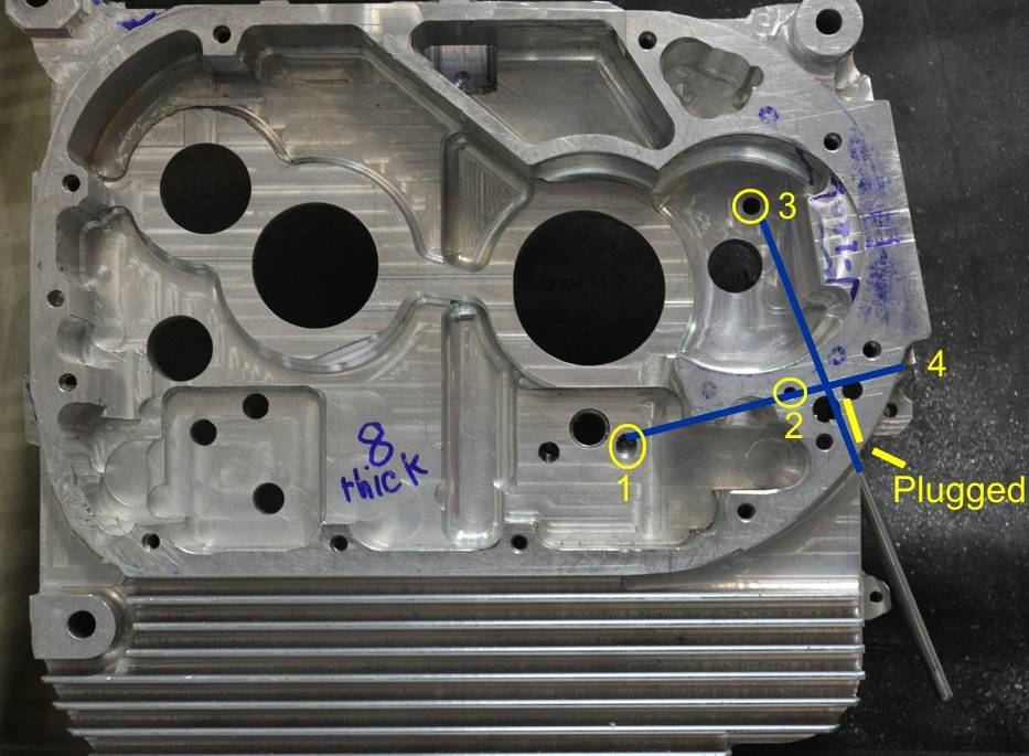

    I have a CNC Bridgeport and so you would think that CAD would be essential but my stuff is either 2 or 2.5D and for simple stuff I use the MDI interface, for not so simple stuff I hand write G-code and for more complex stuff I write dedicated software that outputs the G-code. Today for example I made what I hope will be an improved design of gun for my bead blaster. It required linear and circular interpolation, boring and thread milling. That was all done via MDI and the whole job was far quicker than if I had taken the CAD/CAM route. Here is a work-in-progress example that had some roughing done manually and the CNC work was from hand coded G-code.
