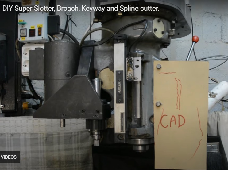

    That explains why I do not do CAD, well just one reason anyway. That is not quite true, I do have my own CAD system which is outlined in detail at
    Slotter or broach driver. Cardboard Assisted Design.

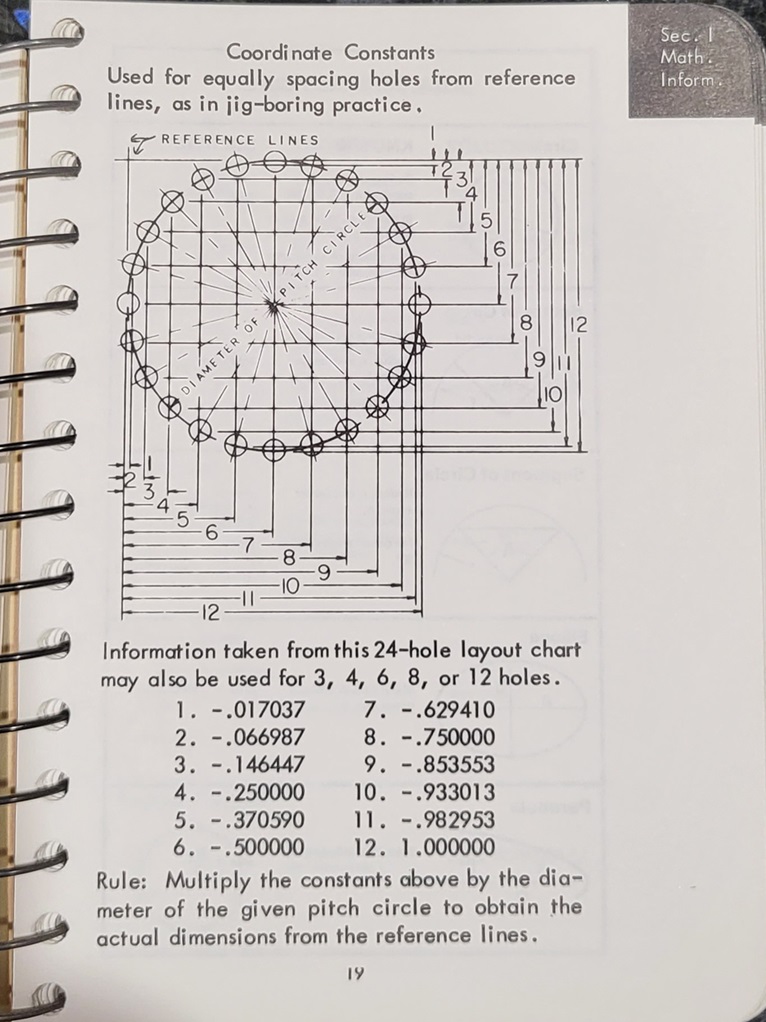

    Yep, it's still more fun, and faster to fab a one-off bolt circle using x,y table and coordinates on the drill press, holding it by hand, than . . . .
    Create CAD dwg (or write NC program), simulating (or checking) the NC file, loading tools, homing machine, mill soft jaws for vise (or use parallels and v-block or clamp to table), manually edge finding (or probing) the stock, set 25% feed rate on 1st pass, turn on coolant, run part, unload, wash down machine.
    Even when calculators got trig functions this was just as fast for a "normal" BC. Although, weird stuff got trigged out. Even "conversational" programing a BC on a CNC control or DRO is not as fast as by-hand on the drill press because of CNC machine set-up. Now lots of 10-20 each . . . different story!
