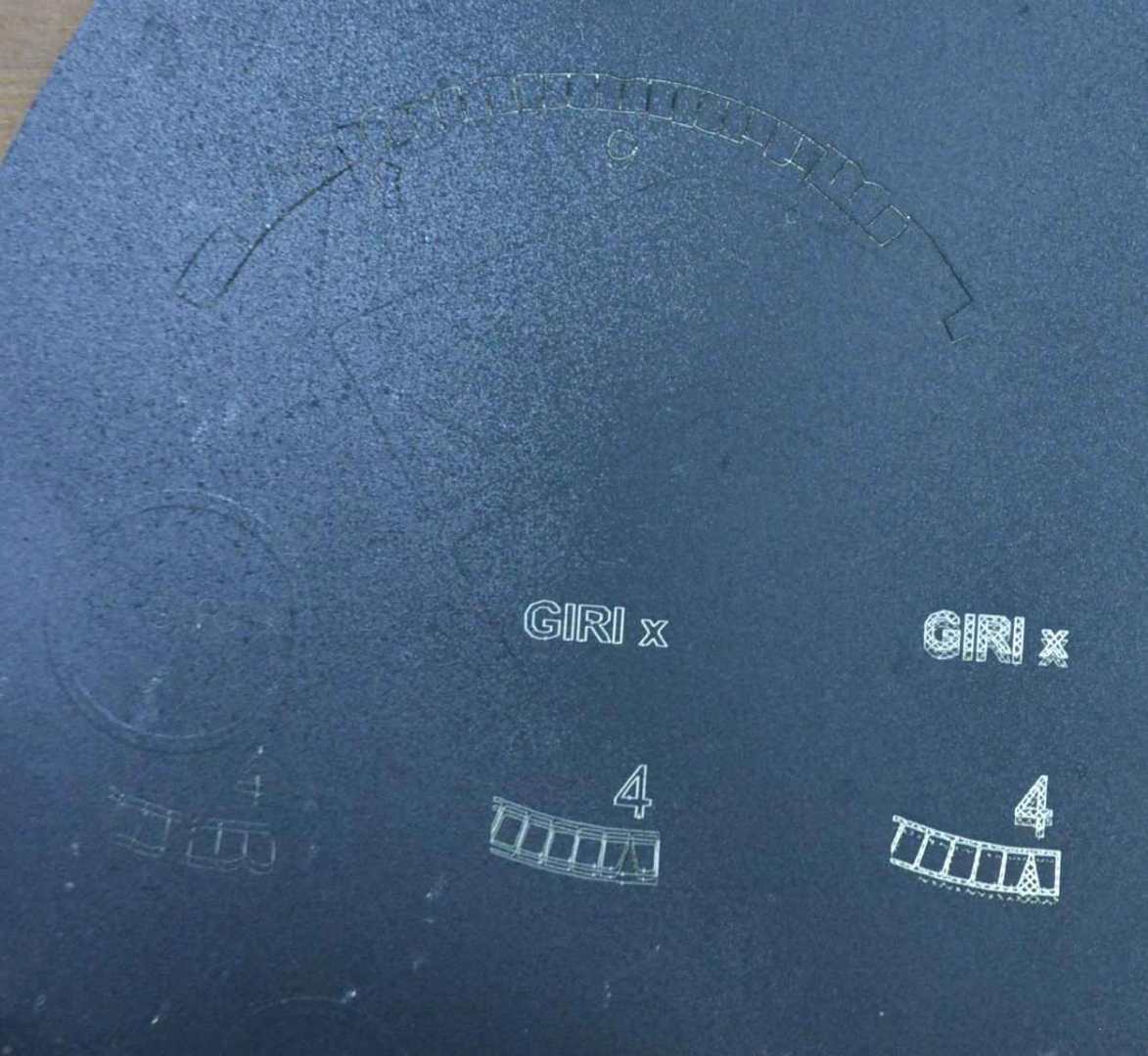

    About the laser engraver. My son had a surplus to requirements 3D printer and I saw that replacing the printing head with a laser would be an easy job. So I fitted a low power laser (read CHEAP) to check out whether it would be a useful tool before spending more on a more powerful unit. I'll make a post on that soon. I do not have many photos of the lettering tasks but here is a first attempt at getting some software settings adjusted, near the top you can just see some witness marks where the power was too low or the feed too high.
    Home built universal grinder-laserthing005.jpg Click for full size.

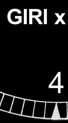

    Once I understood the settings the results improved. As you can see the white below is not noticeably affected.

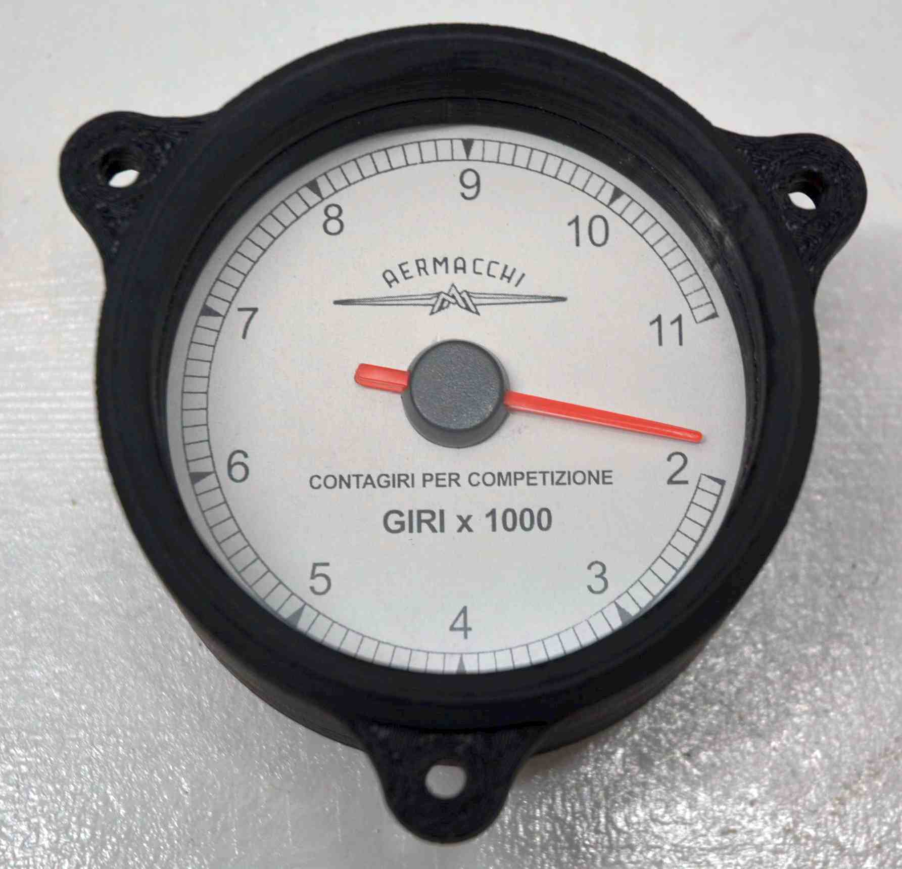

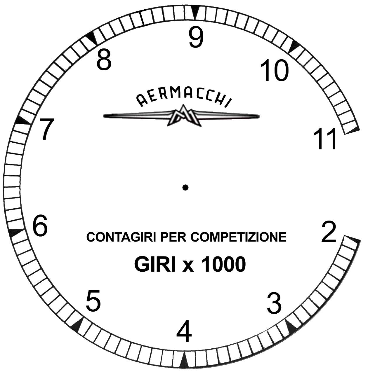

    This was just a test because I actually needed a black on white dial to roughly replicate a vintage tacho dial. I just printed this on adhesive backed paper and coated it with 2 coats of clear lacquer.
    Home built universal grinder-tacho-aermacchi-no-extras.jpg Home built universal grinder-tacho.jpg
Name:	Tacho Aermacchi No extras.jpg
ID:	46658 Click image for larger version.
    I'd say those are pretty good results. I would have been more than happy with that. Well done.

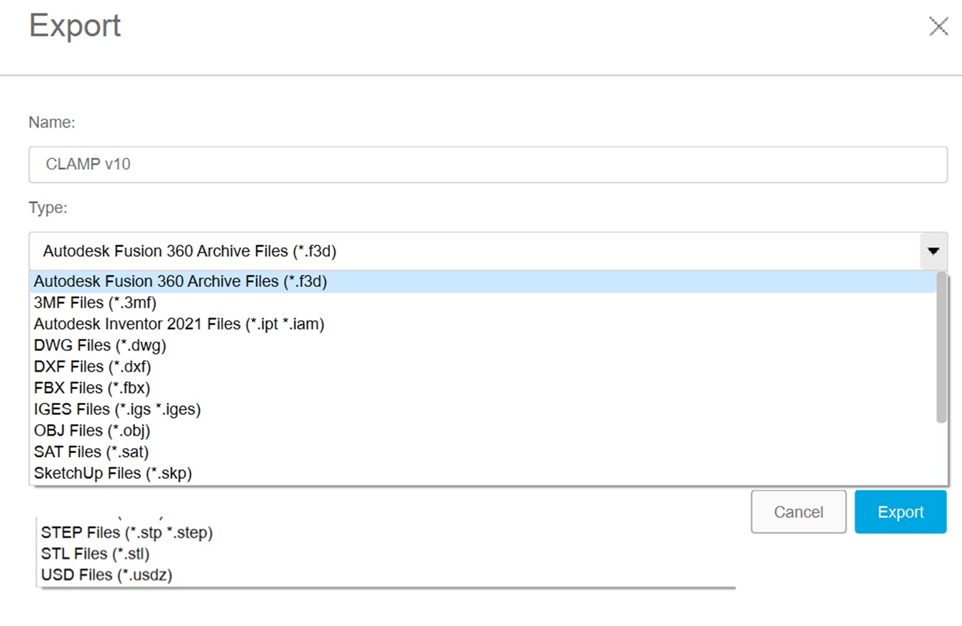

    Fusion may allow you to export to PDF or another format. This will not be as nice as viewing a Fusion file, but it would be more portable.

    It looks like these are the only formats F-360 can export.
    EDIT: This list is for the full blown education version. Free versions of F-360 restrict many features (or formats).
    Name:  Fusion Export files.jpg
