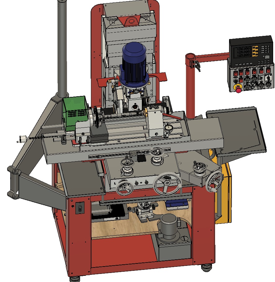

    I've added some sub-assembly Http files to my post, thus allowing non Fusion 360 viewers to study the assembly's in more detail and can also remove parts for more clarity.
    If they have Fusion 360 CAD, these files can be opened in Fusion with all associated details.

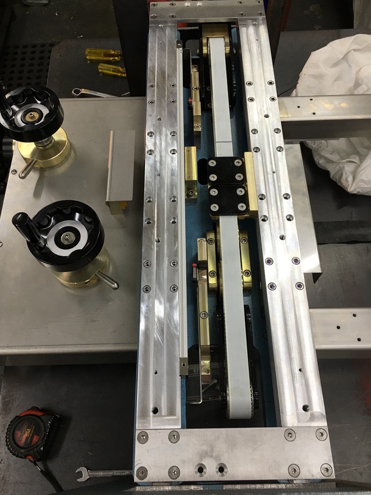

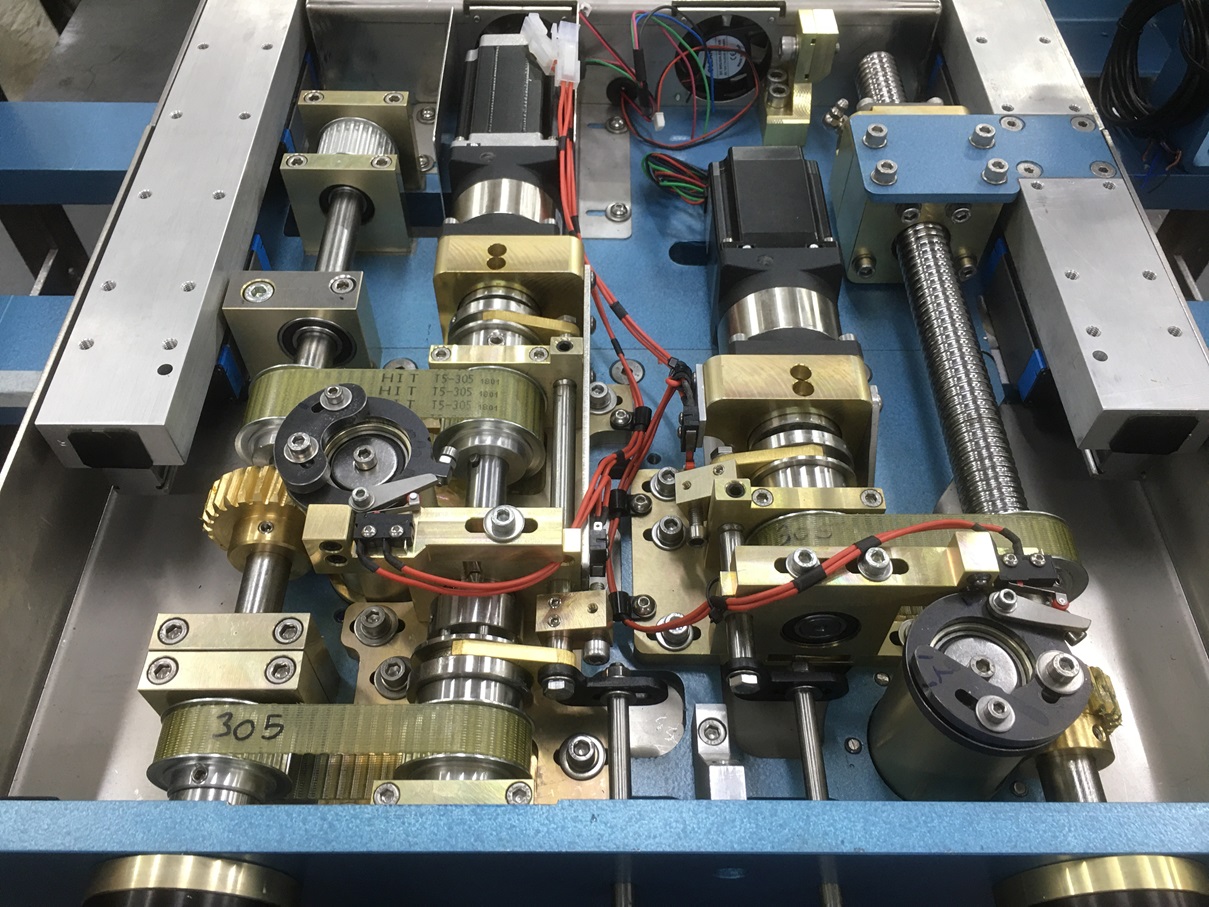

    Albert: Once again I want to thank you for your beautiful presentation and generous sharing of your IP. The http files are easier to orbit than an actual F-360 model! My question is about design intent. Is the timing belt drive on x axis as precise as the ball screw on Y? Or does it even matter since you have fine feed on both axises? What was your thinking in choosing one over the other?

    Hi Saltfever, my rational for the ball screw on the y axis, was because it is critical for cylindrical grinding, as you are feeding on radius like a lathe, whereas on the x-axis it is straight liner feed and my longitudinal tolerance's are mostly larger than my diametric tolerances. The x-axis belt although wide and steel reinforced still has some stretch, so not as accurate as the y-axis. Likewise I have a ball screw on the Z-axis for fine surface grinding height control.

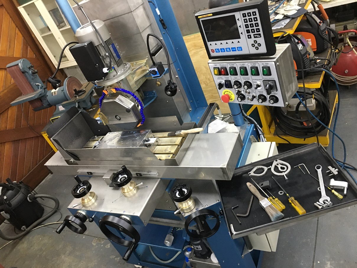

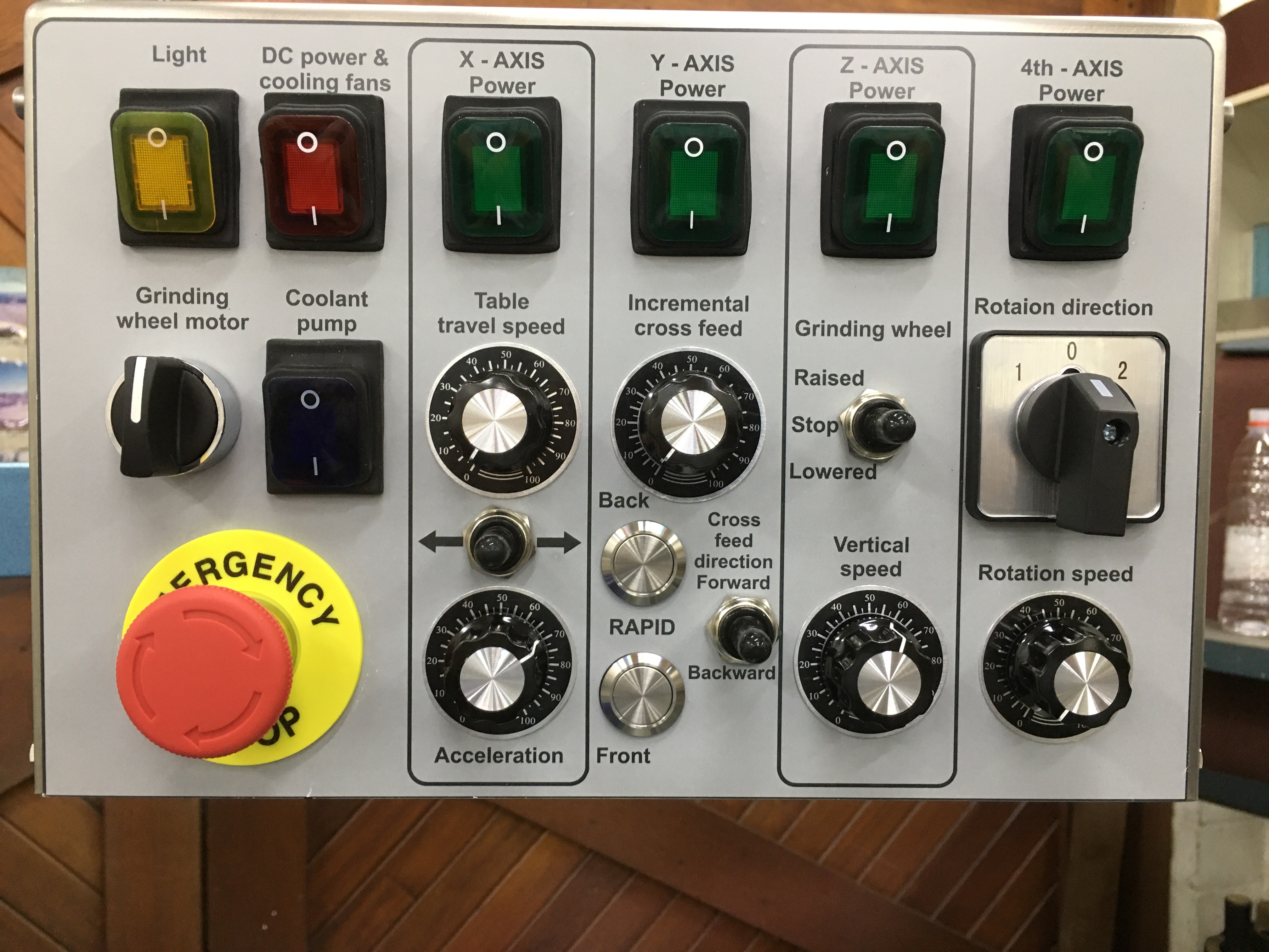

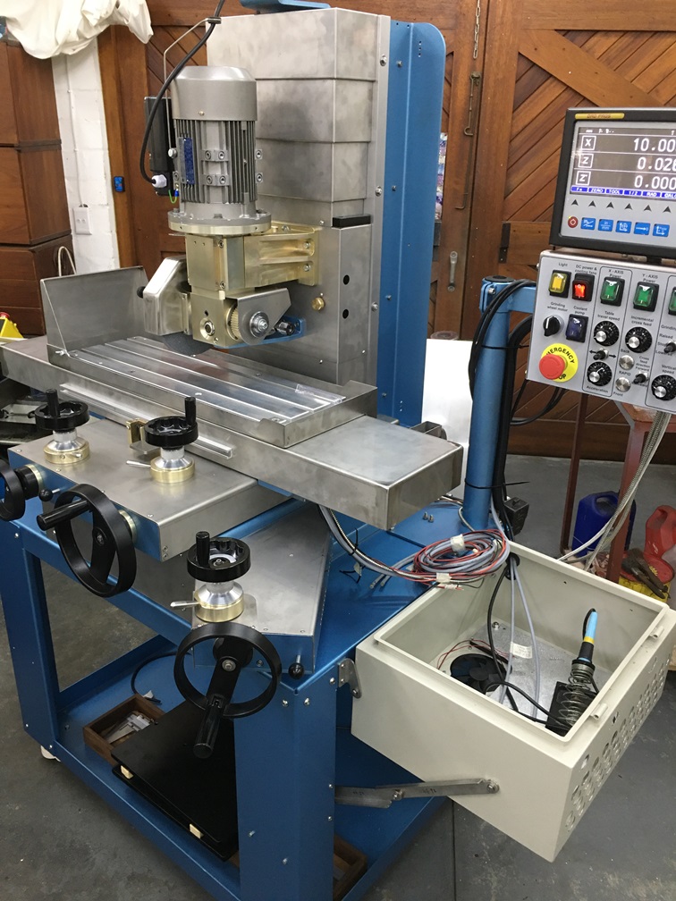

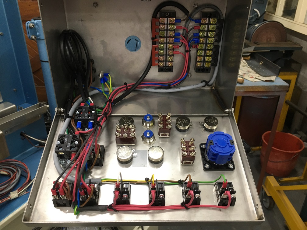

    Albert: Could you post a picture of your control panel? How did you make it; anodize, engrave, silkscreen, etc? Thank you.
  12. #19
    Aug 2021
    Cape Town SA
    250
    751
    Thanked 87 Times in 39 Posts
    albertq's Tools
    Quote Originally Posted by Saltfever View Post
    I drew up the panel face on CAD then had a decal made. In hindsight I should have sprayed a couple of clear coats over it before wiring it all up, as the printing wears off fairly easily if you rub it.
    I made both the panel and box cabinet housing the drivers & power supply, with hinges to make working in them more comfortable.

    Albert,
    Considering the effort that you put into this you must be really annoyed with the mis-spelling in the 4th axis column. Many years ago I had a batch of Tee shirts made with a spelling mistake and I hated it.
    On some projects I have made face panels by simply laser printing on to adhesive backed paper and sprayed a couple of coats of clear as you mentioned. Recently I have used a laser engraver but that tends to limit the colours. You need light coloured lettering on a dark coloured background. I paint the panel white to start with and then followed by black. The black absorbs the laser light and burns off, but the white reflects the light and stays intact.
