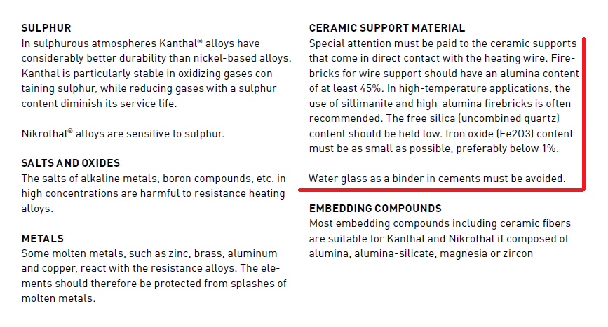

    Being in a "Furnace-planning mode" myself, I've just got a few tips:
    1) Blocks can be soaked in water before cutting, (temporarily) keeping the free dust down.
    2) Kanthal A-1 wire has higher temp, longer life, (higher prize) but it also assumes:
    3) Using the "26" type of blocks is absolutely recommended, as their alumina content is higher than lower grades
    (which can be seen from the Kanthal Handbook
    https://www.kanthal.com/globalassets...41-b-eng.pdf):
    4) As they also simply say: "Water glass as a binder in cements must be avoided."
    I guess they mean avoided entirely in the oven, as the fumes seems to deteriorate the Kanthal wire over time.
    Which really is a PITA, as water glass/ sodium silicate is convenient, readily available and cheap.
    Just my 2 cents, and YMMV.

    Hi Johan,
    That's brilliant, thanks so much. I didn't even know that what I was mixing was known as liquid glass. As soon as I read it I realised. Getting a bit slow with age.
    I wish I had known that before I did it, but I guess I will now be able to observe its effects! At least my design allows for an easy replacement of the coil. Also great tip about soaking the bricks.

    Sharing is the way to go forward - none of those tips were originally my own.
    I can merely read and have a decent memory (for my age).
    AFAIK - the need for high alumina content of the "26" bricks (as to compared with lower temp grades),
    are that the content forms a greyish Al2O3 protective oxide cover on the A-1 wire when glowing,
    thus prolonging the life span of the wire.
    This is particularly true when running the oven/ kiln up to and above 1300C,
    where the wire really begins to suffer, and where the sodium silicate would become more detrimental.
    Water glass is usually one of my go-to materials (as a cement binder, water & fire protection, glue etc),
    and it would've darned useful for (cheaply) reinforcing these "26" series fire bricks...

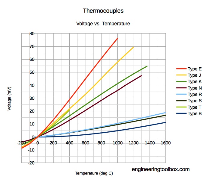

    Johan, maybe you can help me with something. I know I bought the wrong thermocouple and I am waiting for the correct one to arrive.
    But I set my oven to 600C and put an old file in there. When the oven got to 600C, I opened the oven and the file was bright red hot, and my infrared thermometer read 800C.
    How can it be that wrong? Any thoughts?

    Short answer: Trust the thermocouple - be wary of the IR thermo until you've figured out and applied this:
    // EDIT: You wrote "the wrong thermocouple" -
    did it max out at 600 C and the oven trampled on upwards, or what's the couple's upper limit?
    I guess tool steel shouldn't be bright red at 600... Better recheck that before anything else of the text below...
    Different types of thermocouples has different output voltages:
    So having a wrong type could fool your controller into thinking it's 600 when really at cherry red 800-ish C...
    For instance - plugging a "K" type into a controller set for a "J" type would perhaps be consistant with your result?
    (Just follow the 33 mV line from the yellow "J" line (600C) to the green "K" line and read its temp below)
    Sorry - I'm just about to hit the sack, so I wasn't really bright and fast enough.../

  10. #8

    Sorry, Nick for perhaps being confusing in my previous post, I totally missed the obvious last night...
    The discussion on IR thermometer and materials & temp is probably NOT relevant in your case.
    I assume by "Wrong thermocouple" you meant you plugged a "K" type into a PID/ controller designed for a "J" type?
    Then, IF you choose 600 C as the limit temp, the controller will open the throttle wide open,
    until it gets 33 mV back from the thermocouple input.
    Fine and dandy IF you'd hook a "J" type up, which will precisely return that voltage at 600 C,
    - but a "K" type would give off 33 mV first when it's reached 830-ish degrees.
    I guess this was exactly what happened
    (but your IR thermometer could have had its emissivity factor off too, but NOT deviate by 200 degrees...)
