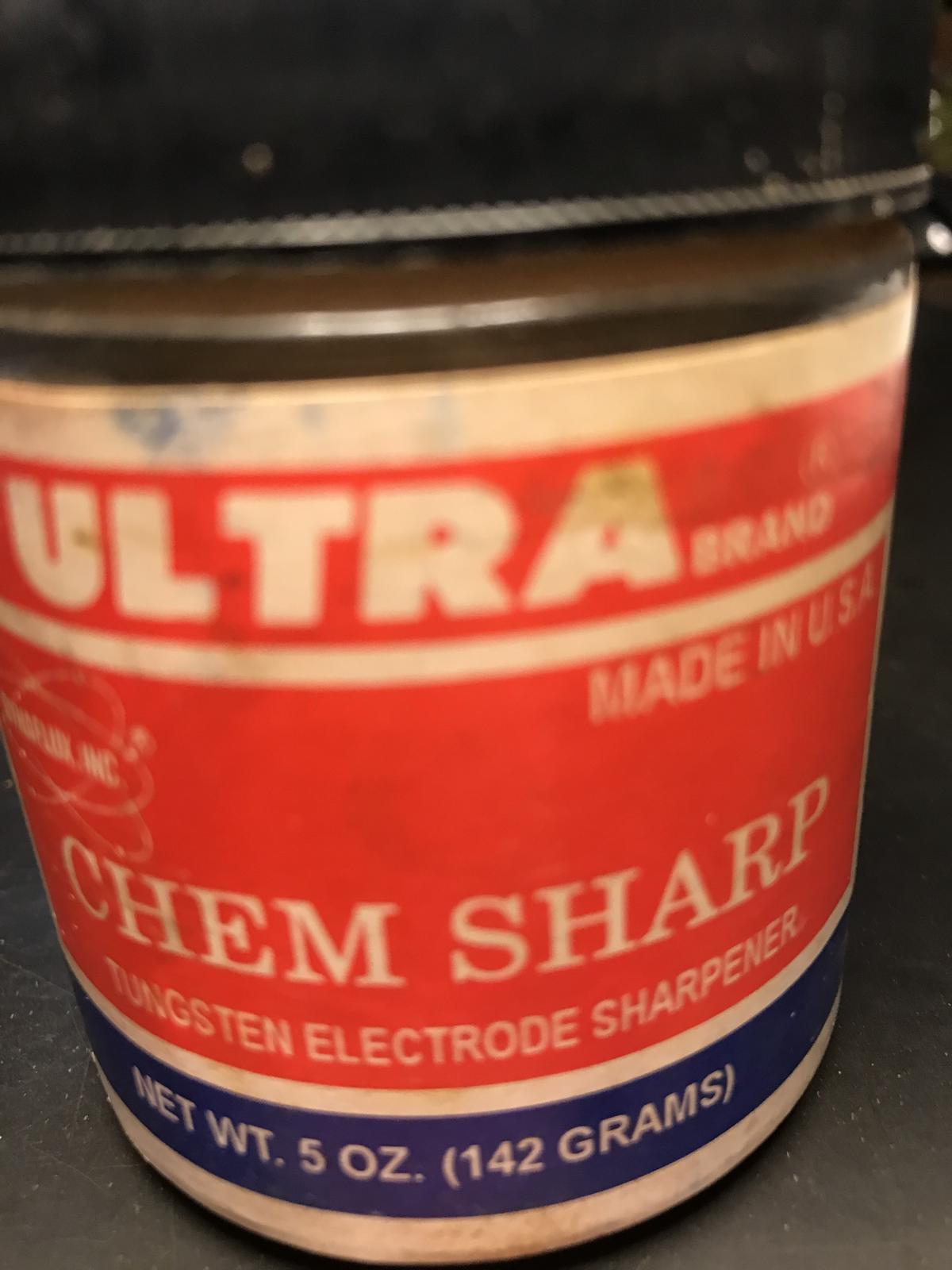

    I still have an old jar of this stuff...

    Quote Originally Posted by IntheGroove View Post
    I had to do a search for that. That's just amazing.
