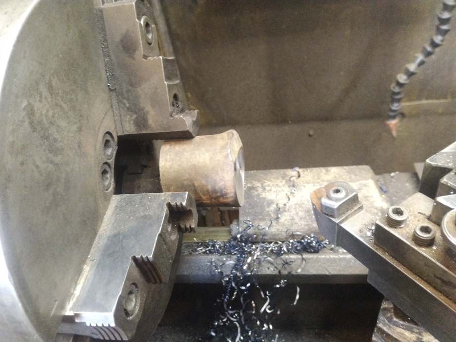

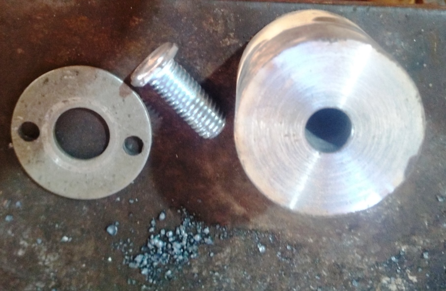

    This simple fixture is for holding a 1/2" bolt in the vertical position to allow welding something to the bolt head.
    I started by simply cleaning up a cut off piece 2" round bar then drilled a 1/2" hole in it
    Holder for 1/2 bolts for welding on the heads-img_20220308_171651wf.jpg
