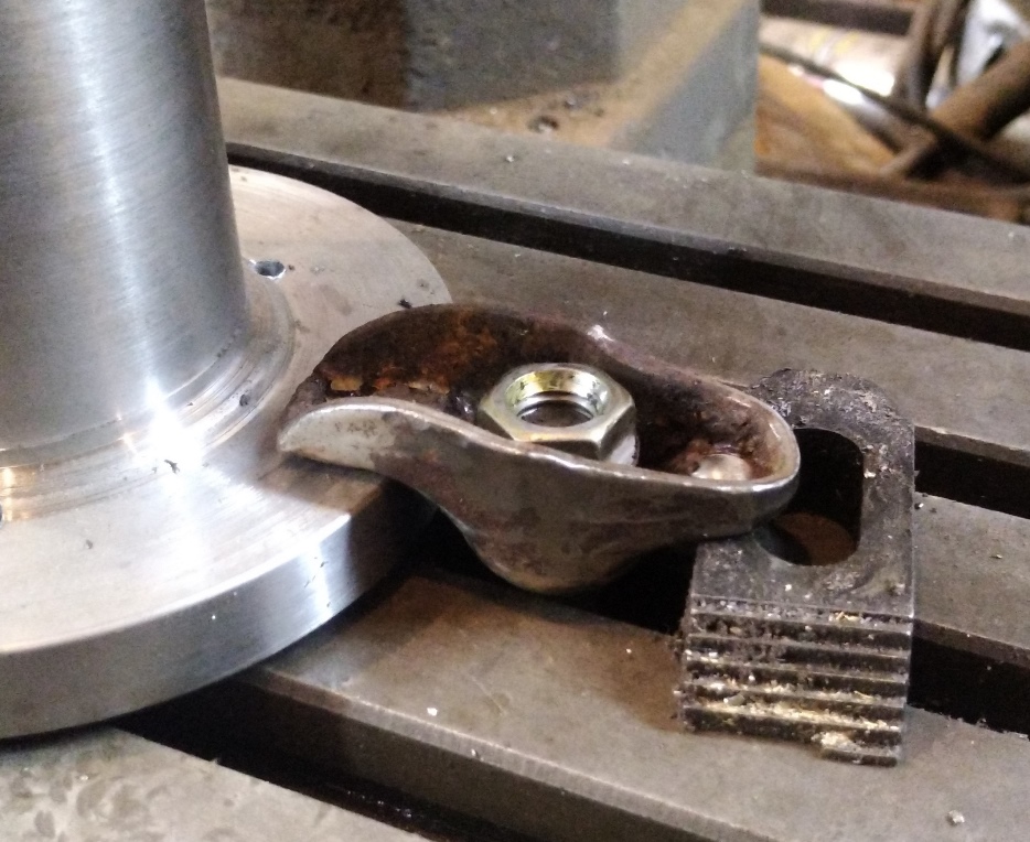

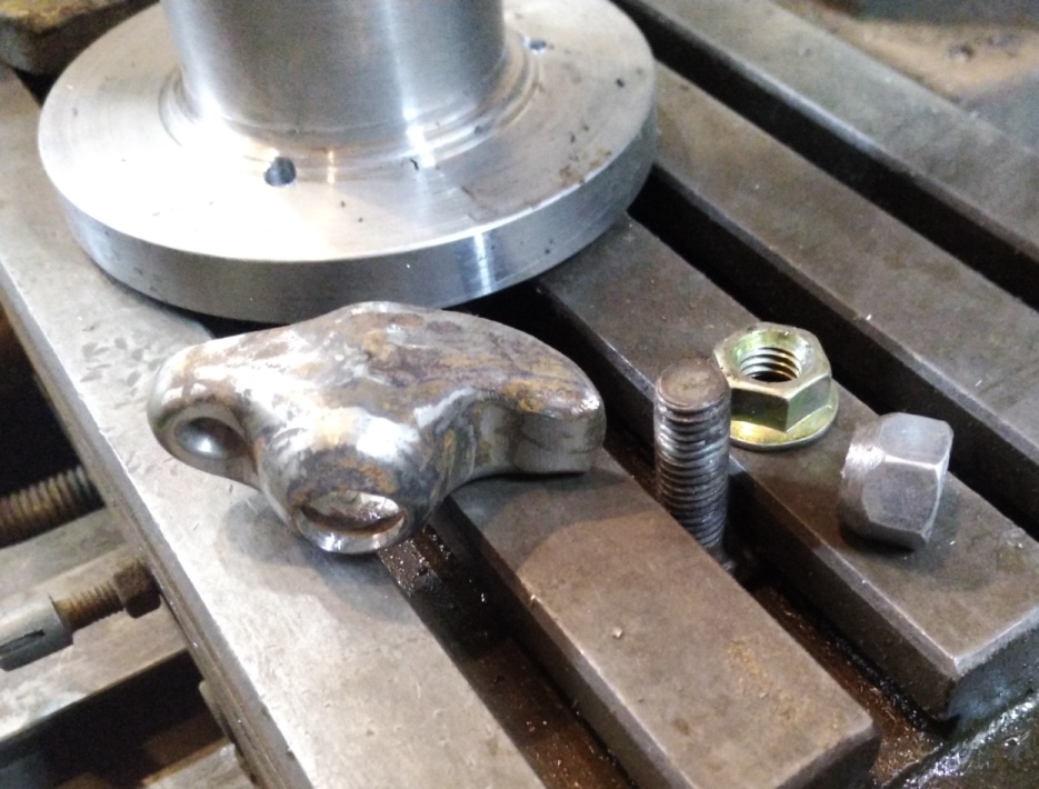

    I have mentioned these several times in the past but never published one, so today when I found one while rummaging around looking for something else I decided it was time to make one again.
    I started with a rocker arm from a SB gm engine, with a bur file on a die grinder I enlarged the hole to accept a 1/2" T bolt then drilled out the threads from a lug-nut to become the swivel washer

    There are limitations for every tool, of course. Frank S's rockers for example are fine in many instances, but not always. The limit is in the design of maybe 1:1.5 to 1:1.6 ratio of clamping, the fastener is right in the middle. Strap clamps work best with the mechanical advantage taken at the 'toe', object being clamped.
