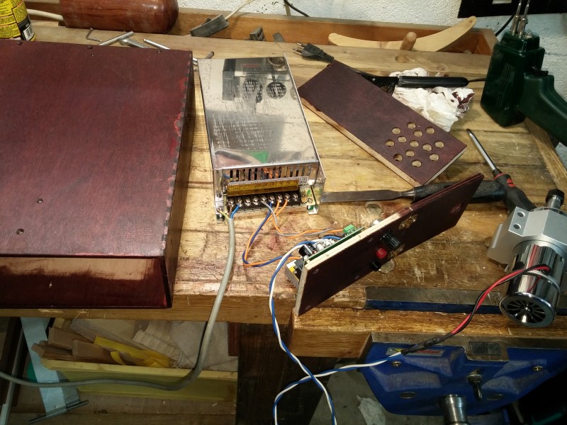

    The kit contains the spindle, air cooled, the power supply, 48V / 480W (quite usefull by itself) , a PWM controller board with a potentiometer to regulate the speed, and a clamp designed to hold the body of the spindle with 4 screws.
    My plan is to install that spindle in the QCTP of my metal lathe.
    I had to slightly modify the aluminum clamp, milling flat the bottom of the sole, and then I screwed this steel dovetailed plate, in order to fit the QCTP socket.
    Here is how looks the spindle tool ready for mounting in the QCTP.
    Then I had to pack all the components and mainly isolate the power supply and control board.

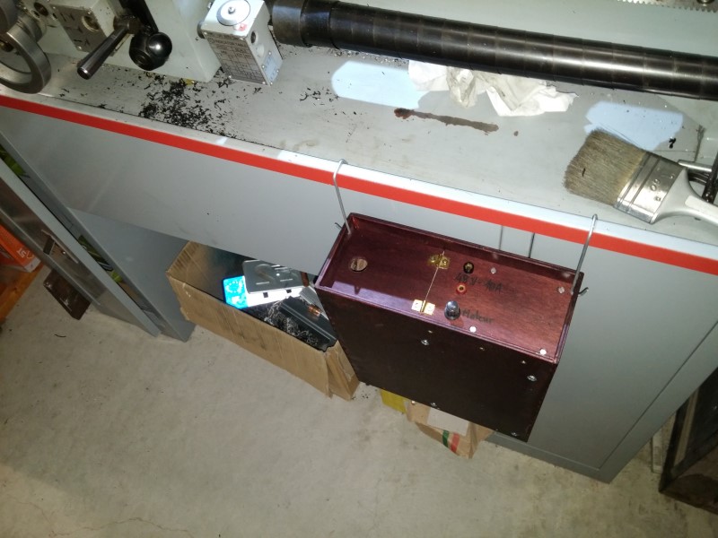

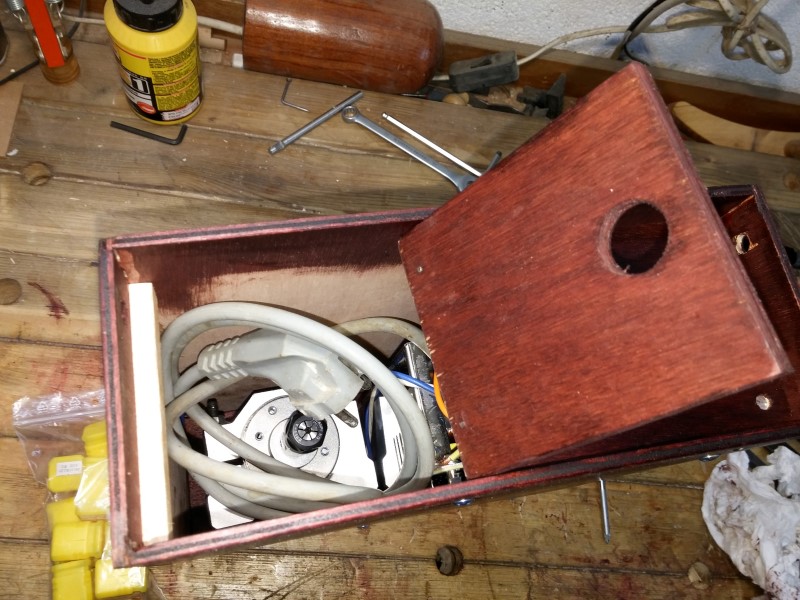

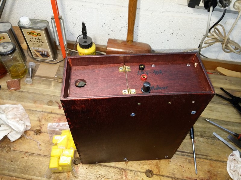

    I had the idea of making a box that would have a double purpose : enclose all the component AND tidying up all the parts for transport and storage.
    Here is the box finished and closed
    And on the left part, you can see the parts and cords in it.
    I can attach the box to the lathe with two simple wire hooks
    Ready to use the tool
