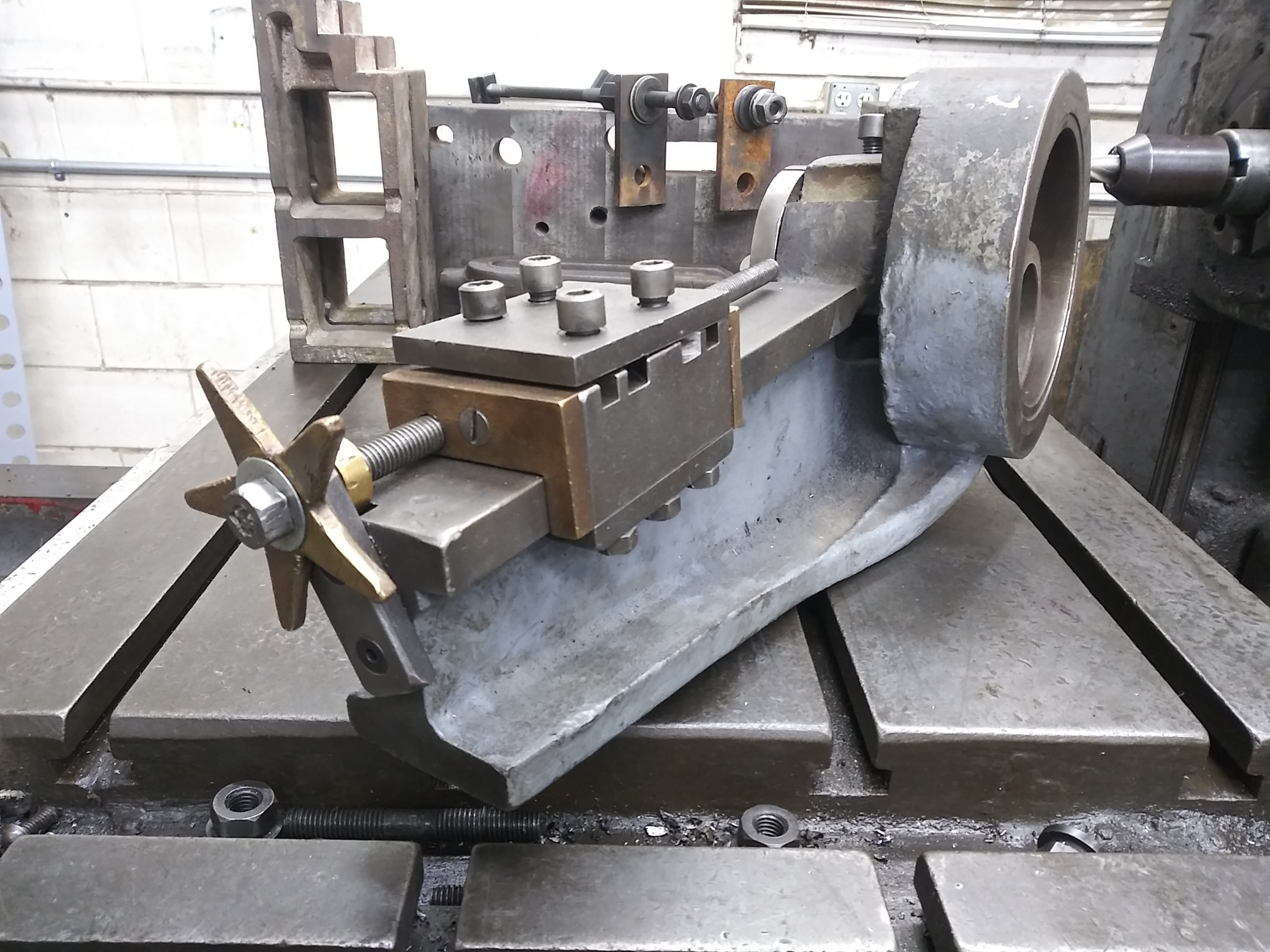

Boring mill yes, but quite small. In this photo, not set up for boring, that is a 'trip wheel facing head' mounted on the spindle. The 3 pronged "T" is tripped into partial rotation as it swings arc, turning the lead screw, barely visible inside the base [looks like a drill press vise].
The machine itself is larger yet, this housing is mounted on a accessory table to provide X axis across spindle. farther down is driving end of a Morse Taper line boring rig; and isn't that the planer in the background from several posts back?
Attachment 41477
Here is a larger model from Giddings & Lewis, fits a 3" boring mill. 5-star and 1/2-13 thread lead screw; results in 0.0153 per revolution from 0.0769 thread pitch/ 5. Changing lead screw alters pitch, after consideration of part size, tool bit radius [or form], material and rigidity of setup. The tool block holds a conventional square bit, presenting it right or left hand, or angular position for shoulder or undercut. That's when attention level has to be 101%, stopping rotation properly, compared with unobstructed facing work.

BTW Did anyone pickup on the dog's breakfast of the work-piece setup?
