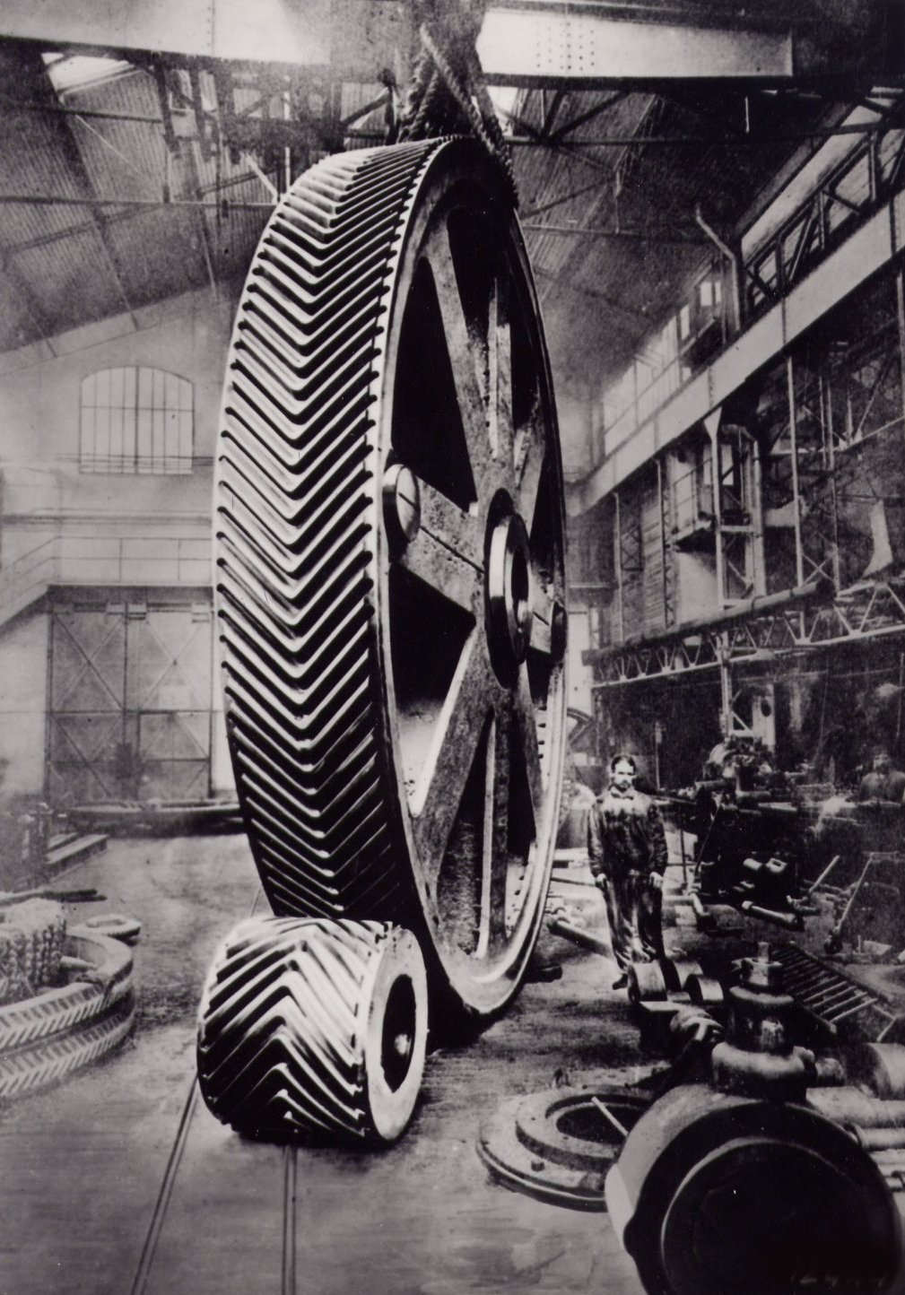

    Are those big gears machined with the chevron shaped teeth? or is that two big gears put together to make one. Very impressive either way, I just have trouble imaging how they would machine the chevron.

    Machined as one gear...
    High-quality black-and-white photographs of large old machines and tools-engrenages_-_85.488_-.jpg

    Ah, I see they are created in several different ways.... as explained on https://en.wikipedia.org/wiki/Herringbone_gear
    "A disadvantage of the herringbone gear is that it cannot be cut by simple gear hobbing machines, as the cutter would run into the other half of the gear. Solutions to this have included assembling small gears by stacking two helical gears together, cutting the gears with a central groove to provide clearance, and (particularly in the early days) by casting the gears to an accurate pattern and without further machining. With the older method of fabrication, herringbone gears had a central channel separating the two oppositely-angled courses of teeth. This was necessary to permit the shaving tool to run out of the groove. The development of the Sykes gear shaper made it possible to have continuous teeth with no central gap. Sunderland, also in England, also produced a herringbone cutting machine. The Sykes uses cylindrical guides and round cutters; the Sunderland uses straight guides and rack-type cutters. The W. E. Sykes Co. dissolved in 1983–1984. Since then it has been common practice to obtain an older machine and rebuild it if necessary to create this unique type of gear. Recently, the Bourn and Koch company has developed a CNC-controlled derivation of the W. E. Sykes design called the HDS1600-300. This machine, like the Sykes gear shaper, has the ability to generate a true apex without the need for a clearance groove cut around the gear. This allows the gears to be used in positive displacement pumping applications, as well as power transmission. Helical gears with low weight, accuracy and strength may be 3D printed."

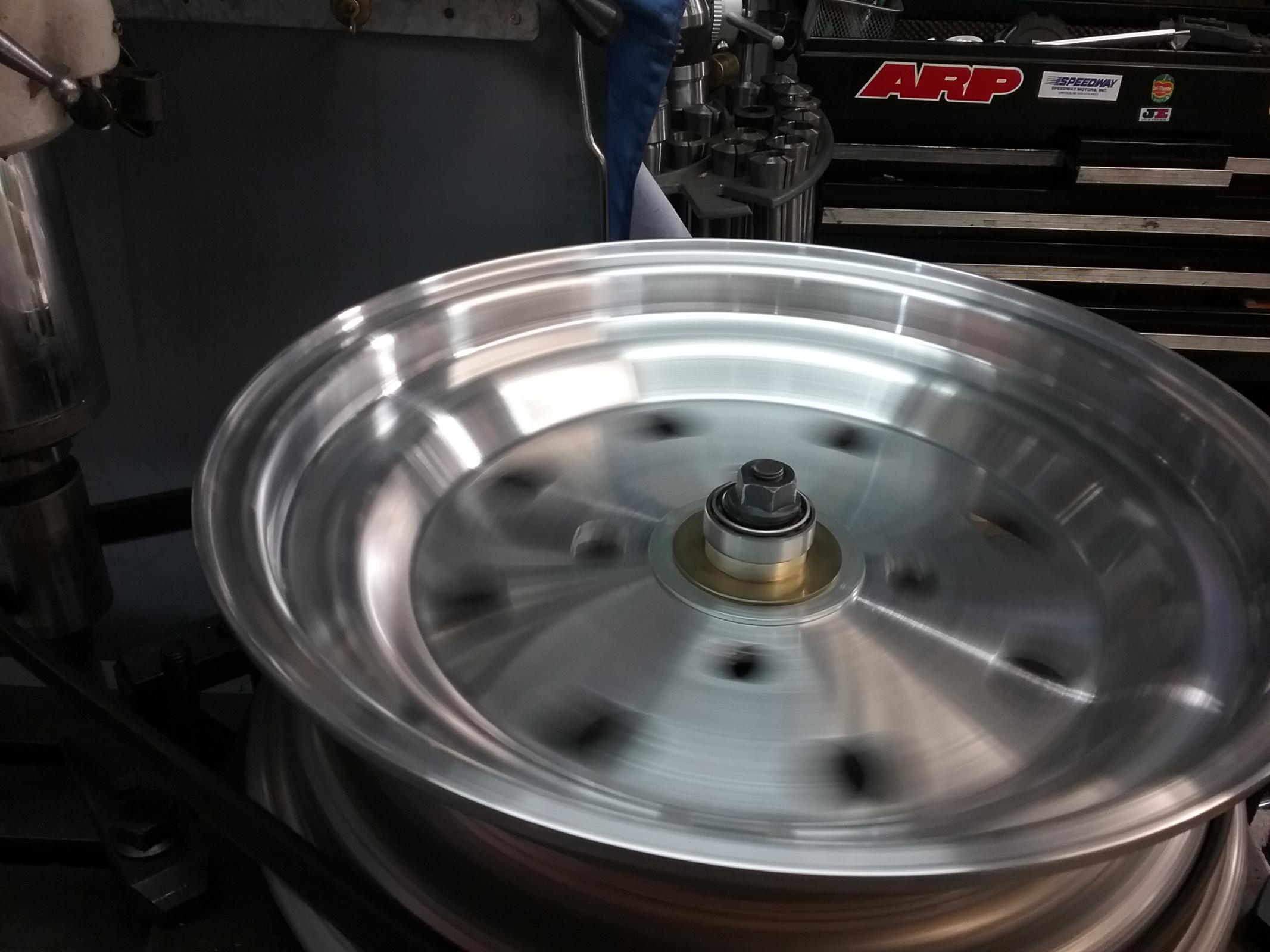

    looks like there making the wheels for my racecar!!!! well...I had some that were forged and some that were spun. and some that were ****....I had some CMS wheels on the front of one of my cars...I thought that stood for China Made ****...I was informed those were made in cali.....fornia. I bought them new as I have all my wheels, they were the worst **** Ive ever seen, wobbly as hell, like 2-3mm run out side to side and the bolt pattern wasent even in the center that was off around 2 mm...how the **** can you make **** like that and charge for it???? I put them on my mill squared them up, straightened,recentered the bolt pattern, and added some lightening holes.High-quality black-and-white photographs of large old machines and tools-20180705_125254.jpg. they were oh so much better when I finished.
