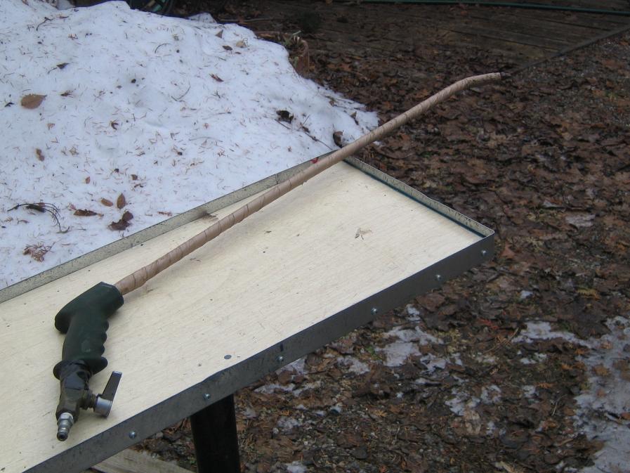

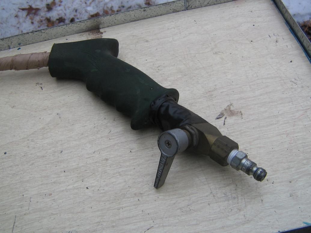

    High pressure air wand
    Made from a car wash spraying wand, attaching air line fittings and an on/off valve makes this old water sprayer an excellent air sprayer for getting in those hard to reach spots.
