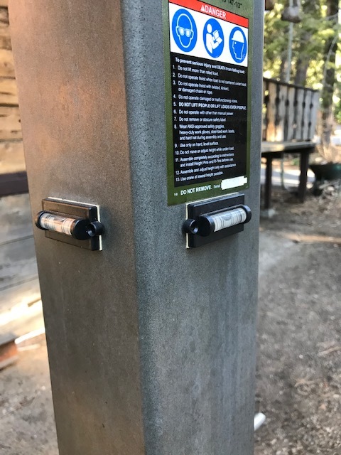

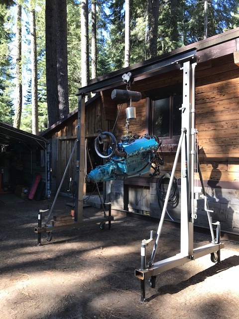

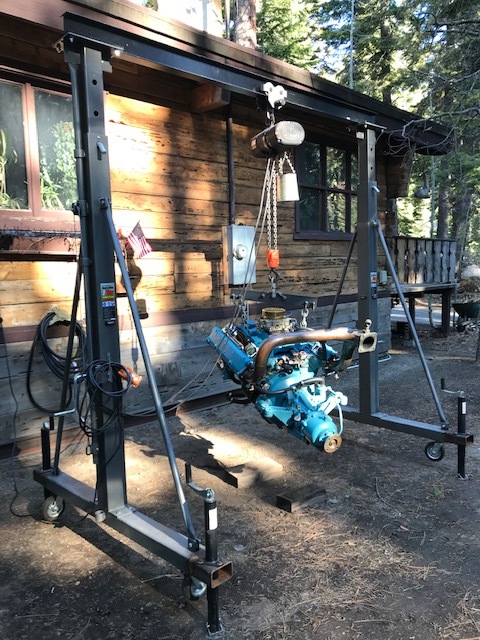

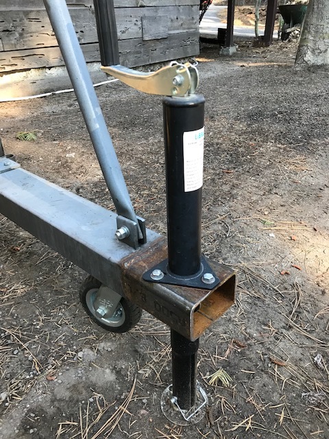

    My work area is dirt or ice depending on the season. I modified my HF gantry crane to work in these conditions.
    HF GANTRY CRANE MODIFIED FOR ROUGH/ UNEVEN TERRAIN-img_1265.jpg HF GANTRY CRANE MODIFIED FOR ROUGH/ UNEVEN TERRAIN-img_1272.jpg
    First I replaced the four inch steel casters for eight inch rubber casters. Then I added six inch extensions to the four corners and mounted four trailer jacks. Four spirit levels were attached to the posts so it can be made plumb, level and square.
    HF GANTRY CRANE MODIFIED FOR ROUGH/ UNEVEN TERRAIN-img_1263.jpg HF GANTRY CRANE MODIFIED FOR ROUGH/ UNEVEN TERRAIN-img_1264.jpg
    I have since replaced the original 4.5 inch I beam with a 15 foot long 6 inch I beam so when not in use it straddles my carport...
