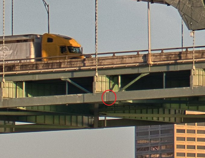

    A twitter person took this photo in July 2019.
    The bridge was inspected in Aug 2019.
    The yellow truck is westbound.

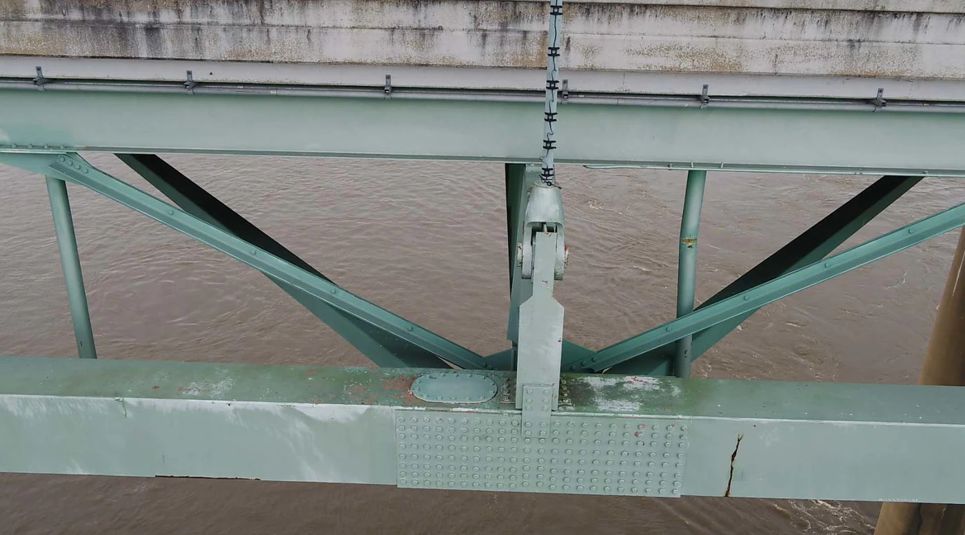

    May 17 2021
    The Arkansas DOT released this photo from drone footage taken in 2019 of the cracked beam on the Hernando de Soto Bridge in Memphis. The ARDOT leader of the inspection team has been fired for missing the crack during reviews of 2019 and 2020 inspection reports.
    Source: Arkansas DOT
    Jim

    Quote Originally Posted by jimfols View Post
    Is that an inspection walkway on the other side?
    Maybe the inspector should have taken a walk in addition to watching drone footage...

    The Drone footage shows the obvious crack, the inspector general was fired because he did not even look at the drone footage or take a walk.
