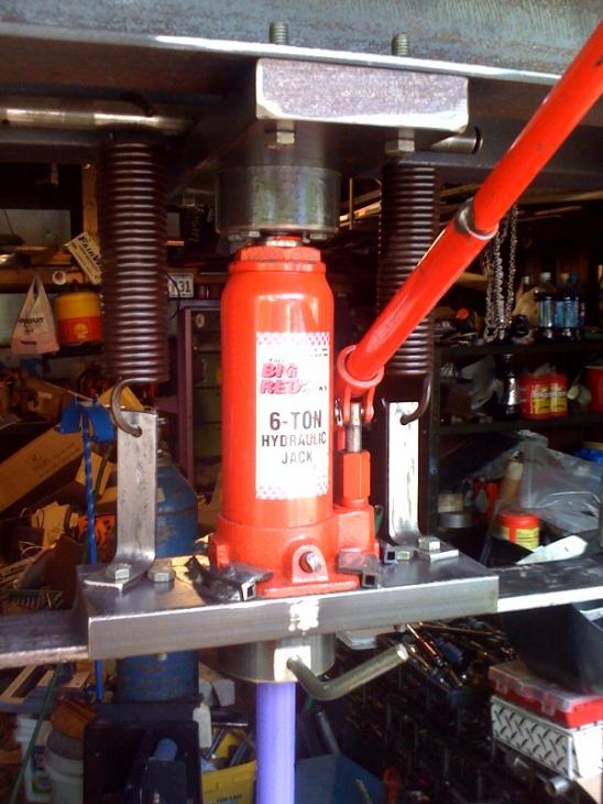

    Hi, I built a 20 ton wheel bearing press. I am looking for the extension springs for it. I have searched for hours on the web for them. I haven't had good luck. lol I am looking to buy 2. Here is a pick of a press. It is not mine. I'll take a pic of mine after I get the springs for it.
    Any help would be appreciated.
    Thank you, Dan

    Have you considered hood springs? You'd have to go to a junkyard, I suppose.
    A friend asked me that same question last night. I'm going to check it out. Thanks

    Another possibility,how about snow plow springs?
    I've checked those and they are too big. I'll be checking the junk yard this spring for hood springs.

    Hood springs worked for me...Bob
