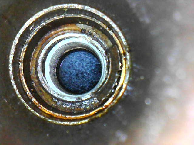

    I have the same task, to remove a failed helicoil from a spark-plug hole in a Mustang Cobra engine. It's 8 inches down a narrow well and inaccessible to pliers.
    My main concern is getting the thing out intact, because I can't have metal fragments falling into the cylinder. This is what I'm dealing with:
    I don't know the origin of that weird fragment at the 3:00-4:00 position, but it's attached to the coil (the shinier metal at the center of this mess). It might provide some purchase for rotating this thing CCW, and for hooking it with the kind of tool you guys described.
    In your experience, do the coils stay intact if you pull them straight out by the end? I'm not concerned with the threads in the hole, because I need to tap it out to install a Time-Sert.
    Thanks!

    You can make a wedge shaped tool from flat spring steel with a T handle like the bought ones and push that into the coil and try to unscrew it or If you can pop out the end of the helicoil then you can cut a slot in a screwdriver (slightly backward facing) and get hold of the end and pull the coil straight out. the helicoil always comes out in one piece so no problems there. Then just tap out the thread to clean it up and then insert another helicoil.
    Rich.

    That fragment looks like an old piece of the sparkplug sealing washer. Never seen one break up before so I may be wrong.

    Thanks! I've seen those, but of course the handles are way too short. I don't have a grinder, so making the metal wedge is already a problem, let alone mounting it in a handle.
    I have a really long spade drill bit of the right width, which I could sand the little spikes off of with my belt sander (yep, I do have that). Not sure how I'd secure it in a handle; I guess I could make a wooden handle and put a couple of set screws in it. I'd rather not ruin it (it's handy for drilling through walls to run network cable and whatnot), but I suppose it's not too expensive to replace.
    As for the fragment, I'm baffled as to when it appeared. The repair was done at least 10 years ago, but I didn't have misfiring until a few months ago; nothing was done to the engine immediately beforehand. The original diagnosis was bad plug wires, so I replaced both the wires and plugs. On reinstalling the wires, I noticed that the plug boot on the afflicted cylinder didn't sit flush against the valve cover the way the others did. Thus I suspected that the plug wasn't screwing in all the way, and the mess inside the well supports that theory. I think cylinder contents have been leaking around this plug; I checked the neighboring well and it's nice and clean.
