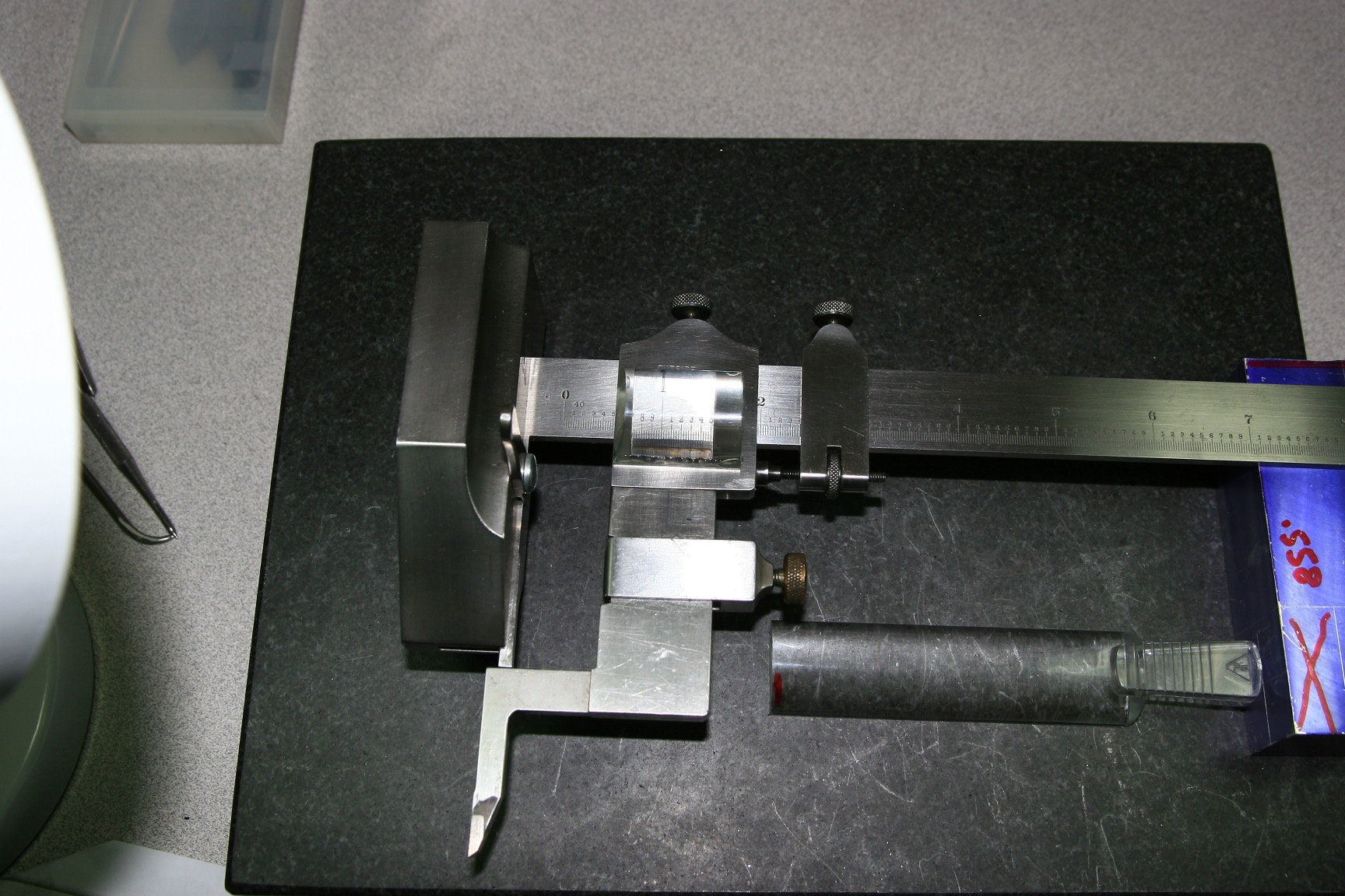

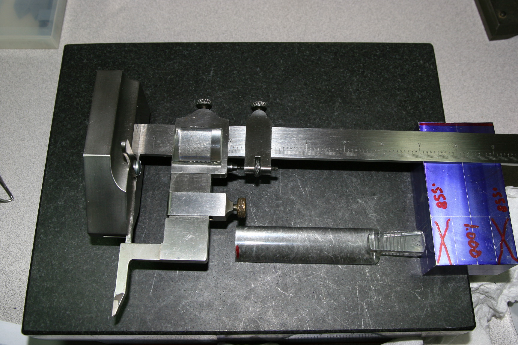

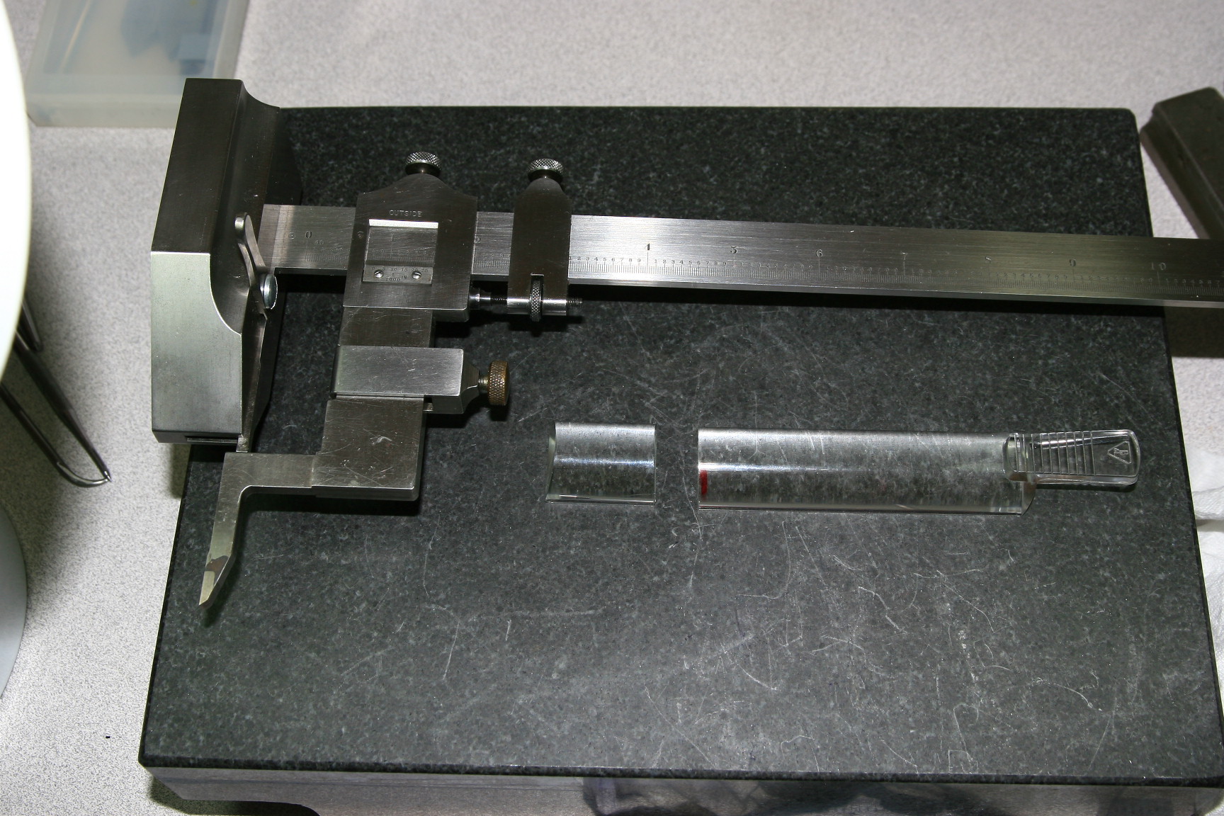

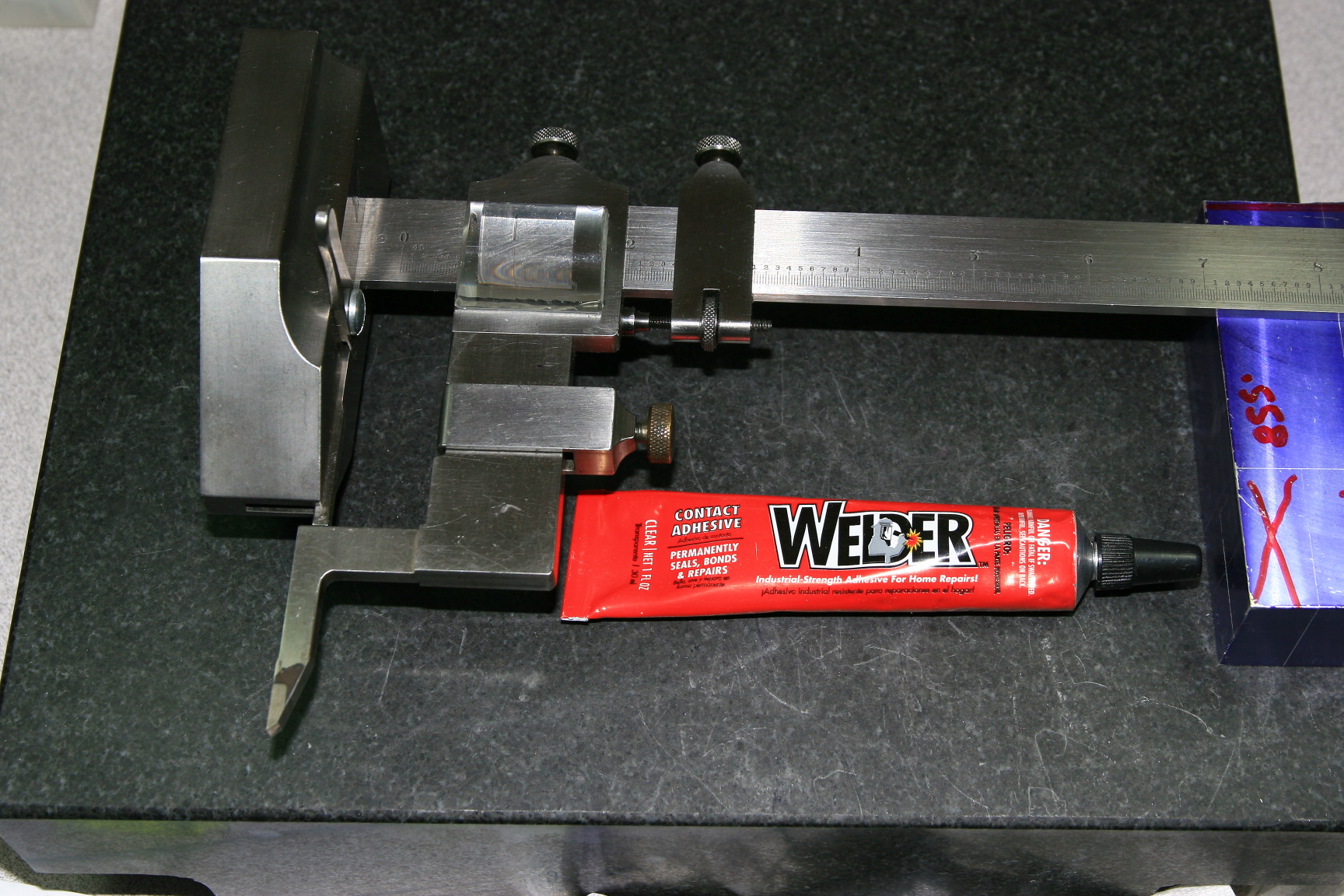

    I have this old Starrett 12" height gage that I like to use for layouts. Eyes are not what they used to be so I needed an assist.
    Cut a slice of magnifier from an old Bausch and Lomb reading magnifier. I glued it to the vernier slide and there it is. Instant 2X
    magnification. Much faster than holding up my little round magnifier to the scale.
    Cheers, JR

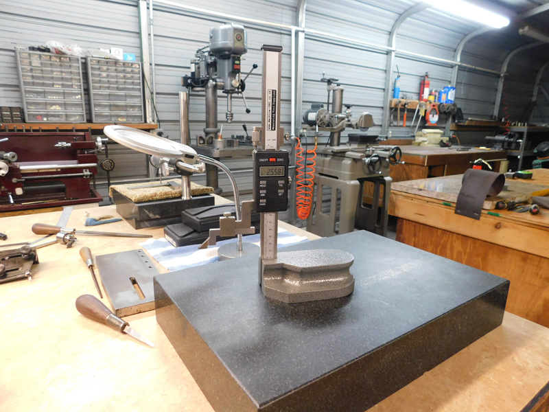

    Hey JR.
    I use to have a 6" Starrett height gage and used it for years until I got like you and couldn't see good enough to line up the graduations any more, even with glasses it was still difficult, had to go digital a few years ago, great idea !
    Doug

    Thanks Doug, I have considered a new 6" digital or even a dial but I was concerned that 6" was a bit small.
    Do you find that you have to revert to something other than the 6" digital for long measurements?
    Cheers, JR

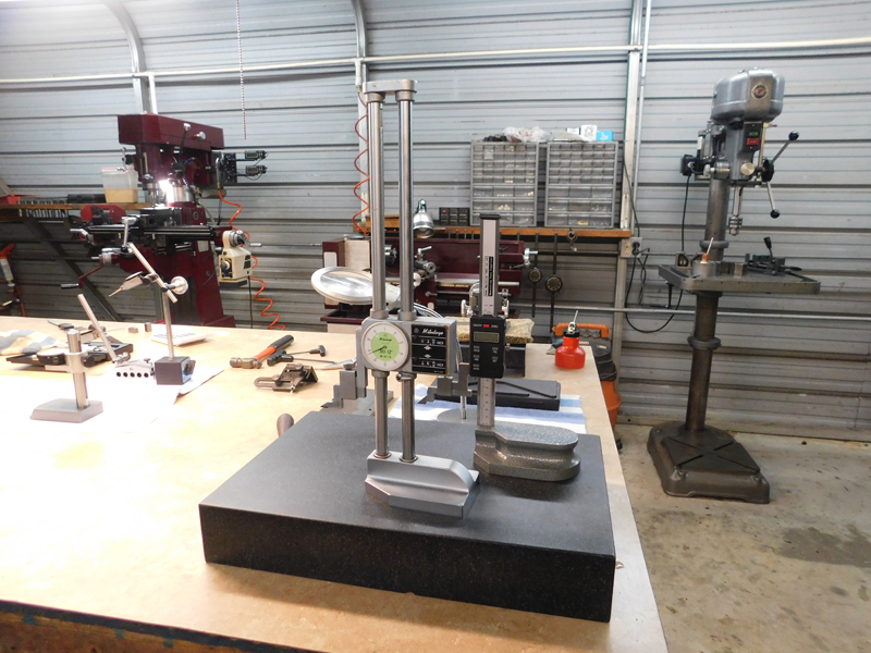

    Quote Originally Posted by jjr2001 View Post
    Cheers, JR
    Thanks JR.
    I forgot to mention I have this 12" dial height gage that I use when the 6" isn't enough, (see photo below) but the 6" one works 90% of the time, never enough tools.
    Doug

    Thanks Doug, I think the use of a digital would streamline my layouts a bit. I think I will make
    one for a 6" digital vernier that I have in my "clean room". I will post it when done.
    Thanks again, JR
