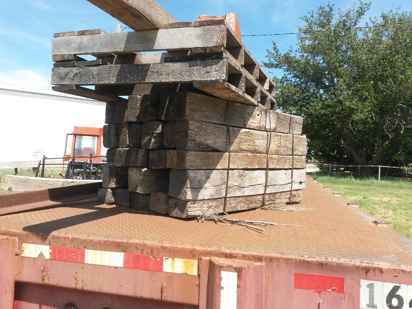

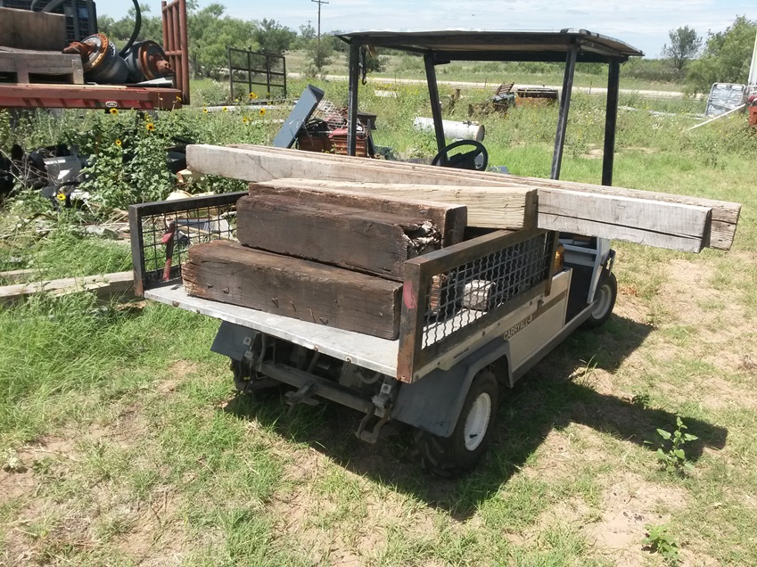

    It helps to have a lot of heavy duty large wood blocks
    Attachment 24439
    I have more if needed LOL
    Attachment 24440
    No such thing as excess cribbing.
    Riggers working in our shop today realized that very thing. At least one hadn't been stored dry; and then inspected before use.

    I try to take the same care of my cribbing as I do my gun powder.
    When I'm not using the cribbing blocks they are stacked out of the way out of the dun and when ever possible out of the rain large stacks of it stays banded up in a pallet sized cube. Any of it that starts to split or crush due to age and use gets cut up into fire wood My driver is forever dropping off more so I don't have to wory about running out anytime soon.

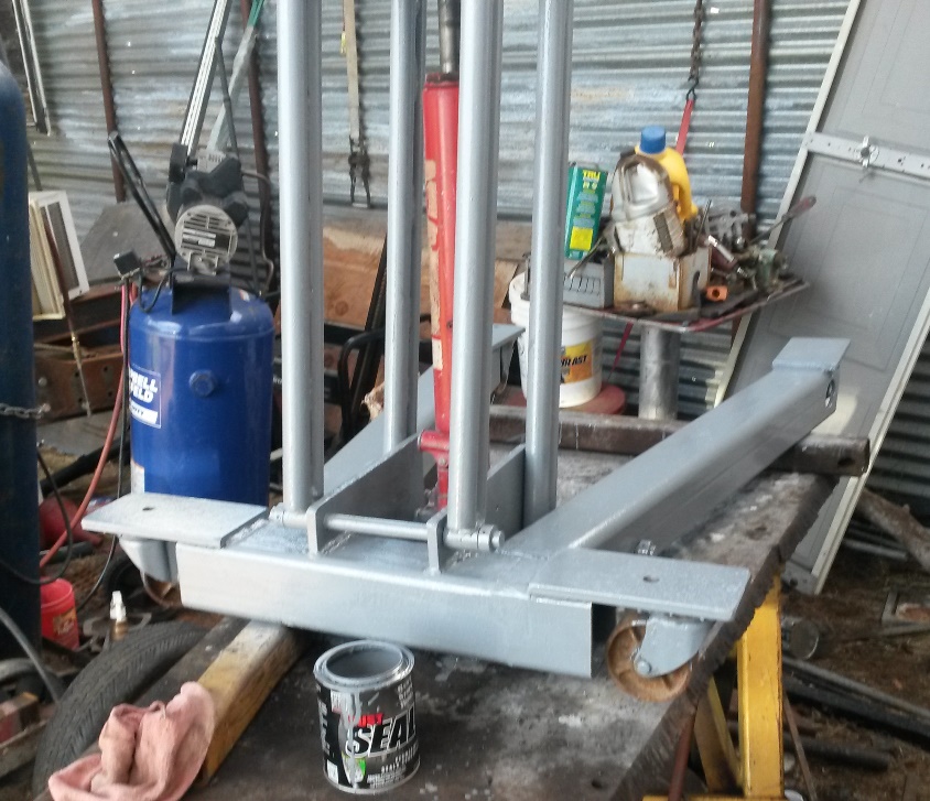

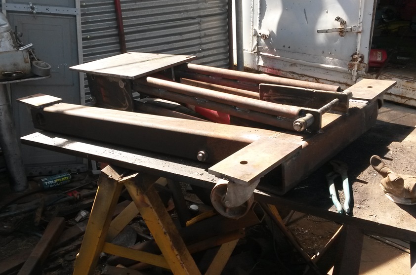

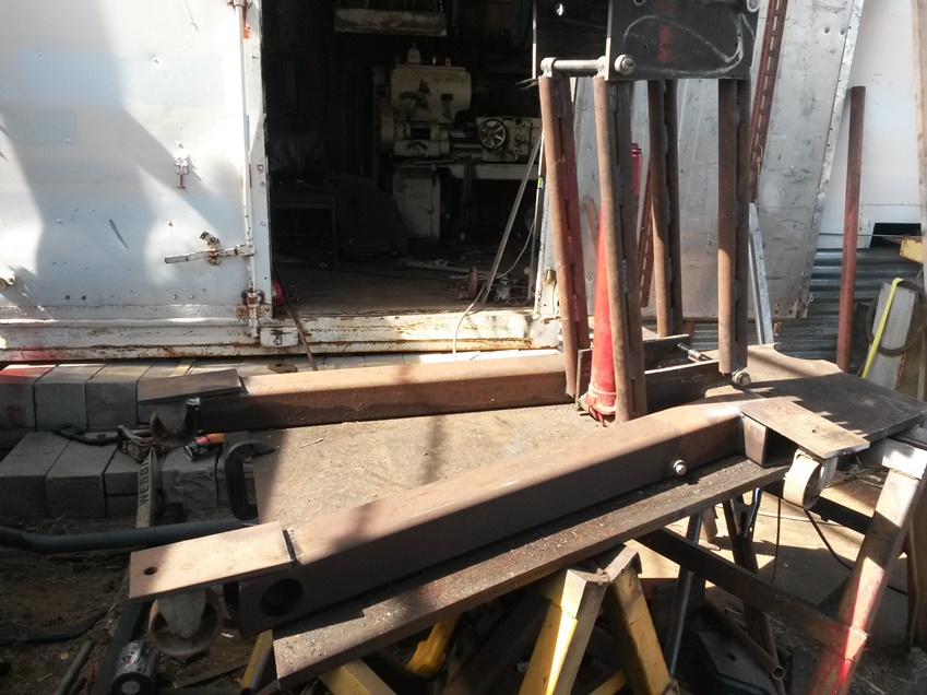

    Many years ago when I regularly worked on heavy equipment and trucks I owned a heavy duty transmission jack the other day a friend called me to ask if I could put a clutch and rear main seal in his Mack. I told him sure why not. So he said he would be passing through in a couple of weeks after I hung up the phone I remembered that I don't have a jack any more. No problem I'll Hire my neighbor who lives about a mile away to bring his over. Big problem his is busted he needs to have it repaired. I offered to rebuild the ram for him but he had already taken it to a shop where they have ordered the parts not sure when they will be in or when he will get his jack back. So I decided to just build one.
    After looking around I pulled a couple of 4x4 1/4" sq tubes out of my usable scrap pile dug out 4 heavy duty casters 2 rigid and 2 swivel from my storage van then found an 8 ton engine hoist jack. Hauled a piece of 1/2" plate steel out of my scrap pile and 8 lengths of 1" pipe that at one time was a sprinkler system A few feet of 3/4" 1018 cold roll rod for the pivots shafts and a lenght of 1/14" chromed cylinder rod for the pivots and a few set collars that I made up previously and I was all set I had a heavy duty transmission jack the only thing left to do was cut drill and weld all of this together
    Attachment 24157
    Attachment 24158
    Attachment 24159
    Attachment 24160

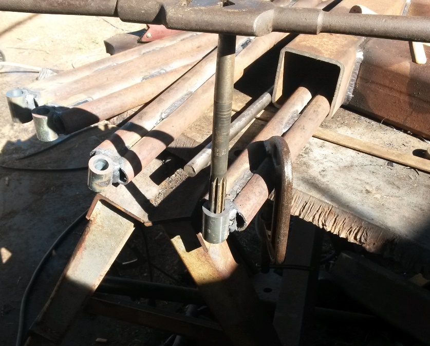

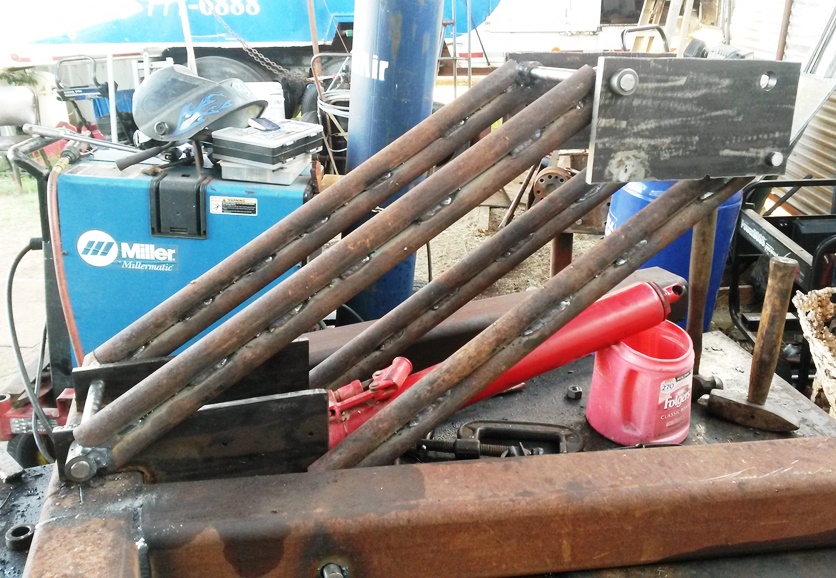

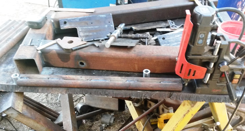

    After welding the 1 " pipes together to make the link arms I needed a weld jig to make sure the ends were parallel and matching lengths
    so I already had 1 hole in the 1" thick table I used my mag drill to drill another turning the table into a welding fixture or jig
    Attachment 24163

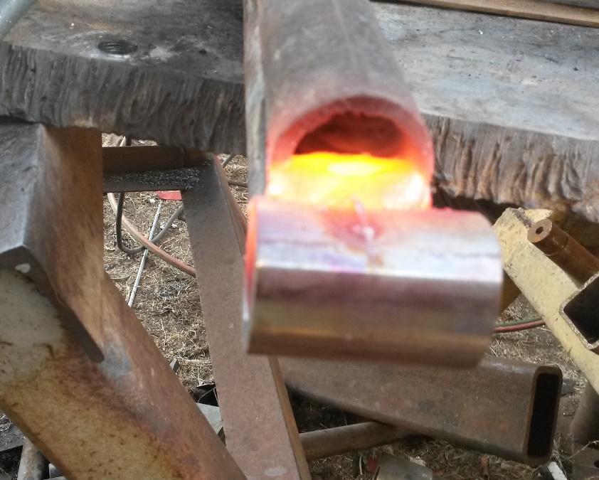

    I mig welded the ends on by welding about an inch inside of the pipes filling with weld
    Attachment 24165
    After all the ends were welded on the link arms and cooled I reamed the bores using my #7 tap handle on the tang of the MT#3 shank of a 3/4"
    Attachment 24166

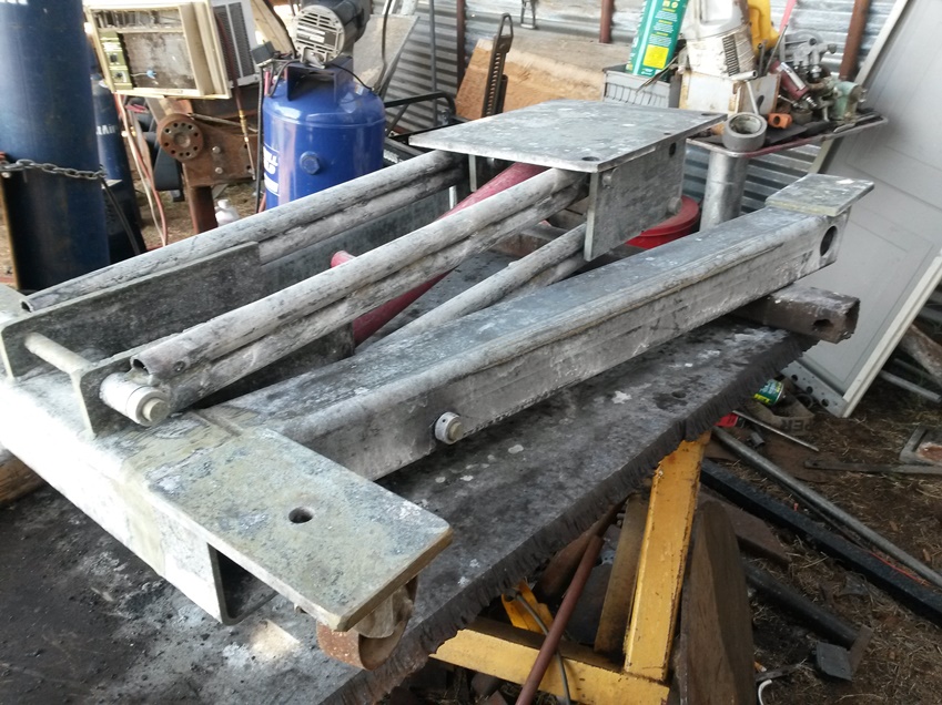

    Pre-assembled everything before welding
    Attachment 24167
    Just tacked together
    Attachment 24168
    Now a fully functional transmission jack
    Attachment 24169

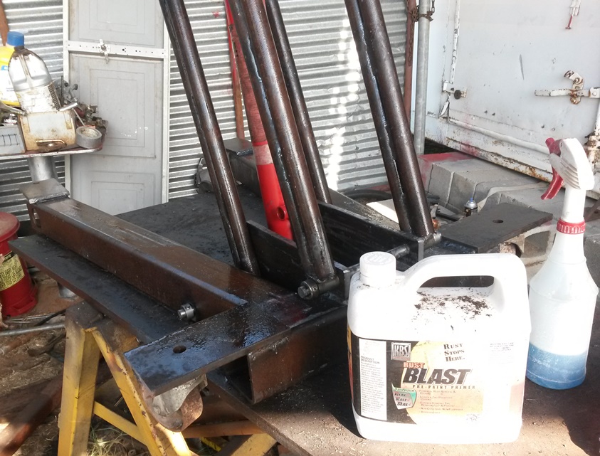

    I used KBS rust blast to remove the surface rust and provide a pre paint primer surface
    Attachment 24170
    KBS rust blast leaves a zinc coating that can either be brushed off or left in place Since I was out of etching primer I opted to just rub off and loose residue and leave the rest to serve as a primer
    Attachment 24171
    Painted with KBS rust seal machinery gray
    Attachment 24172
