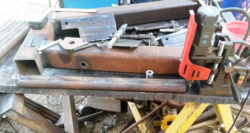

    After welding the 1 " pipes together to make the link arms I needed a weld jig to make sure the ends were parallel and matching lengths
    so I already had 1 hole in the 1" thick table I used my mag drill to drill another turning the table into a welding fixture or jig

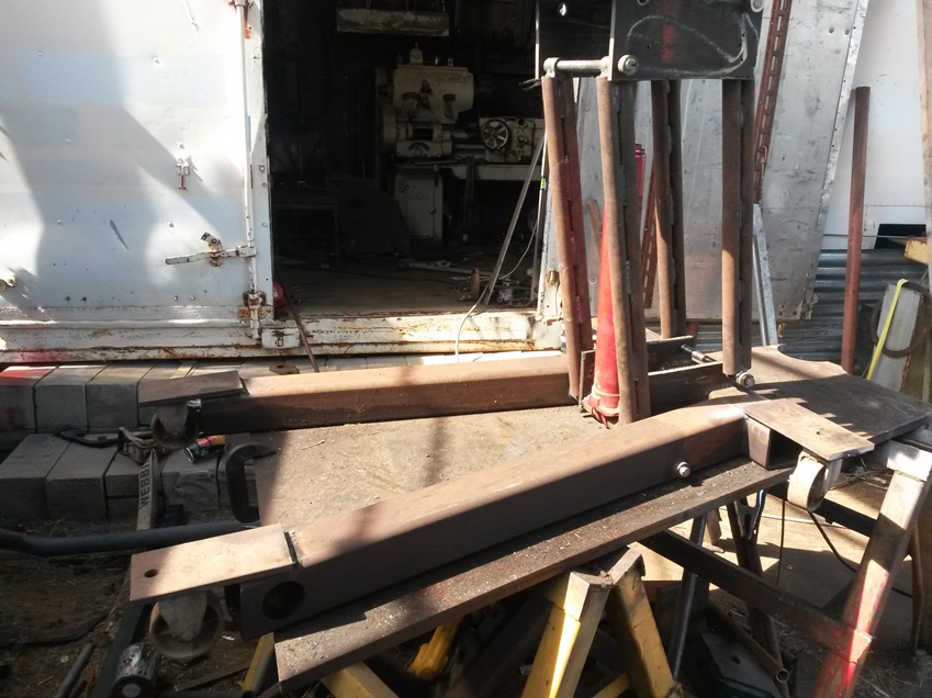

    Pre-assembled everything before welding
    Just tacked together

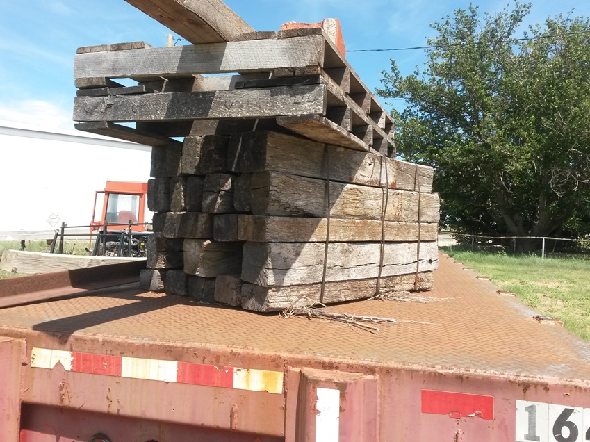

    Finally put the jack to work

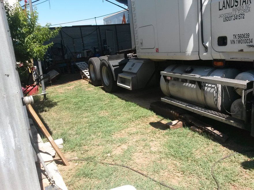

    The truck came in that I built the transmission jack for.
    the first thing I did set up my ramps to back the truck on.

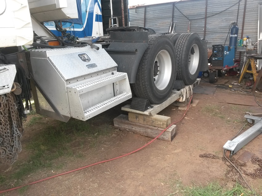

    A lot of guys pulling transmissions out of trucks will just raise the front end so they can have some room to work This is problematic as the engine and transmissions are mounted at a down slope angle if the front is higher than the rear the angle increases When pulling a transmission that weighs over 1000 lbs or any transmission for that matter the closer to having the engine and transmission parallel to the floor the better this makes for ease of removal and reassembly. since the jack only has to roll and not be adjusted for height as you are doing the job
    It helps to have a lot of heavy duty large wood blocks
    I have more if needed LOL
    Back the truck up the ramps

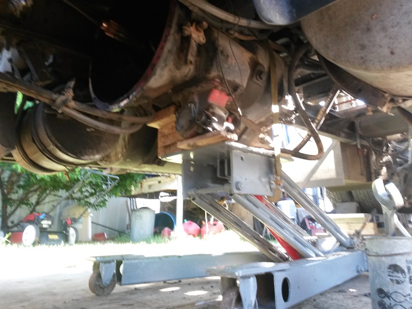

    Transmission out on the jack. It works like a charm was able to raise the transmission and the rear of the engine with it to lift above the rear mounts and add a support under the engine to hold it in place was probably having to lift at least 4000 lbs
    Due to there being a PTO mounted on the bottom of the transmission adjusting bolts were out of the question So I used my next favorite way of supporting things. Solid oak blocks then the transmission was strapped to the jack so it couldn't move
