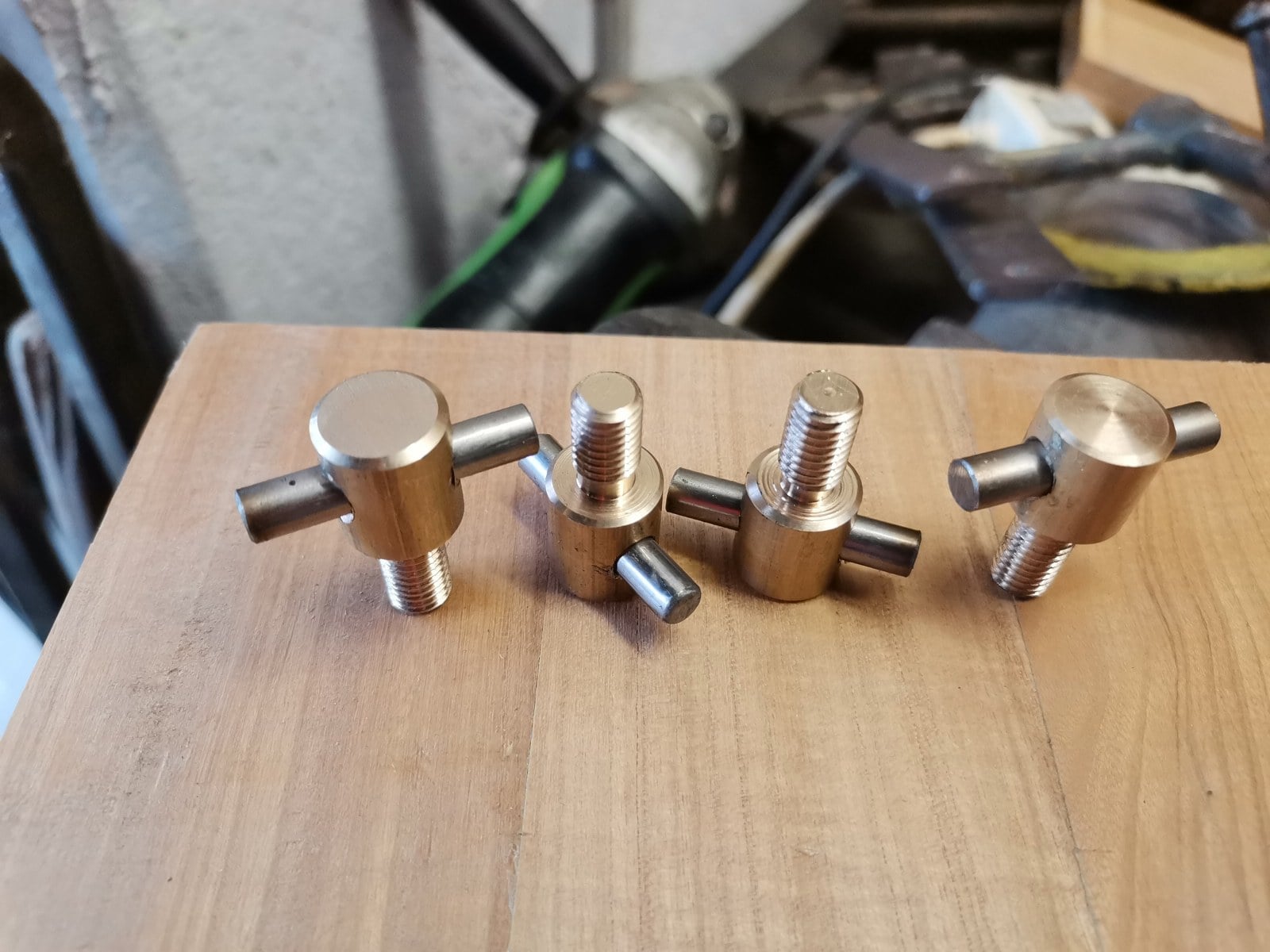

    Hi all
    I built some heavy duty knobs for binding post, inspired by the USSR dividing head I have. Quite an easy but effective design.
    The body is 14mm round brass, the lever is 316A 6mm. According to need the threaded part is M8.
    Attached Thumbnails Attached Thumbnails Heavy duty knobs-170093218_140350411357120_7125531218954504801_n.jpg
