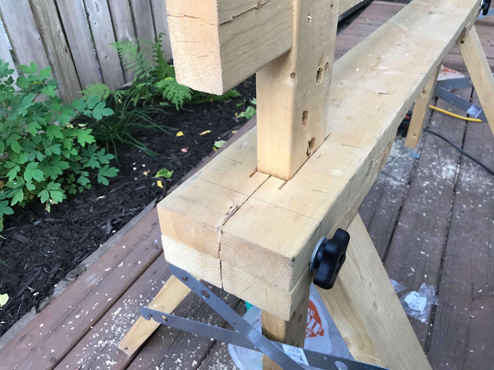

    Mortise dimensions?
    Quote Originally Posted by Keith William Knull View Post
    The adjustable upper frame is joined with half-lap joints and is tightly fitted in two mortises in the base and are held in position with carriage bolts in offset holes every 1 1/2".
    These bolts also secure the legs in the stowed position.
    The upper frame can be set on an angle to adjust for uneven terrain.
    What dimensions are your mortises if they are tight fitting, yet permit the top to be set to different angles as the terrain requires? I'm definitely going to build a set of these. Thanks!

    The mortises are tight fitting along the 3 1/2" faces of the 2x4 for lateral stability. The length of the mortise is approx. 4 inches, allowing 1/2" of play.
    *design modification*
    After leaving the horses in the rain, the wood swelled which made the height adjustment really stiff.
    So, I just made a relief cut through the end of the 2x6 to loosen the fit and added a* through bolt and knob to tighten as needed to retain lateral stability after adjustment.
    I think if you're using these outdoors, this mod is definitely required.
