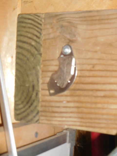

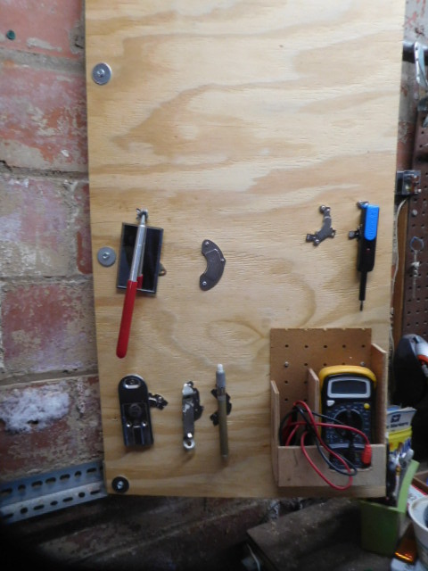

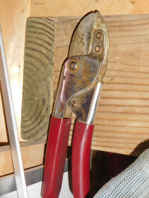

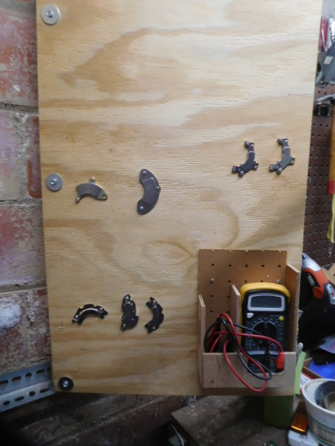

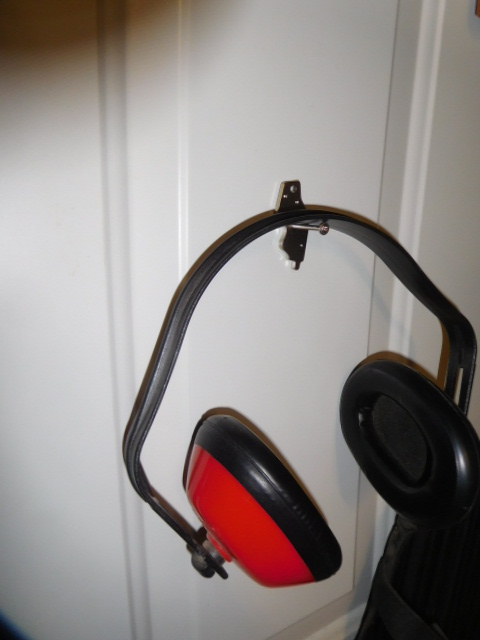

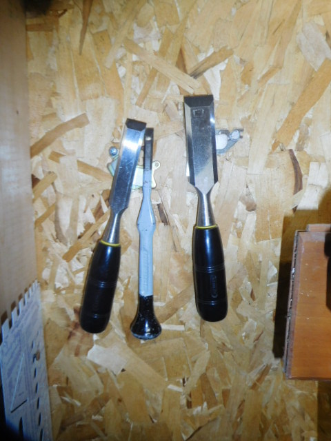

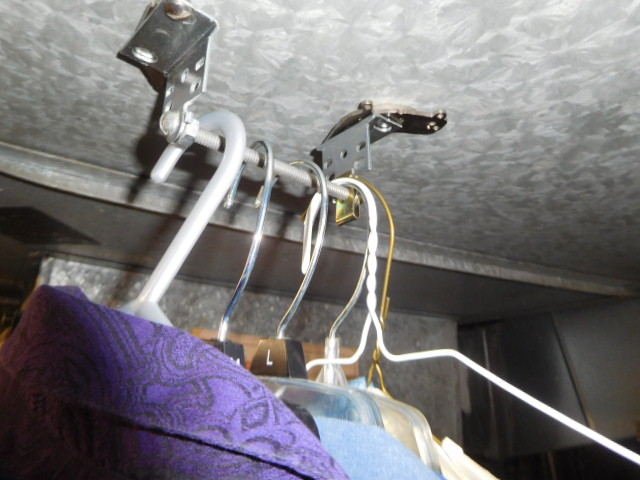

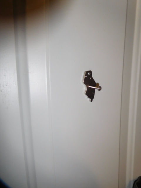

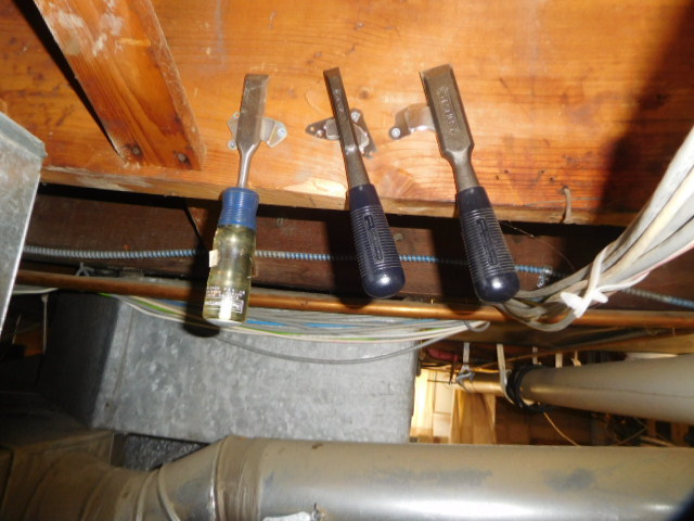

    I take computer hard drives apart and use the magnets for various purposes. I often leave the backer plate on as it allows me to mount it to wood with a screw.

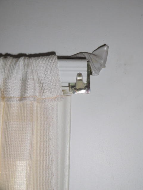

    Door Curtain.jpg - We have a metal door and I didn't want to drill holes to mount the curtain rod so I taped the brackets to magnets. The tape keeps the magnets from scratching the paint on the door.
    Clothes Hanger.jpg*– On the cold air return ductwork in the laundry area to hang up an item or two.

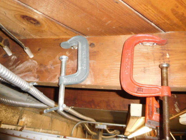

    C Clamp.jpg & House Chisels.jpg*– Attached to the underside of floor joist.
    Cord Keeper.jpg*– Attached to my table saw to keep cord off the floor and out of the way.

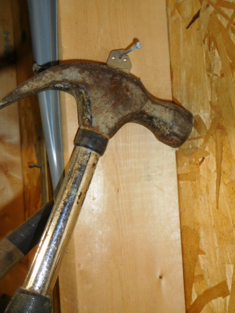

    Hammer.jpg*– Attached to the side of a garage stud
    Hard Drive Magnets-c-clamps.jpgHard Drive Magnets-clothes-hanger.jpgHard Drive Magnets-cord-keeper.jpgHard Drive Magnets-door-curtain.jpgHard Drive Magnets-garage-chisel-magnets.jpgHard Drive Magnets-garage-chisels.jpgHard Drive Magnets-hammer-magnet.jpgHard Drive Magnets-hammer.jpgHard Drive Magnets-house-chisels.jpgHard Drive Magnets-p-s-magnet.jpgHard Drive Magnets-pruning-shears.jpgHard Drive Magnets-tapped-magnet.jpgHard Drive Magnets-tapped.jpgHard Drive Magnets-tool-board-magnets.jpgHard Drive Magnets-tool-board.jpg
