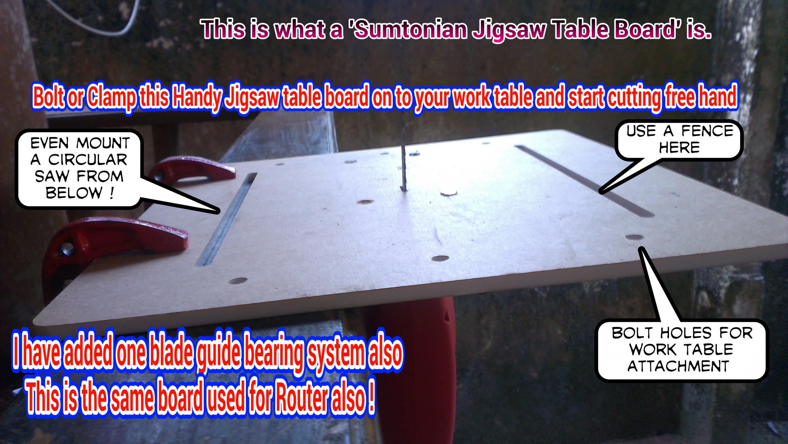

    A Handy Jigsaw Table Board
    A Handy Jigsaw Table Board-imag3014-picsay.jpg* * * * * * * * * * * * * * * * * * **

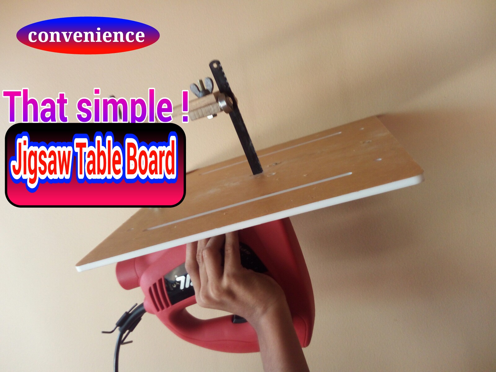

    Convert your corded Jig saw into a Scroll saw*
    *by this Board.
    *Turn Your Corded Dremel rotary tool into a Table mounted machine

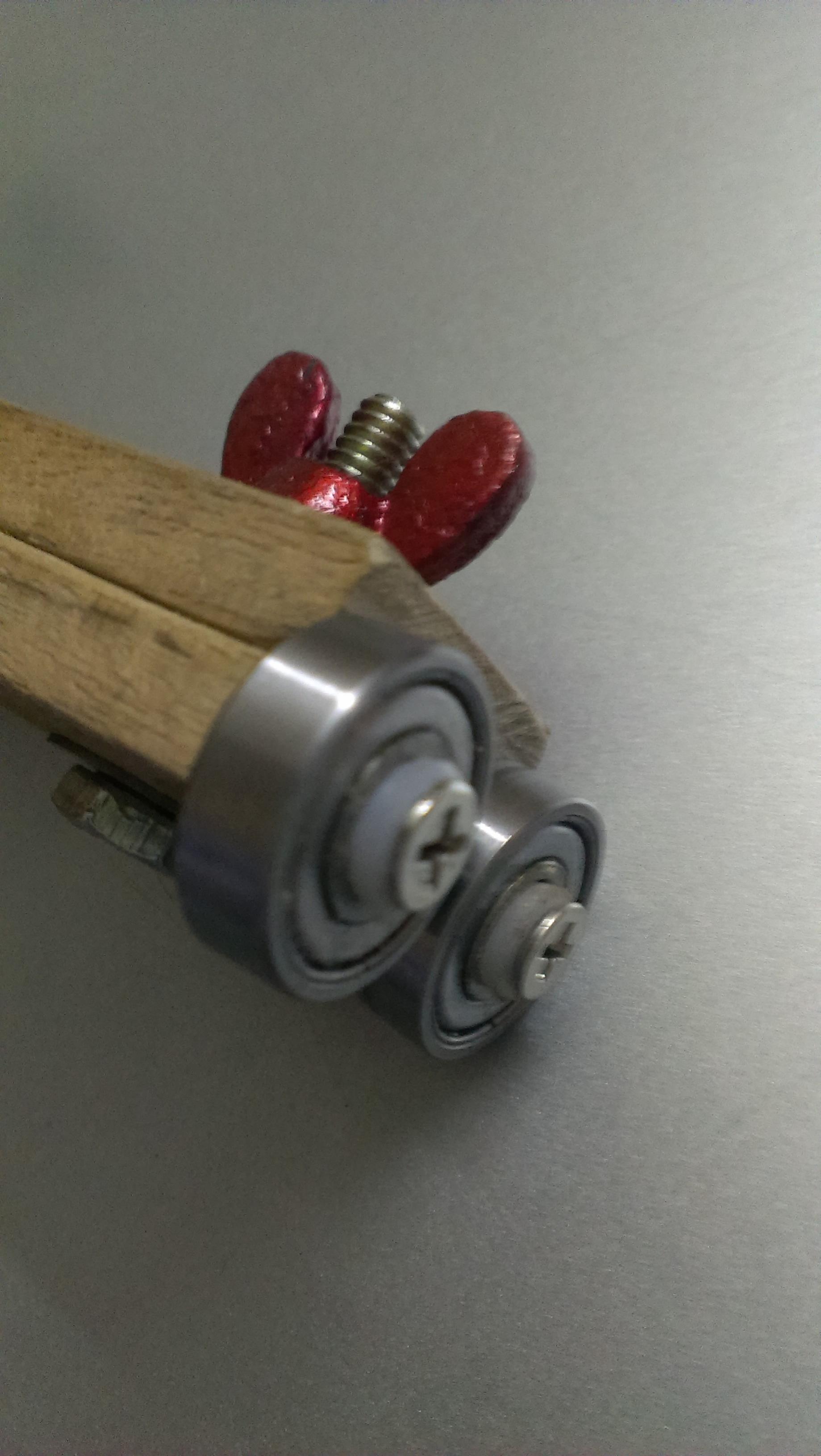

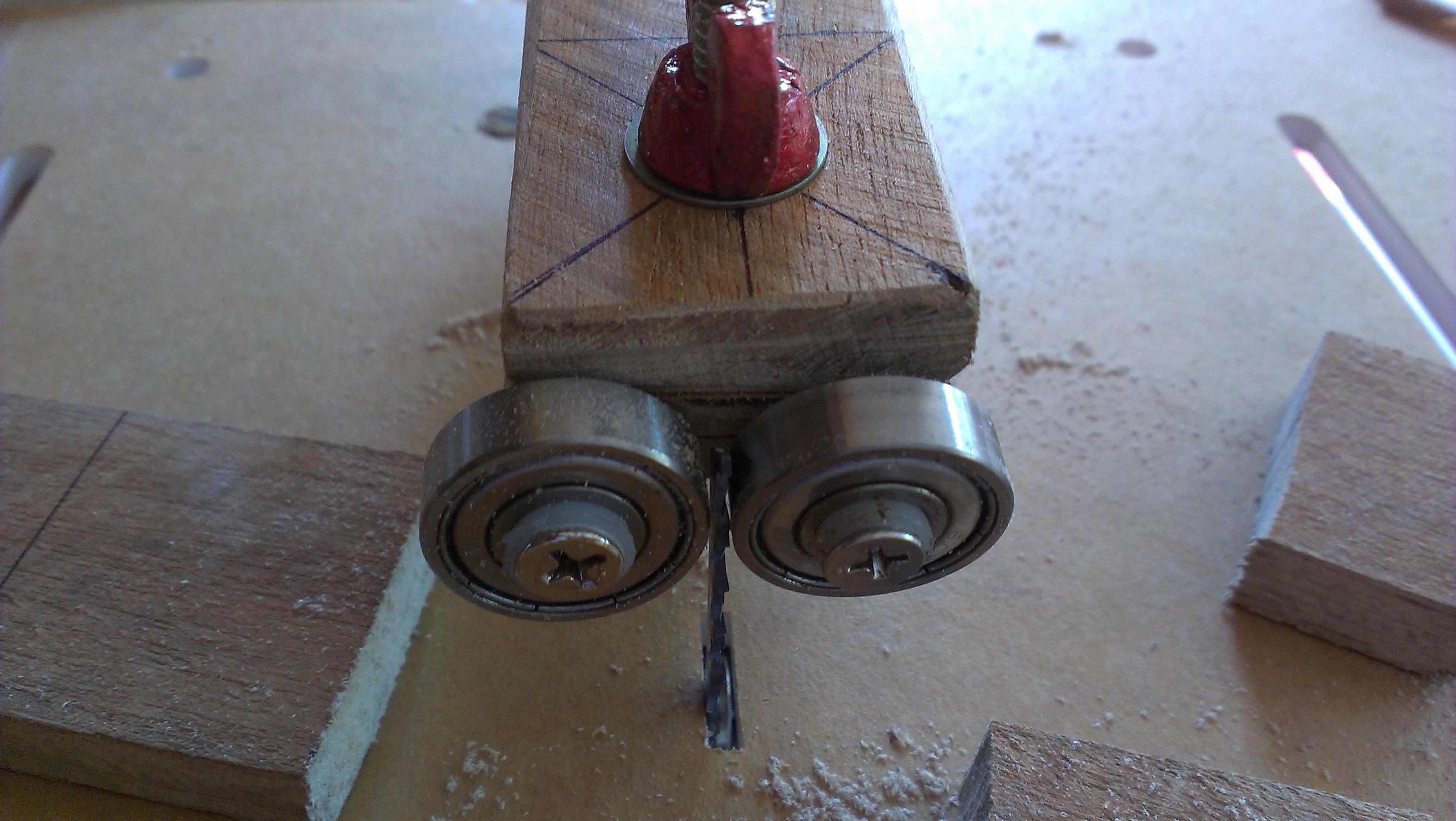

    I have added a Blade guide twin bearing system with post, arm and bearings see second photo
    A Handy Jigsaw Table Board-imag3178.jpgH

    Now very complete handy unit with modded 6 inch long Hacksaw blade.
