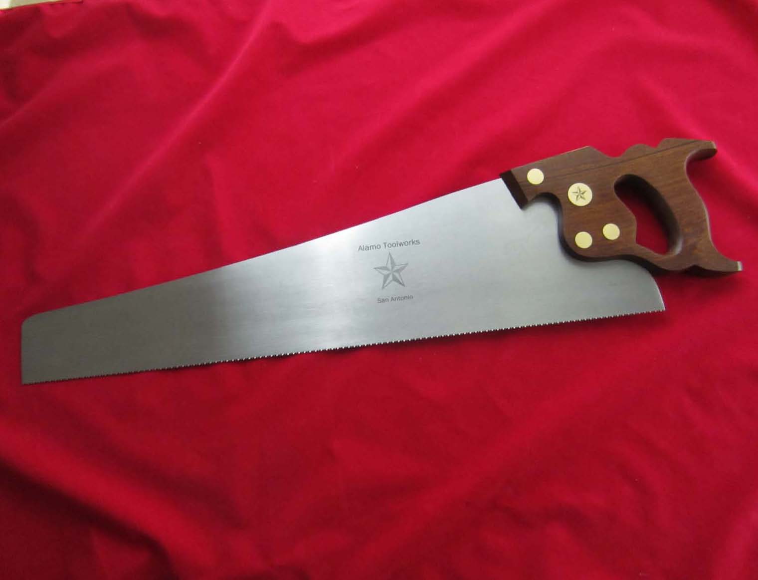

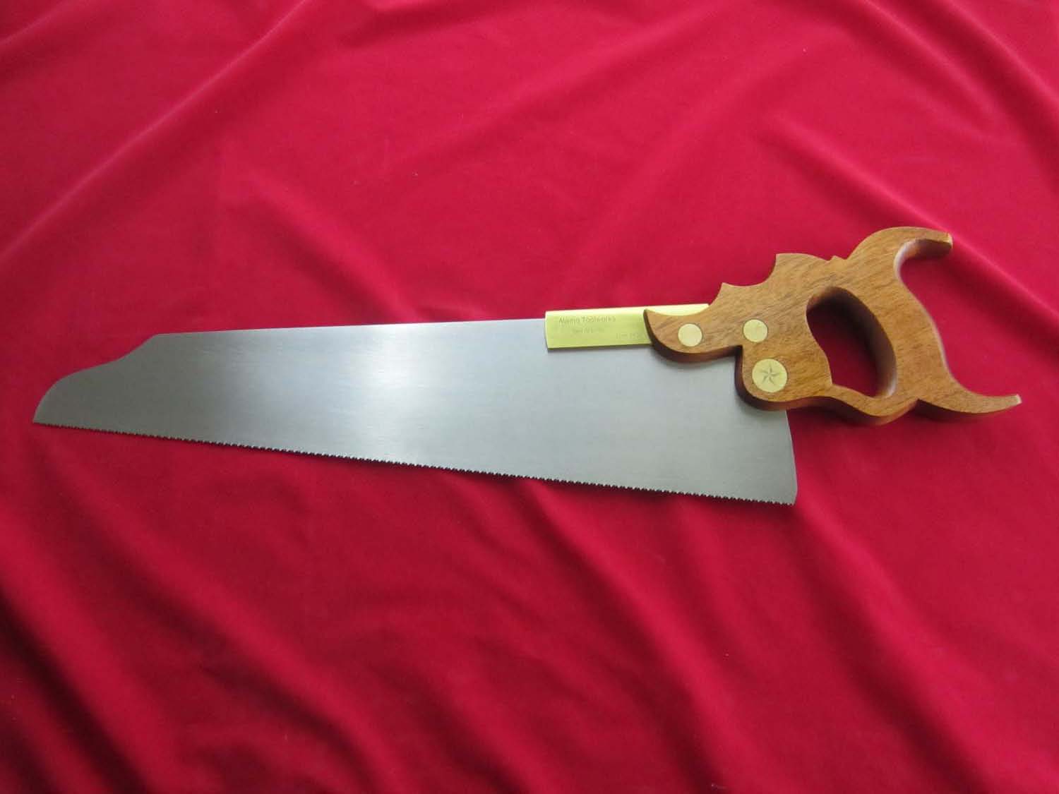

    Hi All,
    Been busy with lot's of other things but recently had some time to knock out a few saws. Here's some pic's.

    Hi Rob,
    Your saws look awesome.
    Would it be possible to make a dovetail saw with a pistol grip handle
    utilizing a fine-toothed japanese blade stiffened by folded brass.
    I find most of the dovetail saws on the market struggle with
    exotic hardwoods and my japanese saw, while very sharp
    and well able for the H/W , is a bit long and awkward.
    What do you think?

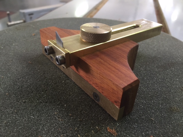

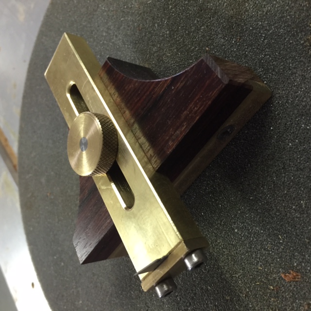

    Here's a couple of marking/cutting gauges I made recently for marking dovetail baselines.
    Hand saws that I build-img_3784.jpgHand saws that I build-img_3809.jpgClick image for larger version.

    Cheers,
    Brendan

    Hi Brendan,
    Great looking marking gauges.
