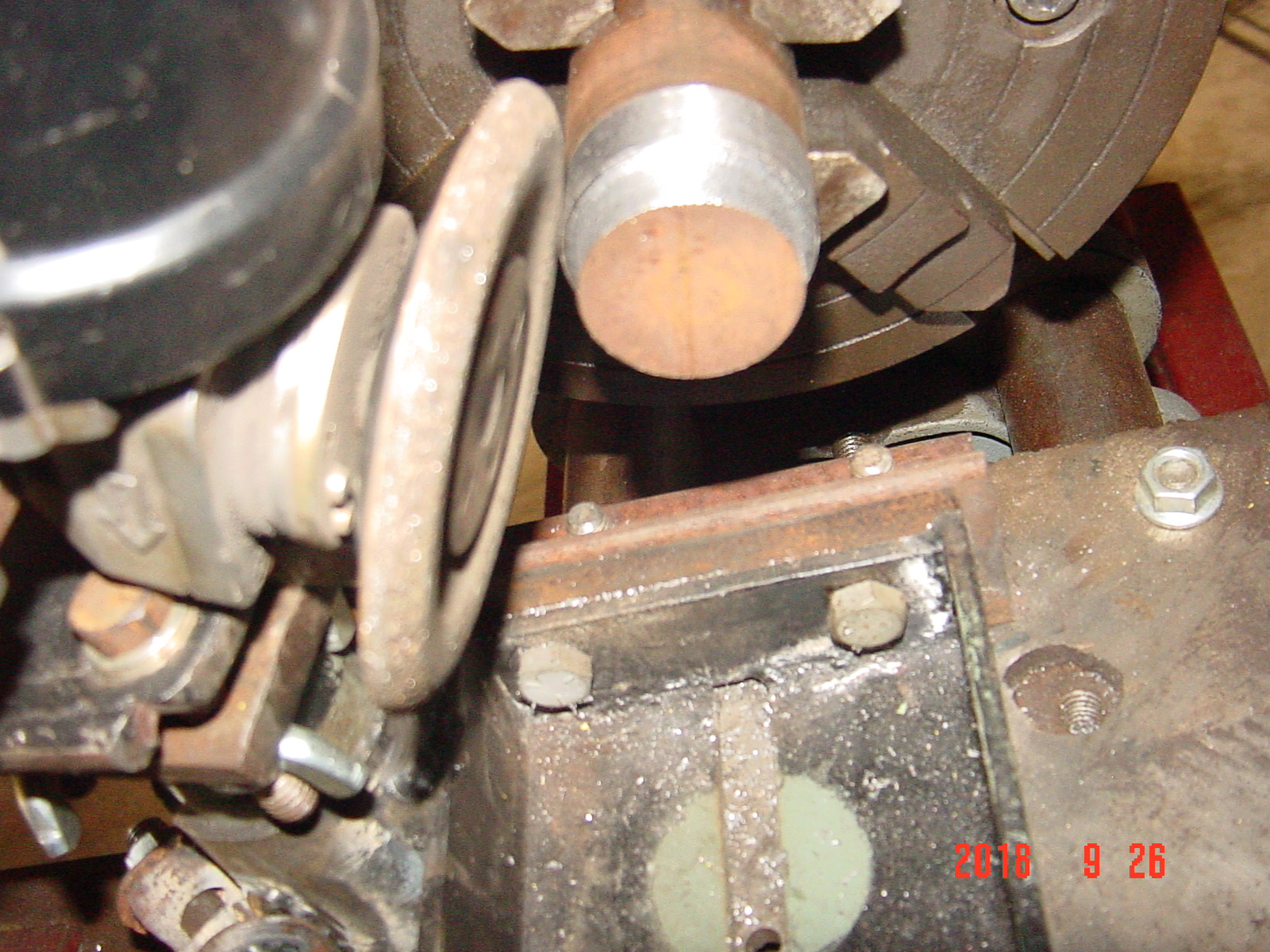

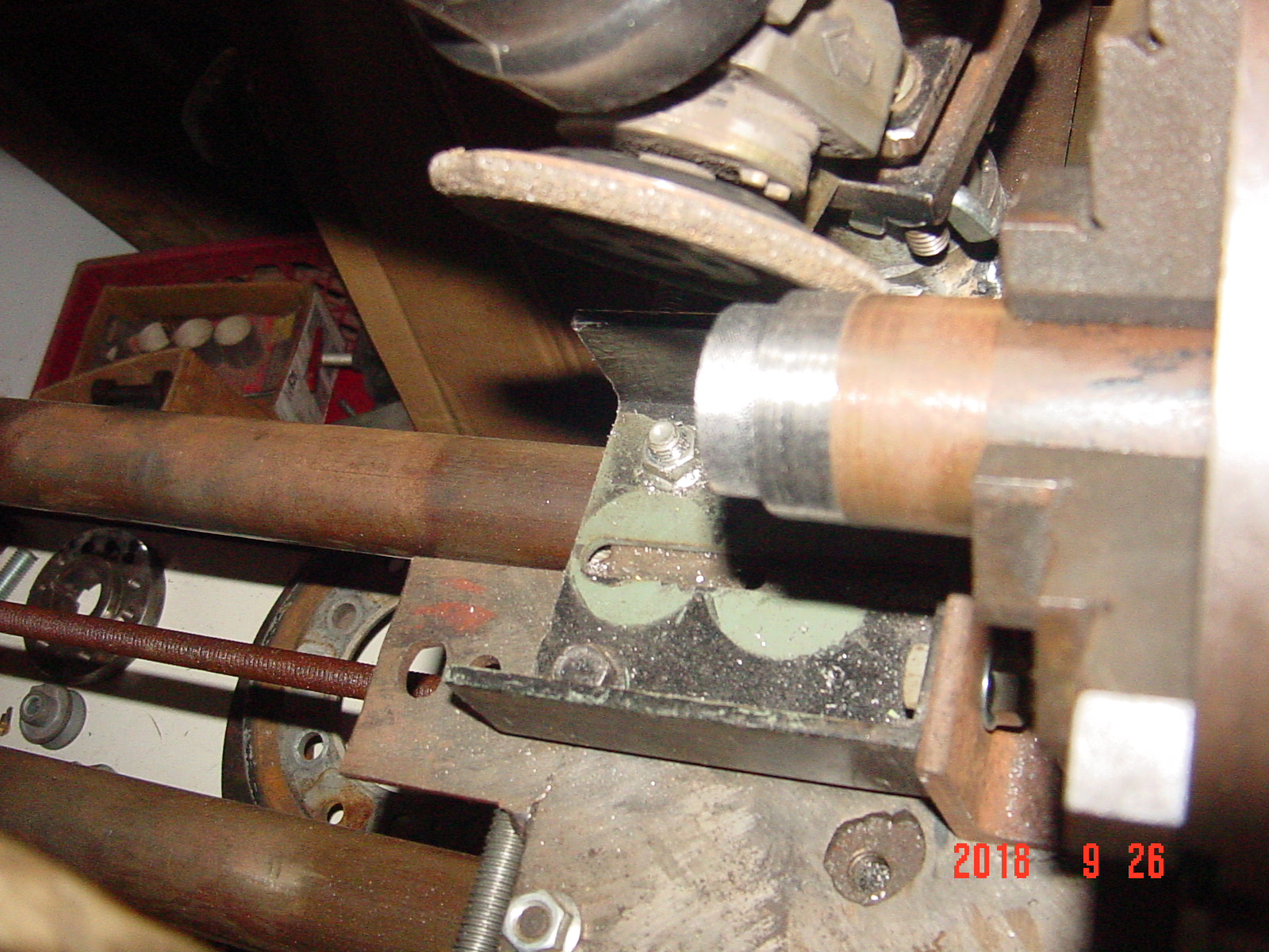

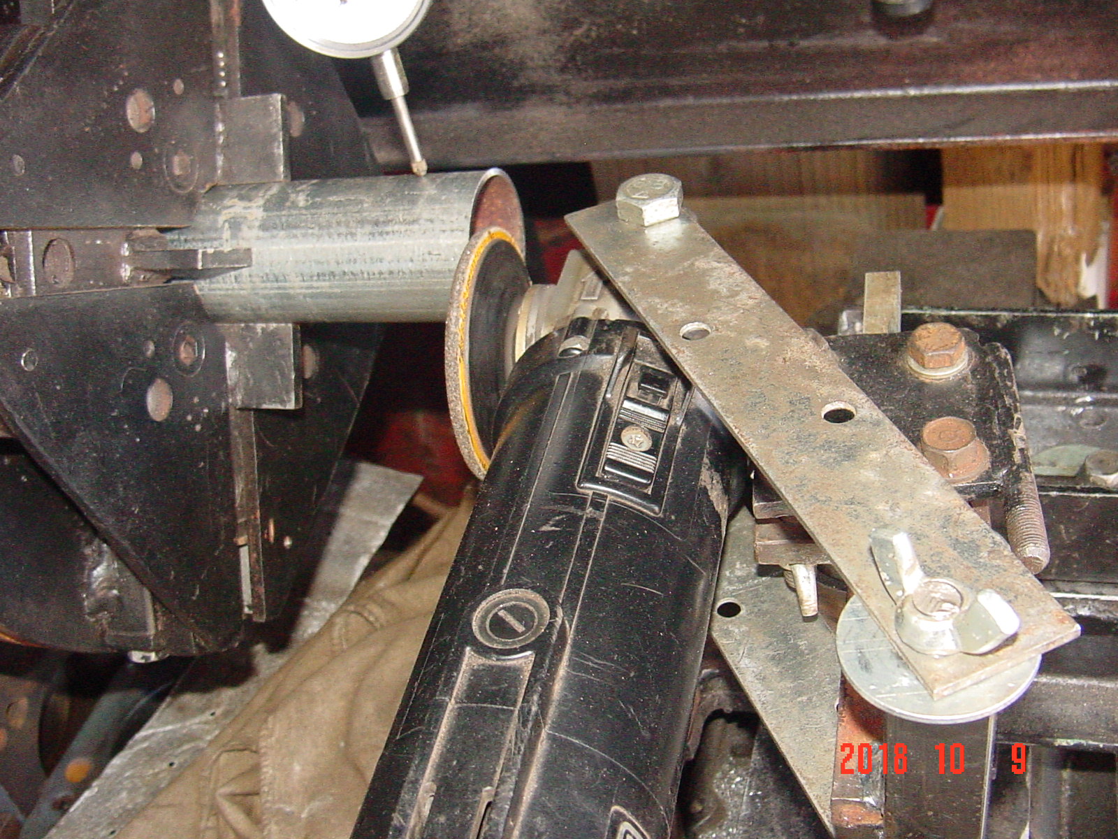

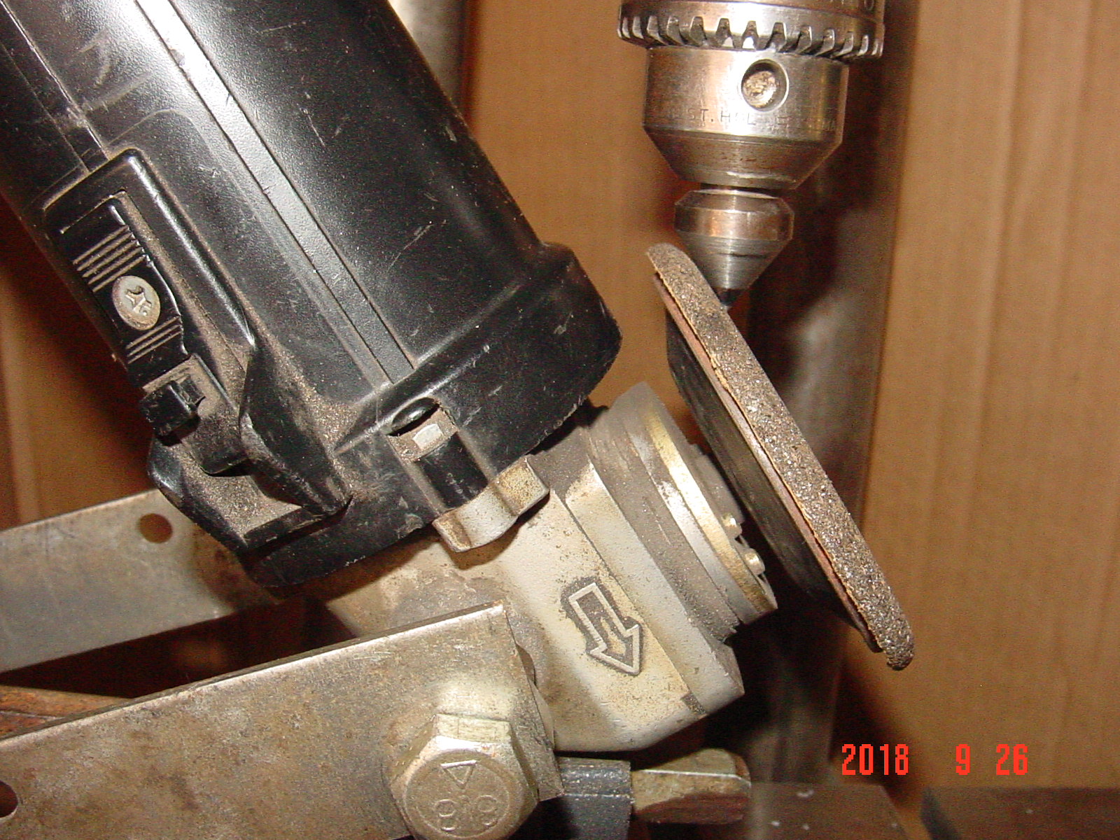

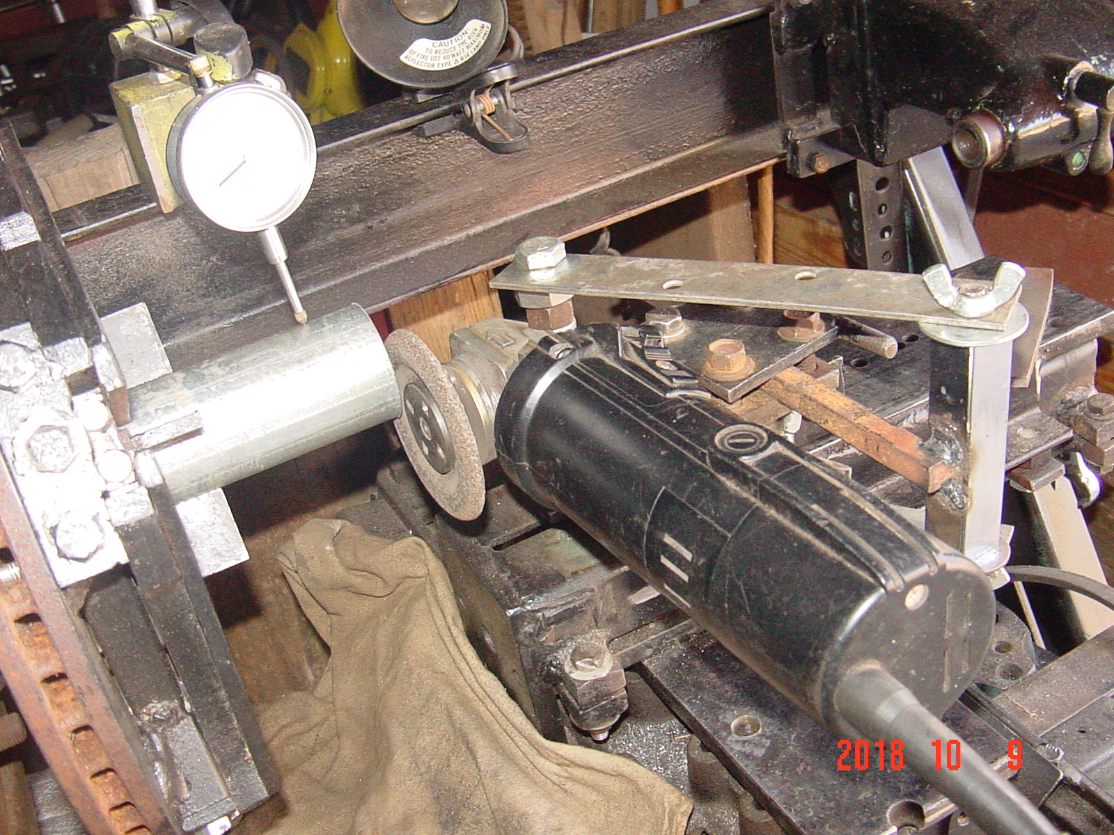

    Angle grinder tool post mount brackets.
    Enables you to mount an angle grinder to a lathe, drill press, or mill for accurate metal work.
    There are many types of disks available, enabling you to Grind,Cut,Sand & Polish.

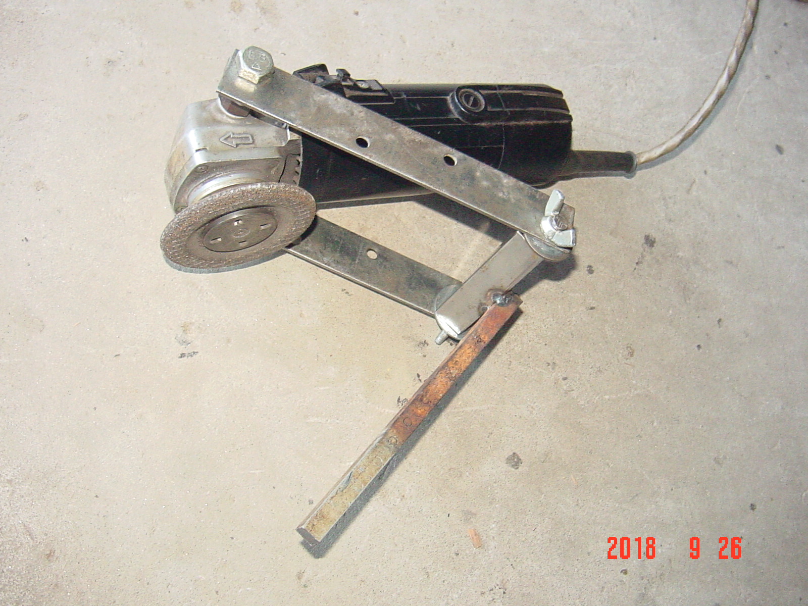

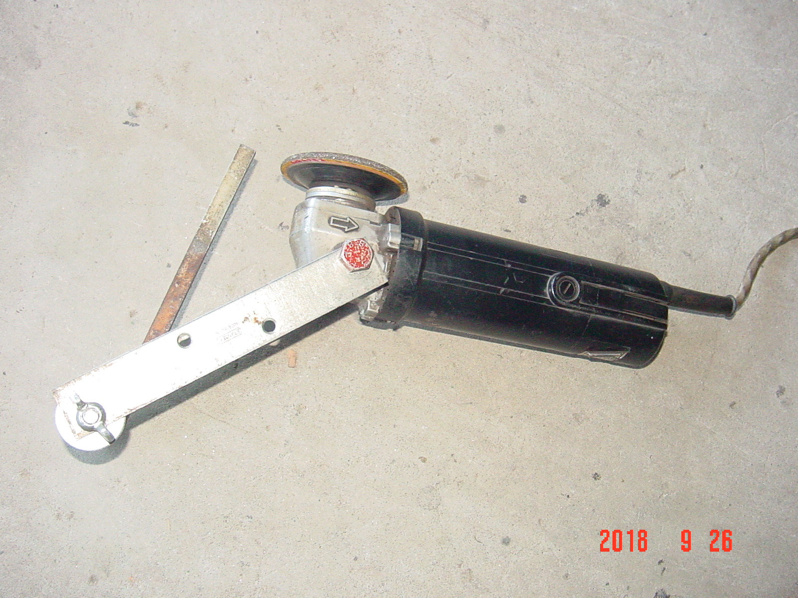

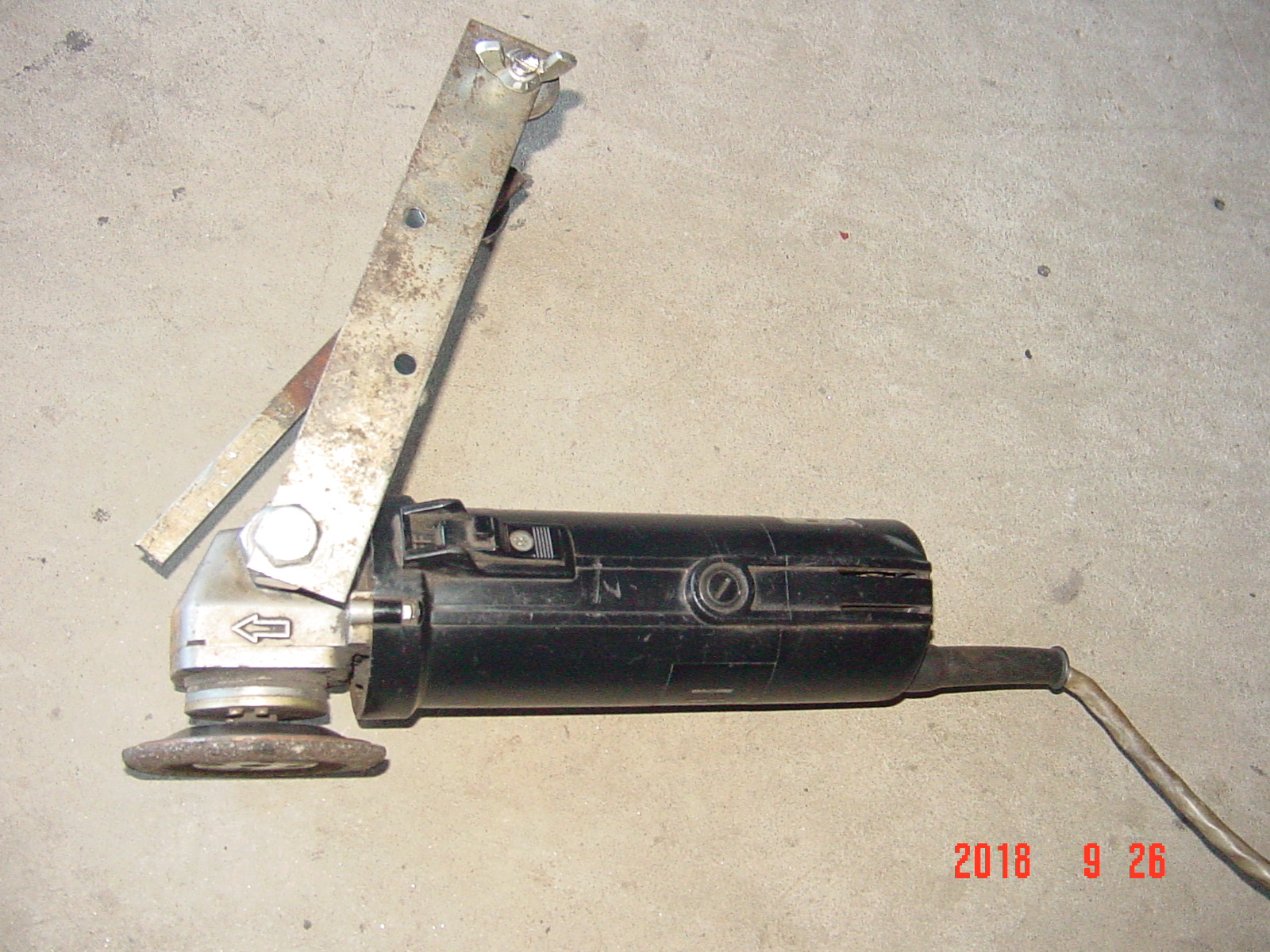

    This setup uses the grinder handle holes to locate the bracketry. The
    brackets consist of two pieces of flat stock, one piece of square tubing
    welded to one half inch square rod or keystock.

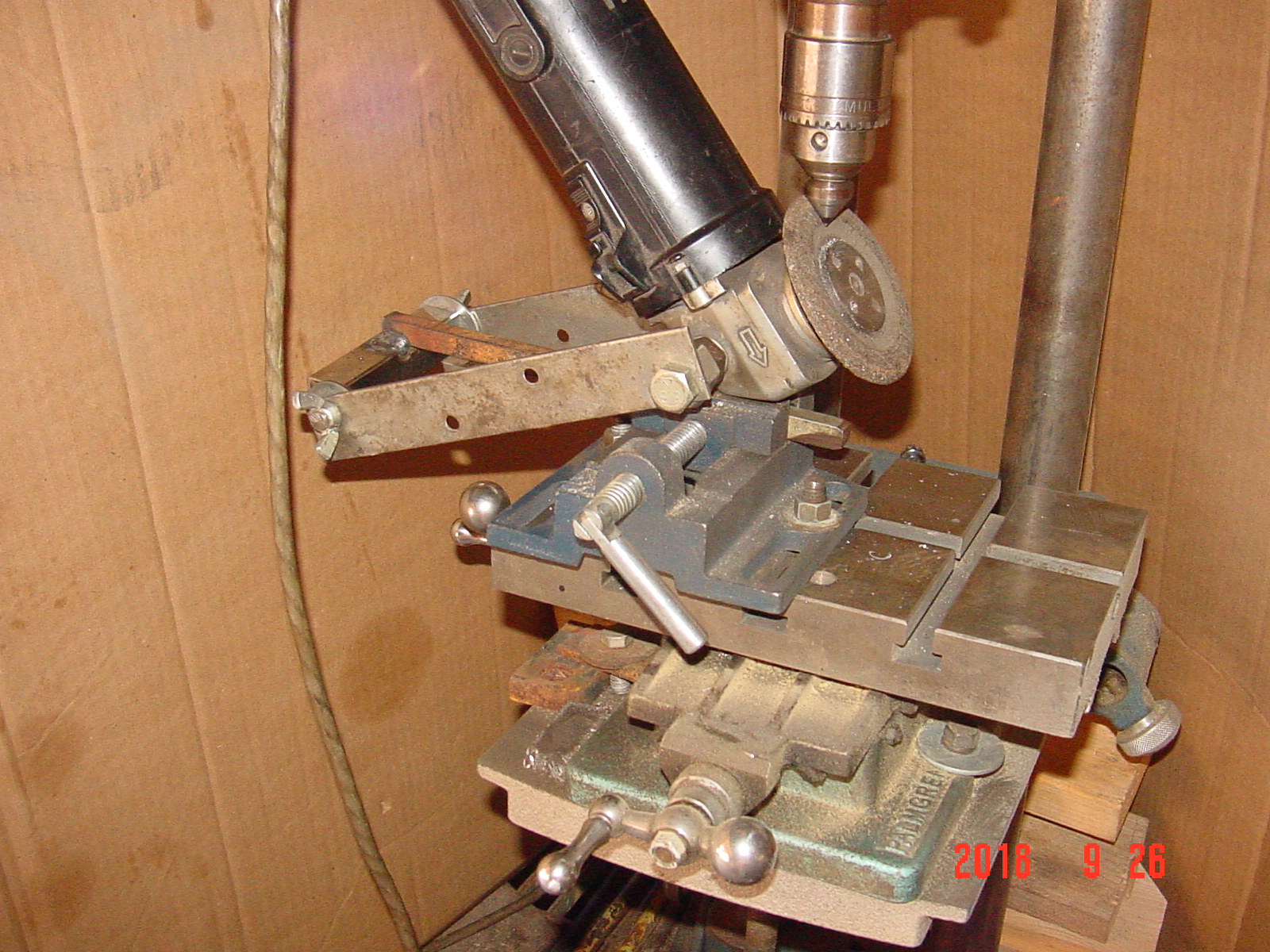

    1. Grinding a center point for a lathe on a Shopsmithdrill press using an XY table.

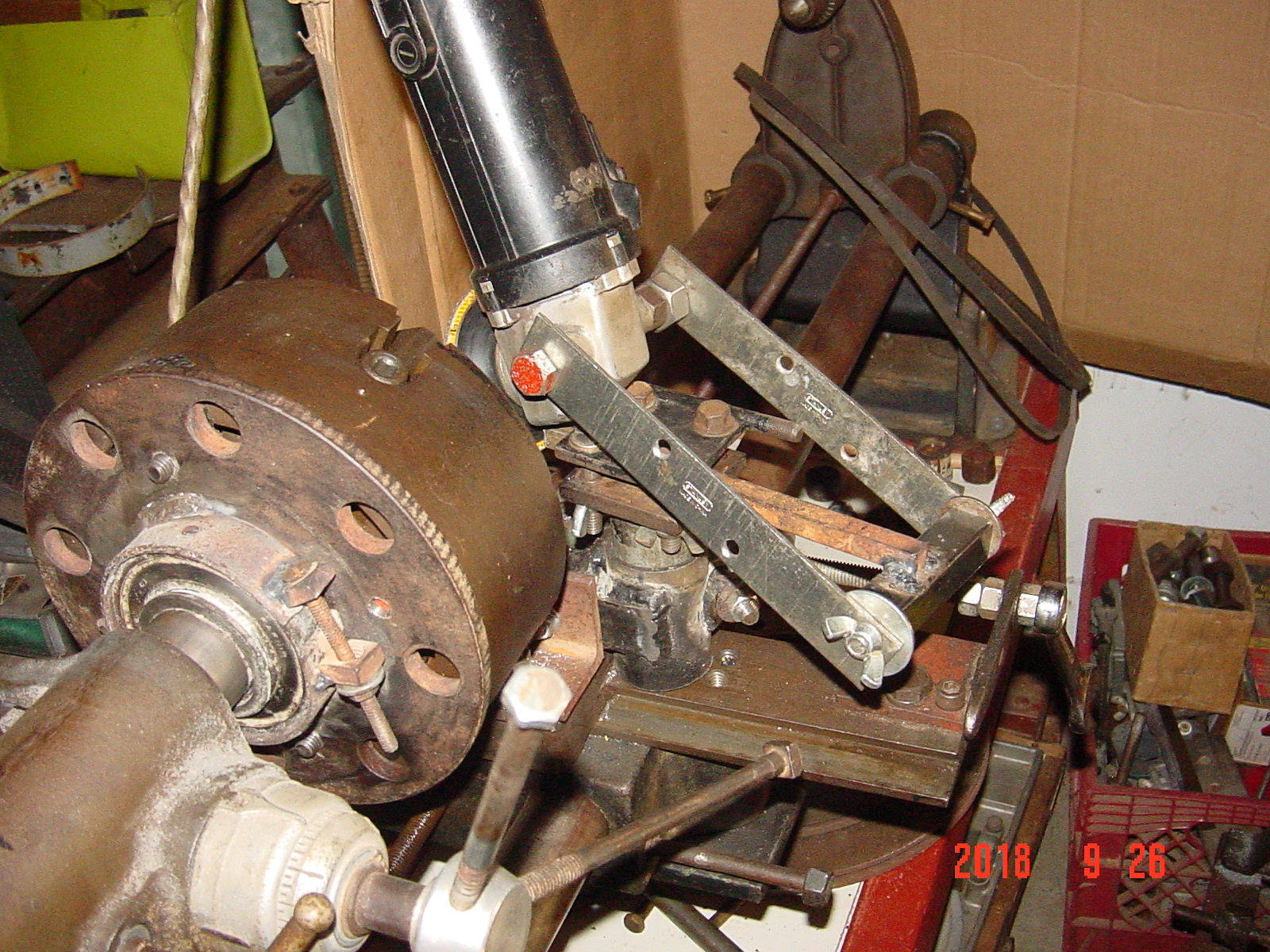

    2. Grinding round stock on a Shopsmith wood lathe that has been
    converted to a metal working lathe.
    3. Grinding the end of a tube squarely on my Homemade Metalworking Lathe.
    4. Grinder Brackets
    This grinder attachment works well for me to do finish work on lots of
    projects.
