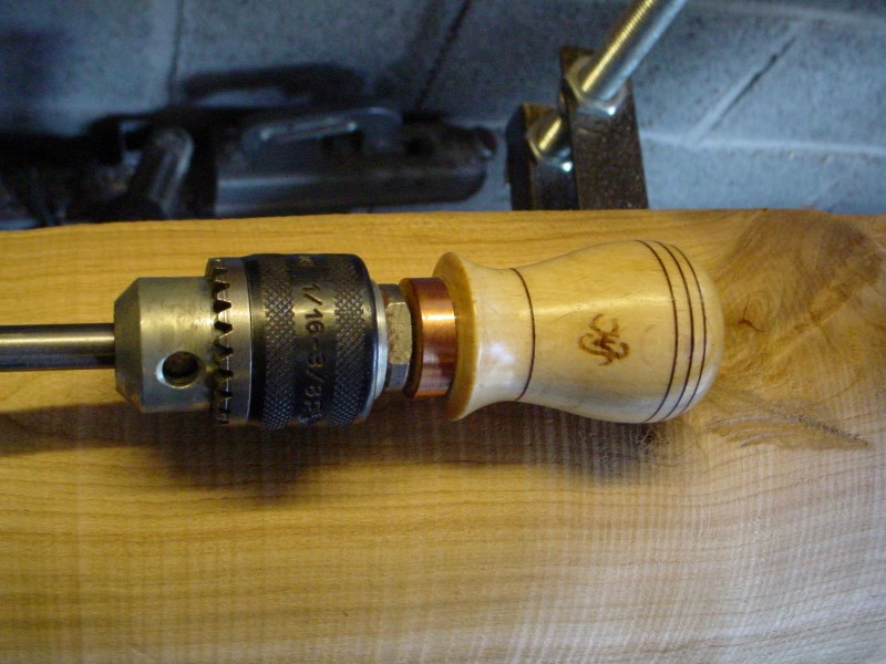

    Hello,
    This is my hand chuck, very handy for hand drilling, or deburring for instance.
    It is a 10mm chuck, with an SDS adaptator shaft.
    The handle is woodturned out of beech, and there is a set screw to hold the handle on the shaft.
    The screw just goes into one of the flutes of the SDS shaft.
    It can be used to hold whatever you want, it can be a tool like a bit, but also the work piece, for instance when grinding a round piece of HSS ...

    I love it! Solid, functional and charming!

    Thanks Christophe! I've added your Hand Chuck to our Drilling and Drill Presses category, as well as to your builder page: Christophe Mineau's Homemade Tools. Your receipt:

    Now THAT looks like something I have to make.
    Well done sir.

    Very nice. I have found that I need this on occasion, and this post certainly inspires me to make one.
