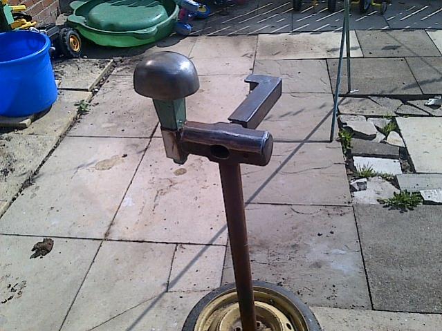

    hammerhead anvil/ domestake holder
    heres an anvil i made using old sledge hammer head that i welded to an offcut of steel tube then welded to old car wheel.
    ground radius on side of head for shaping metal on, on one end i welded pce of box sect to hold my domestakes.
    on back side i fitted some angle when i was makng up some corner brackets.hammerhead anvil/ domestake holder-phone-pics.jpg

    Very cool! Thanks.
