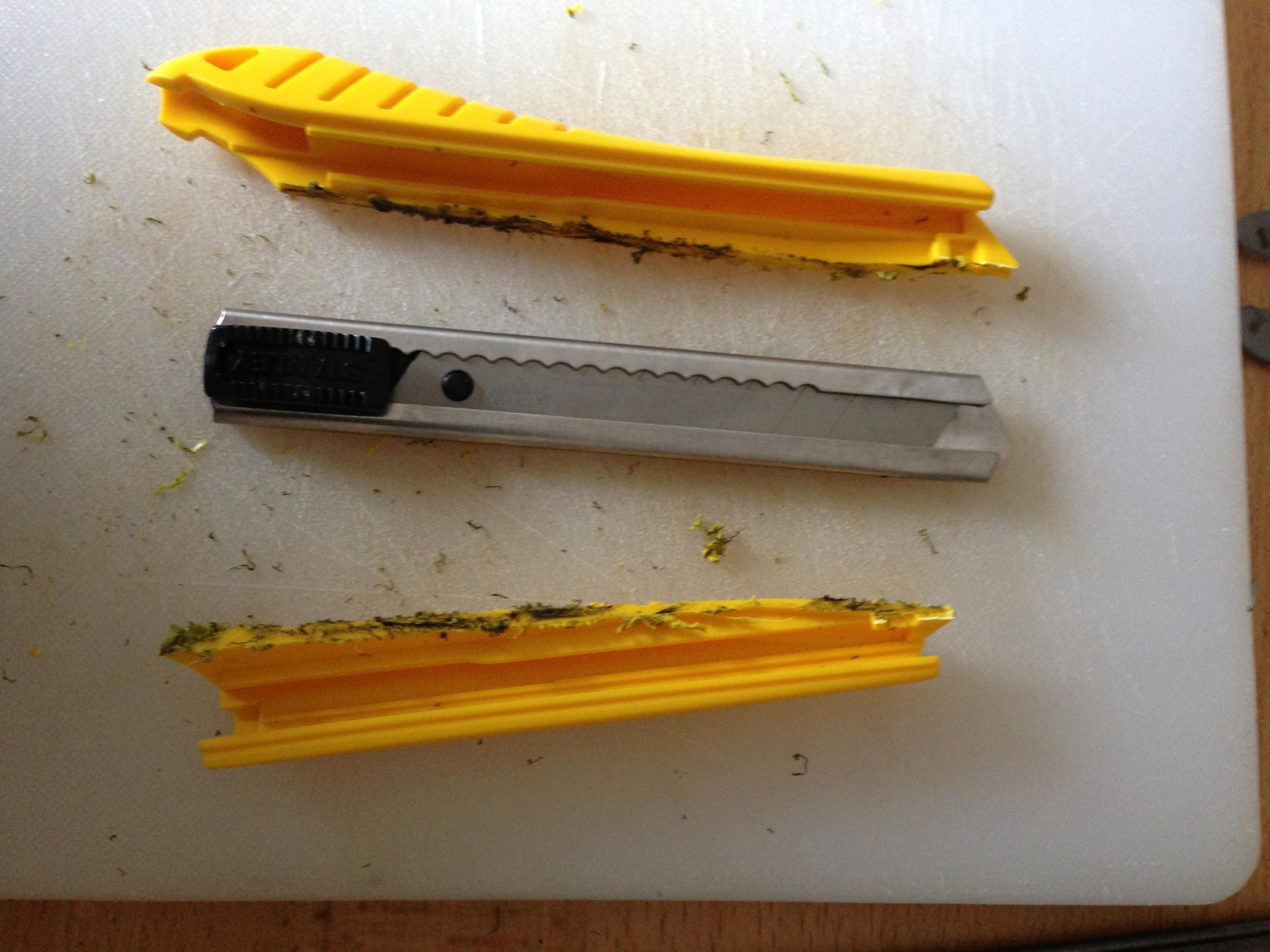

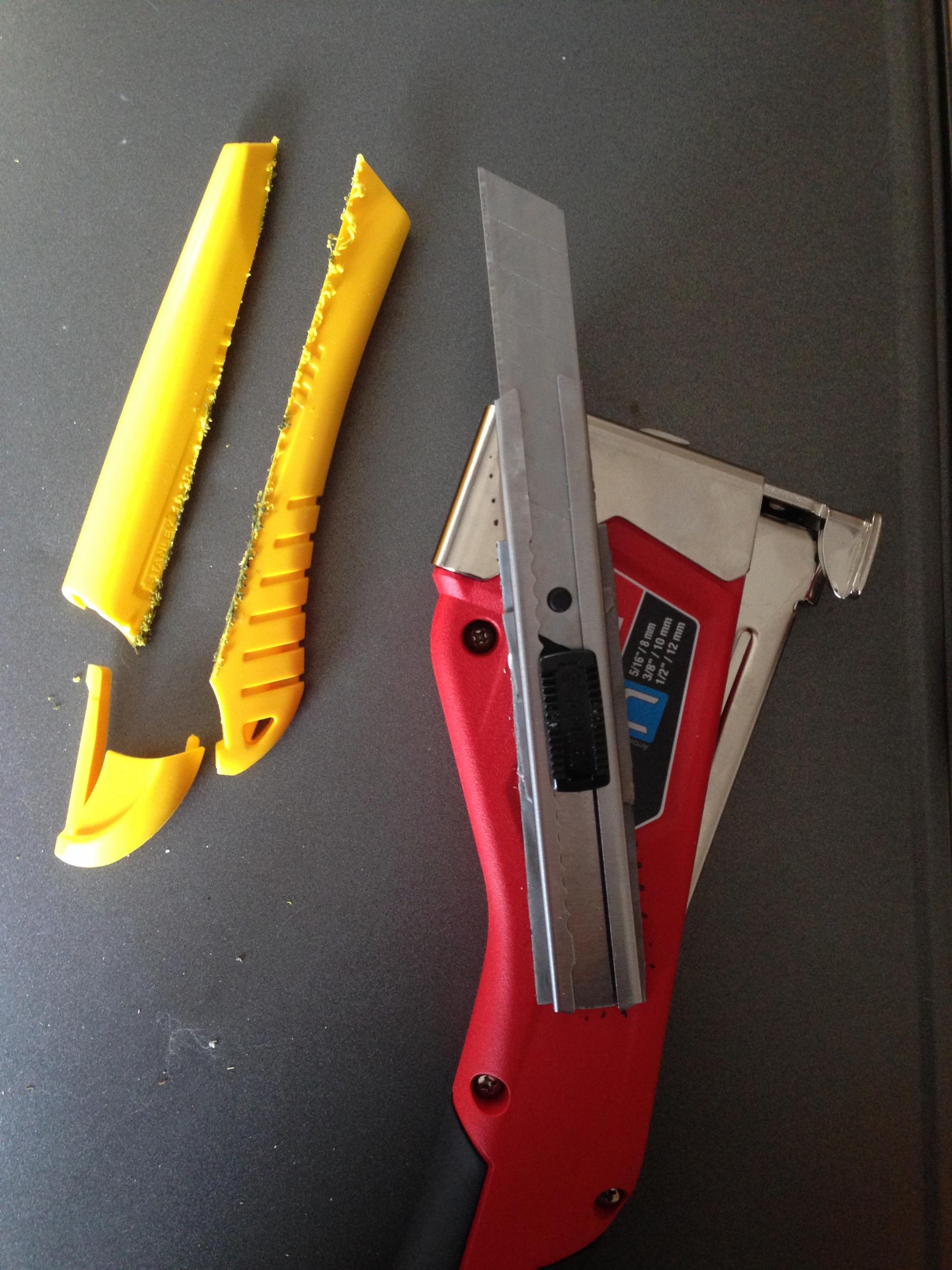

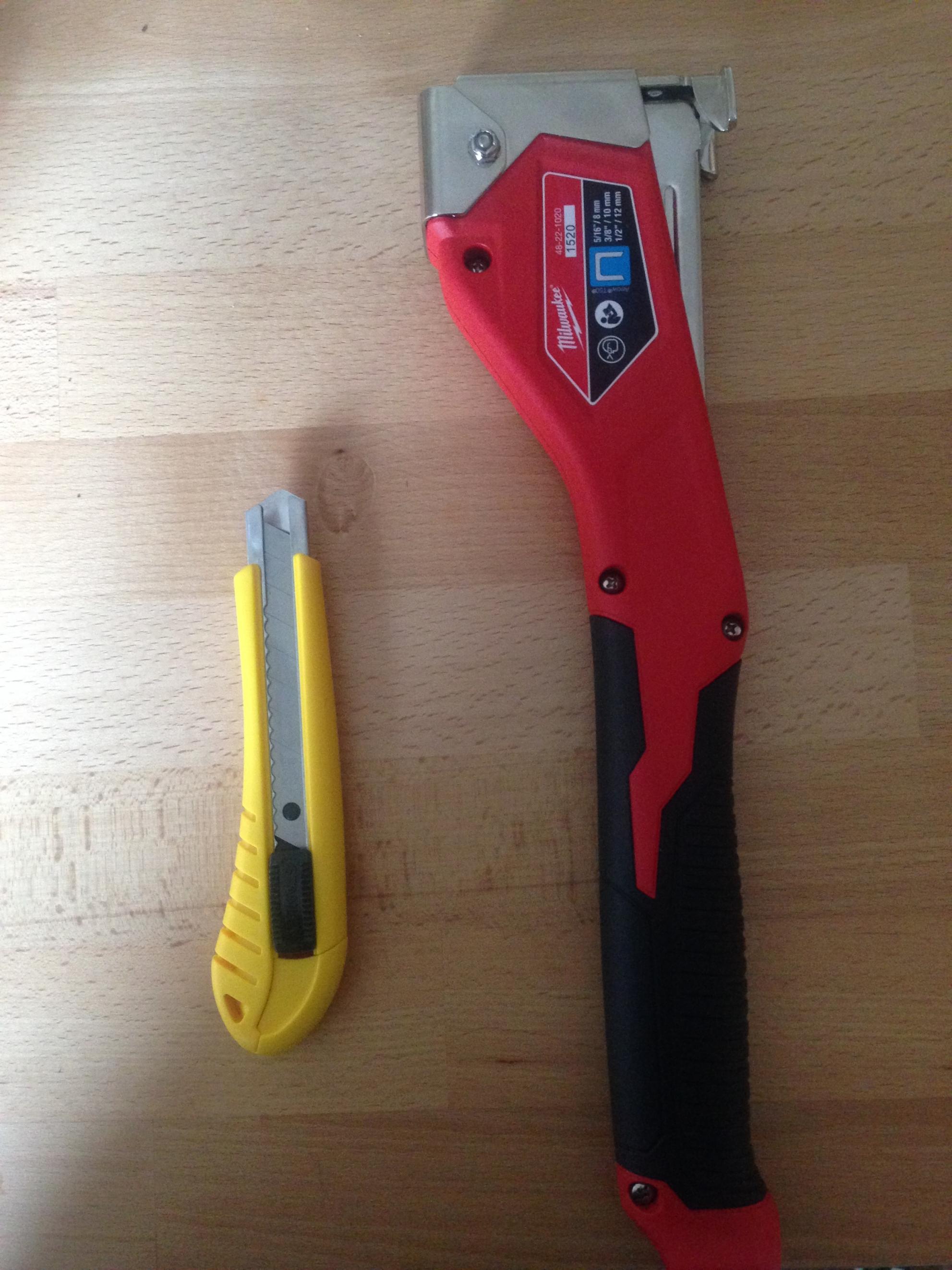

    I do a lot of building paper and rain screen application and had this idea when I was holding my razor knife and tacker in the same hand. I thought it would not only save a bit of time but also look pretty damned cool.
    Some say its dangerous due to the rearward facing blade , but my response to that is EVERY tool can be dangerous. I've been using this for years and still have one fully functioning eye.

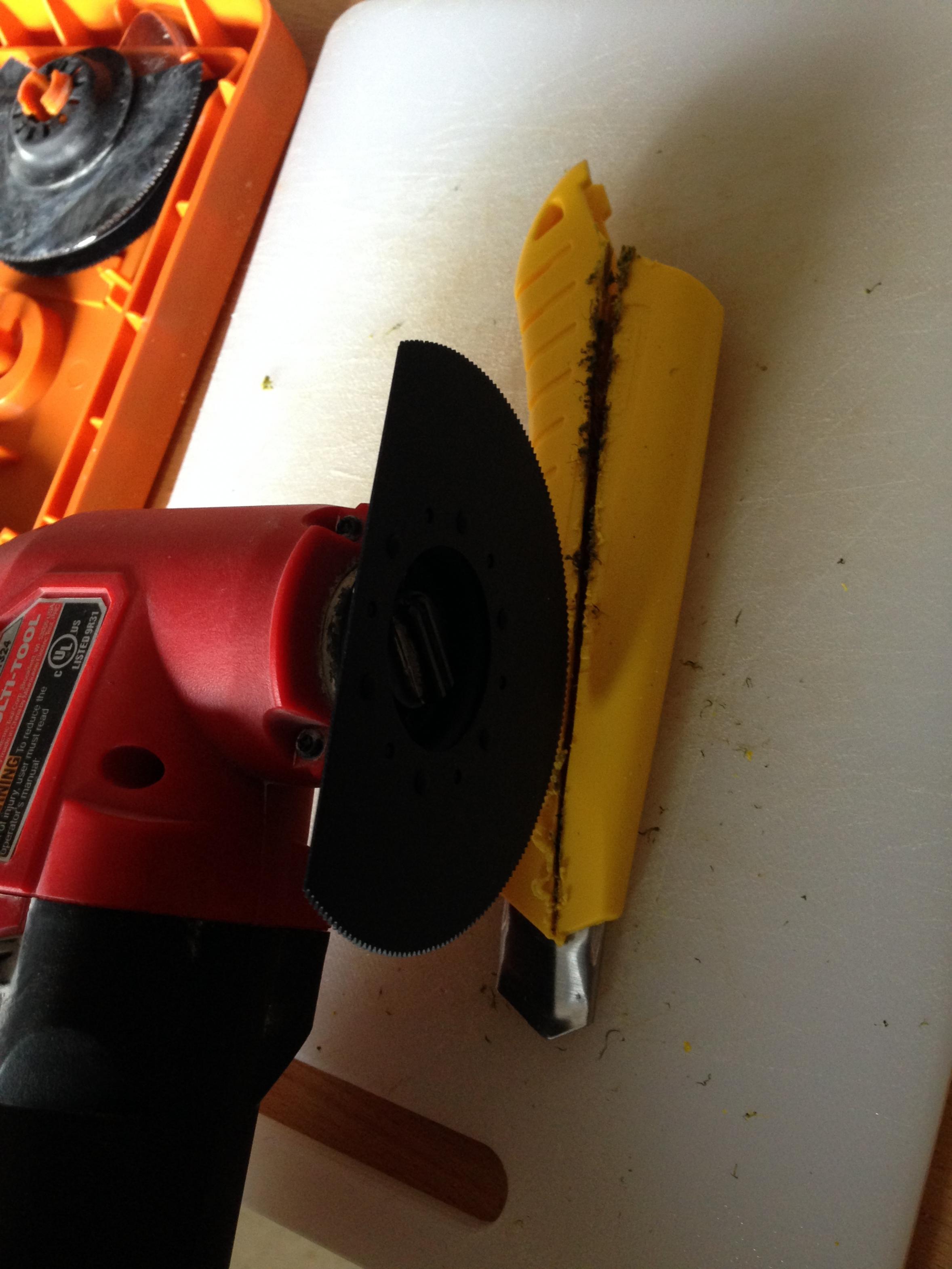

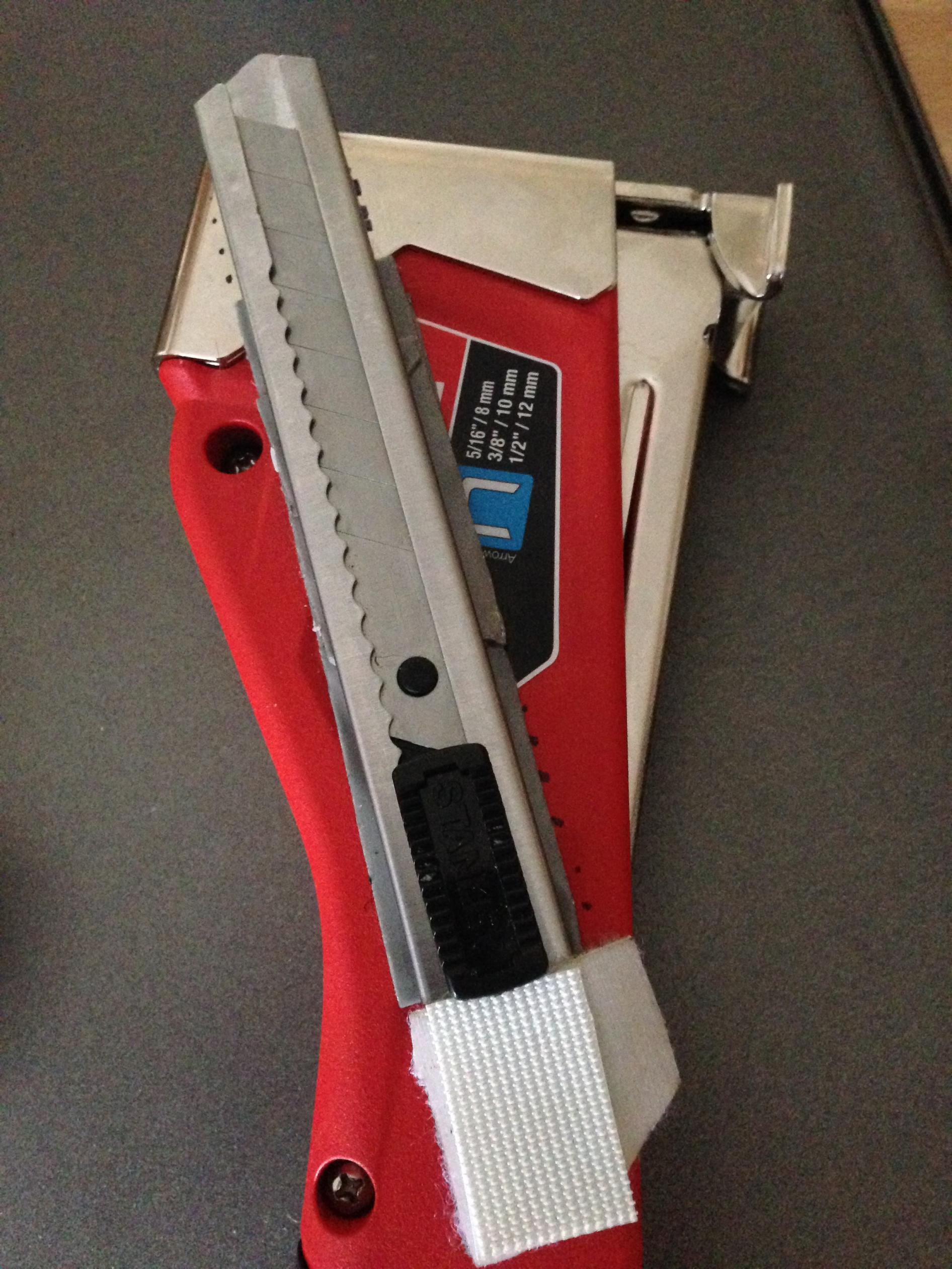

    The build is pretty simple: remove the plastic from the metal razor knife track, stick the track on the side of a stapler with the adhesive of your choosing (I used Scotch Extreme mounting tape). I also added a Velcro stopper to stop the blade from retracting too far and falling out.

    Just wanted to add that using a razor knife with a push button auto-lock (Stanley) is recommended due to the flat profile for ease of mounting and also its a lot easier to choke up on the handle and extend the blade with one hand.
