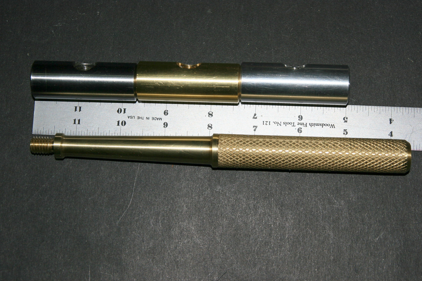

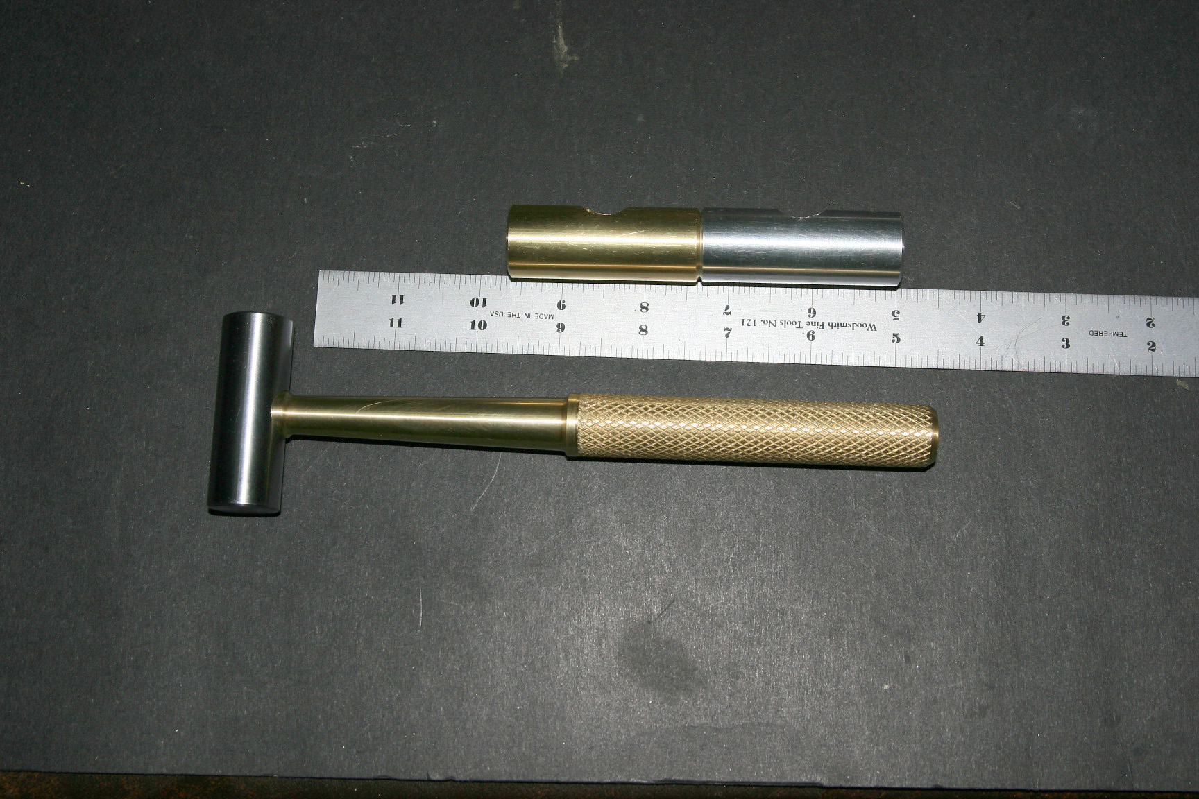

    I needed a few small hammers for my shop. My store bought ball peen hammer was
    a bit too heavy for light work as was the set of hammers I made a while back.
    http://www.homemadetools.net/forum/b...821#post105498
    http://www.homemadetools.net/forum/h...820#post105496
    http://www.homemadetools.net/forum/s...822#post105499
    I was targeting 8 oz for the heaviest and ended up with 6.5 ounce for the brass head.
    The handle is shorter than my earlier hammers but still has considerable weight.
    Handle was turned from 3/4 brass and the heads are all turned down to 7/8".
    The heads are 2.250" long. They feel pretty good and I think they will work out fine.
    One brass, one aluminum, and one steel. Only one handle was made which saves some
    space in my tool box. The thread is 3/8-16 so that handles and heads may be exchanged
    between most of my shop made hammers.
    I think I have hammers covered!
    Cheers, JR
