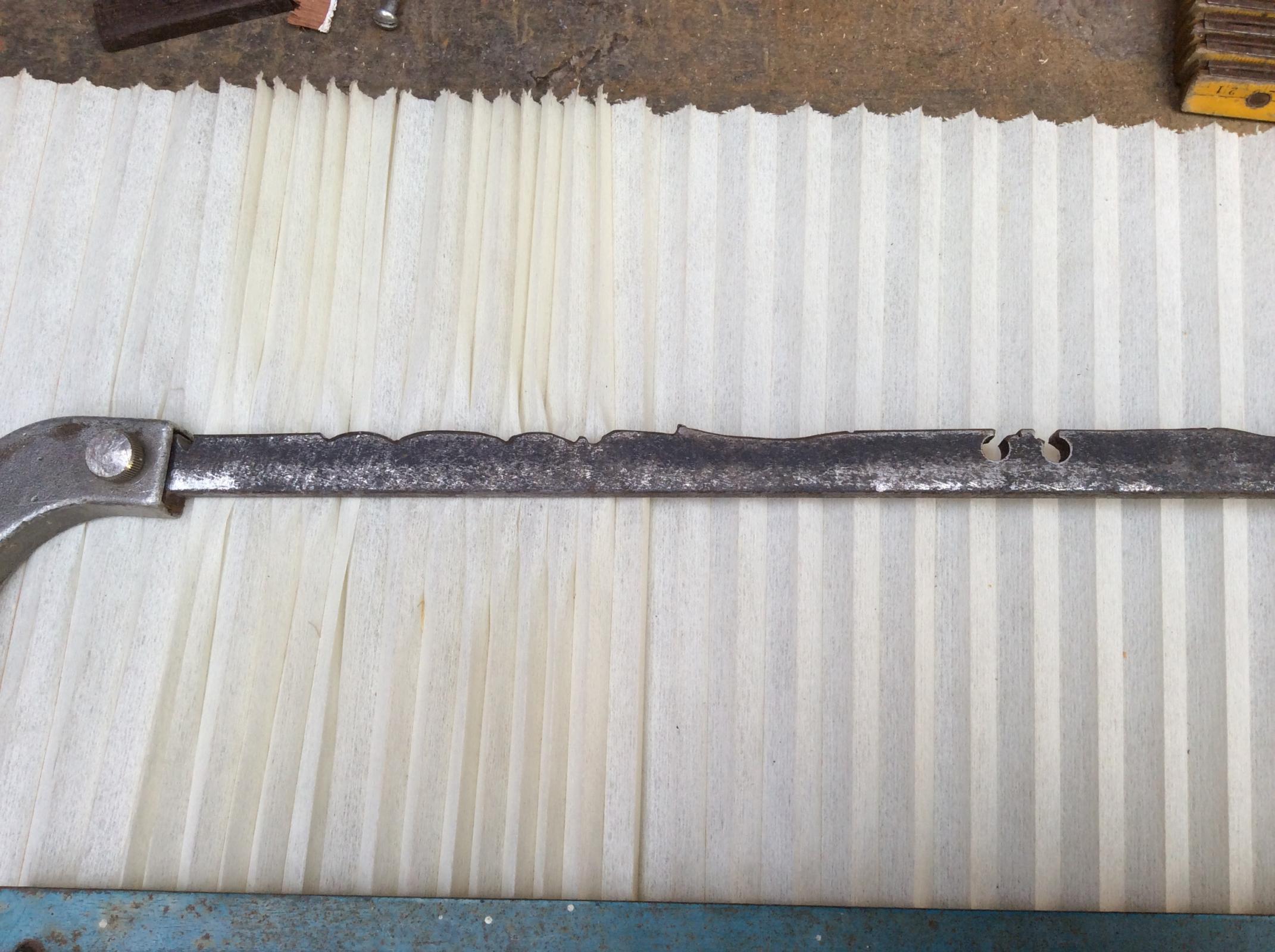

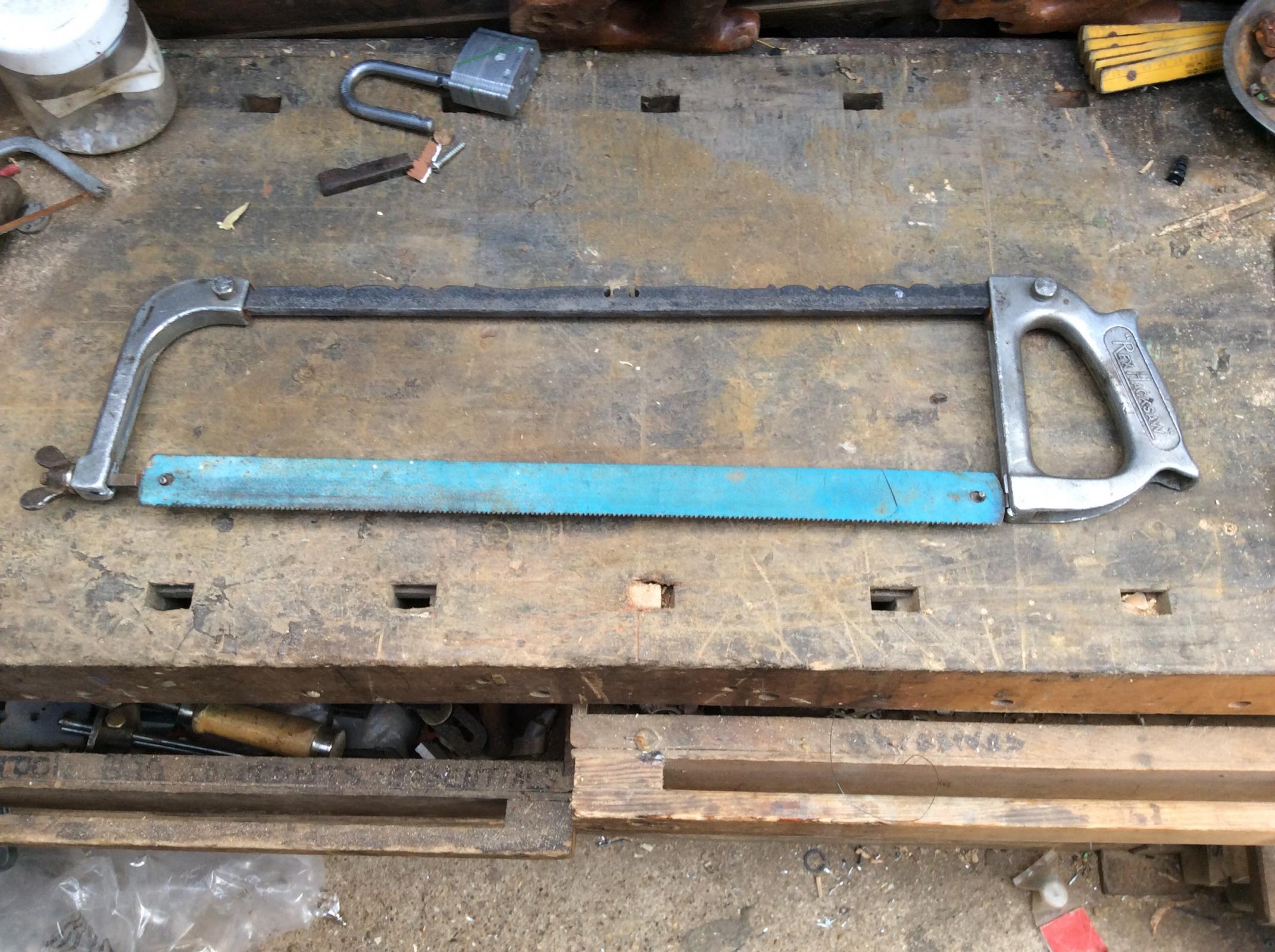

    I thought that I might as well utilise some of the machine hacksaw blades I have (all gifted, although I have no machine). When filing out a lot of material, I first drill out much of the waste, then hacksaw conventionally, and then I like to widen the cuts, before starting with a file, and for me, I would rather have an 18 inch blade than a 12” or 10”, because then, there are fewer strokes.
    A bit of crude ornamentation was needed to disguise the fact that the arm was a jagged edge offcut.
