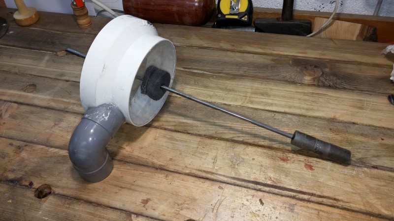

    In addition to the previous post, what is still needed is a chip collector to collect all the small chips that would get otherwise propelled at high speed throughout the shop.
    Here is my solution :
    It's basically made out of PVC and acrylic scraps I found around the shop.
    A PVC pipe reducer, a PVC 40mm elbow, a piece of transparent acrylic (very useful to see what happens behind), and a piece of foam to make a joint with the drill bit.
    This collector is installed against the steady rest, I use some straps of of inner tube rubber for that.

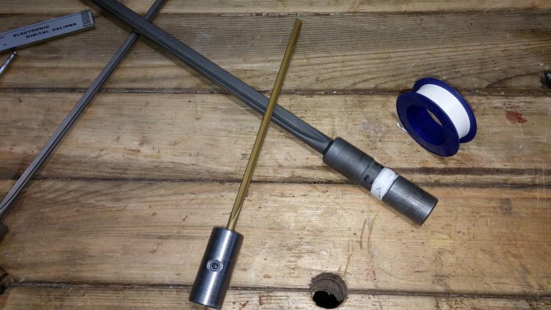

    Last addition is a bit of silicon tape that must be wrapped arount the shank of the bit to avoid any air leakage :
    On the small yellow gundrill, you can see a sleeve with a set screw that I turned up to adapt the 10mm diameter that had this particular drill to the 19mm of my gundrill holder.
