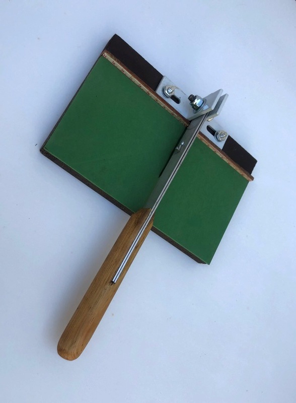

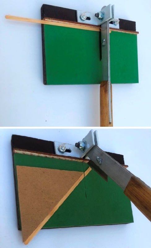

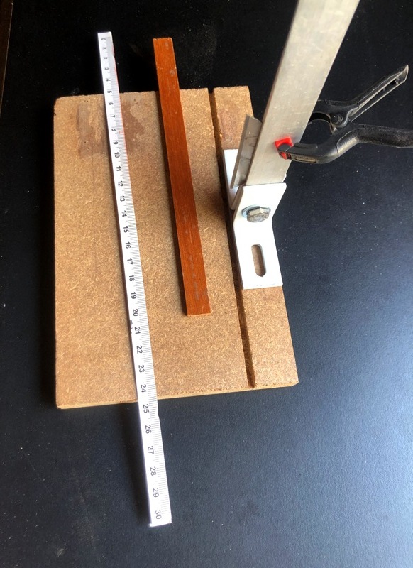

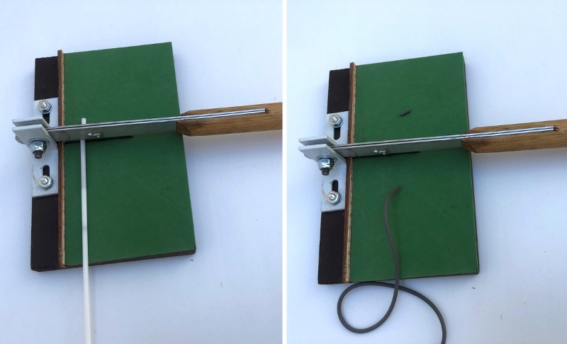

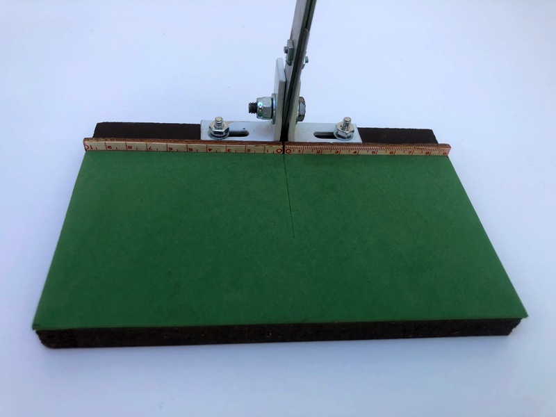

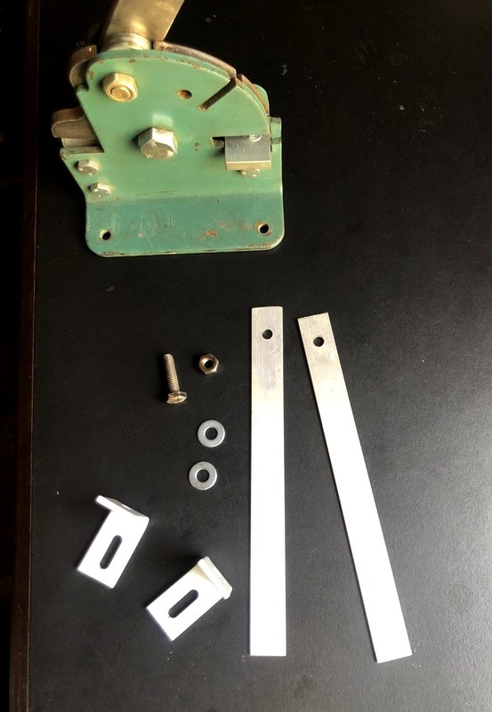

    This guillotine is made with a cutter blade; the arm is made with two aluminum strips and a wooden handle. It has a fence with a scale (in mm) on both sides of the cutting line. The cutting area is covered with a closed cell foam sheet.
    You can cut thin strips of plastic, rubber, or wood. The arm is fixed at 90o, relative to the fence, and templates can be used for cutting angles.
