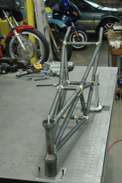

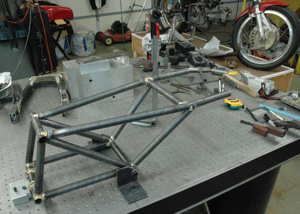

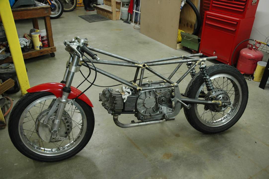

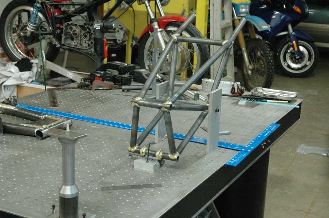

    I got the optical table to use as a motorcycle frame building jig, but that is a very occasional use and as it takes up a lot of room I use the surface for mounting other things.
    Grinding machine for drum brakes.-frame10.jpg Grinding machine for drum brakes.-frame13.jpg Grinding machine for drum brakes.-frame21.jpg Grinding machine for drum brakes.-startbuild04.jpg

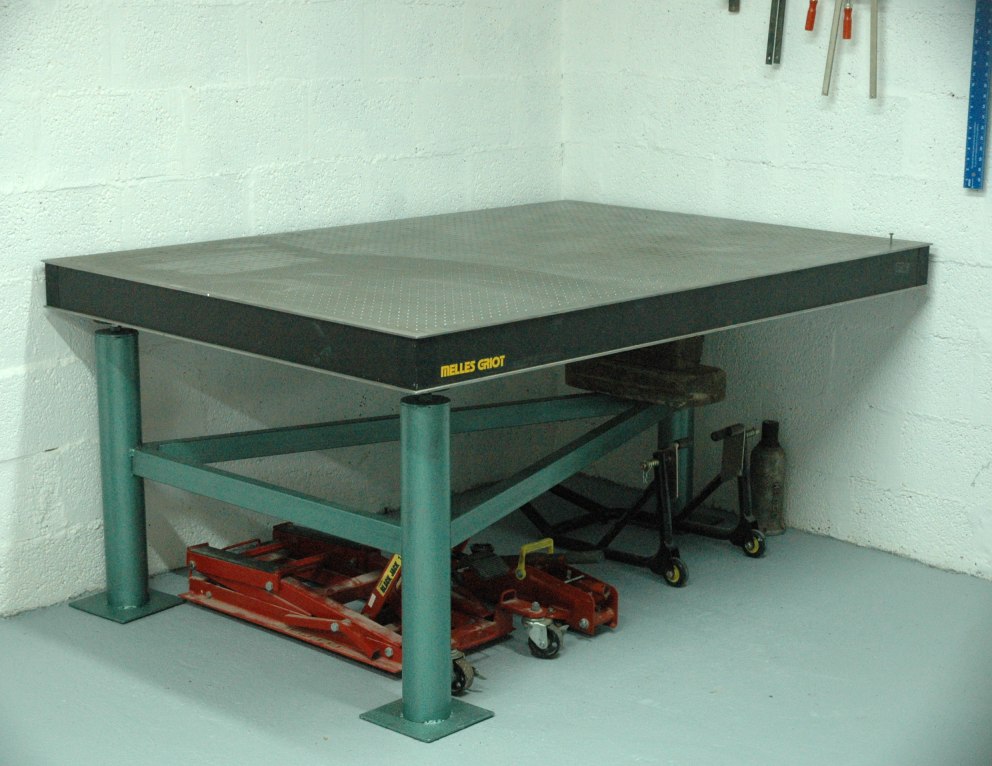

    Mine is 1.2 x 1.9 m. I lived in the US for 3 years and bought 3 from an optics company in Boston which was downsizing. The other two were much larger and they went to my employer. Mine came with very solid legs with air bag support at the top. When I returned to Spain I had a container for my stuff, this table, mill, lathe, motorbikes etc. just the normal stuff that anyone would accumulate in 3 years. However, there was no room in the container for the original legs and so I built a new support structure when I returned here. Three legs with height adjustment at the top.
    Grinding machine for drum brakes.-optical_table_on_new_stand.jpg Click image for full size.

    Thanks Tony - are the 3-leg distances of your stand the same as the original support's?
    As your table doesn't seem to be supported neither at its Bessel nor the Airy points,
    I wonder about how these dimensions came about.

    As soon as you put some heavy loads on such a table the idea of leg positioning for minimum sag or slopes etc. in the unloaded condition become somewhat irrelevant. In optics work you will generally be placing light weight objects with minimal effect on table stability and great accuracy is paramount. For my use there were other considerations, one being the maximum sensible area between the legs for a storage shelf.
    Engineering is about what works and this works.

    Thanks Tony, for sharing exactly those considerations and criteria.
