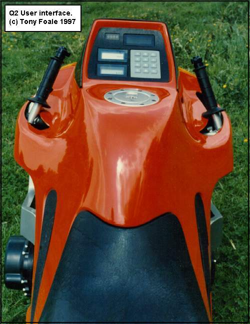

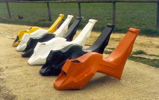

    That one was made as a project bike for SuperBike magazine. It is in private hands now but is still being used by its owner for track days, sprints and road use. Not bad for a 30 year low production machine. In fact I built around 7 or 8 of them and I know of 5 or 6 that are still in use or being restored. Here are a couple more pix. It had a key-less controls, Ignition, lights etc. controlled from the number pad protected by a PIN number. That was back in the 80s.
