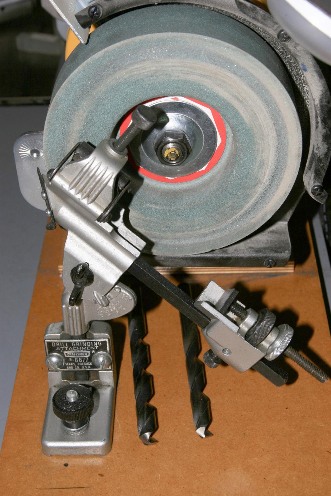

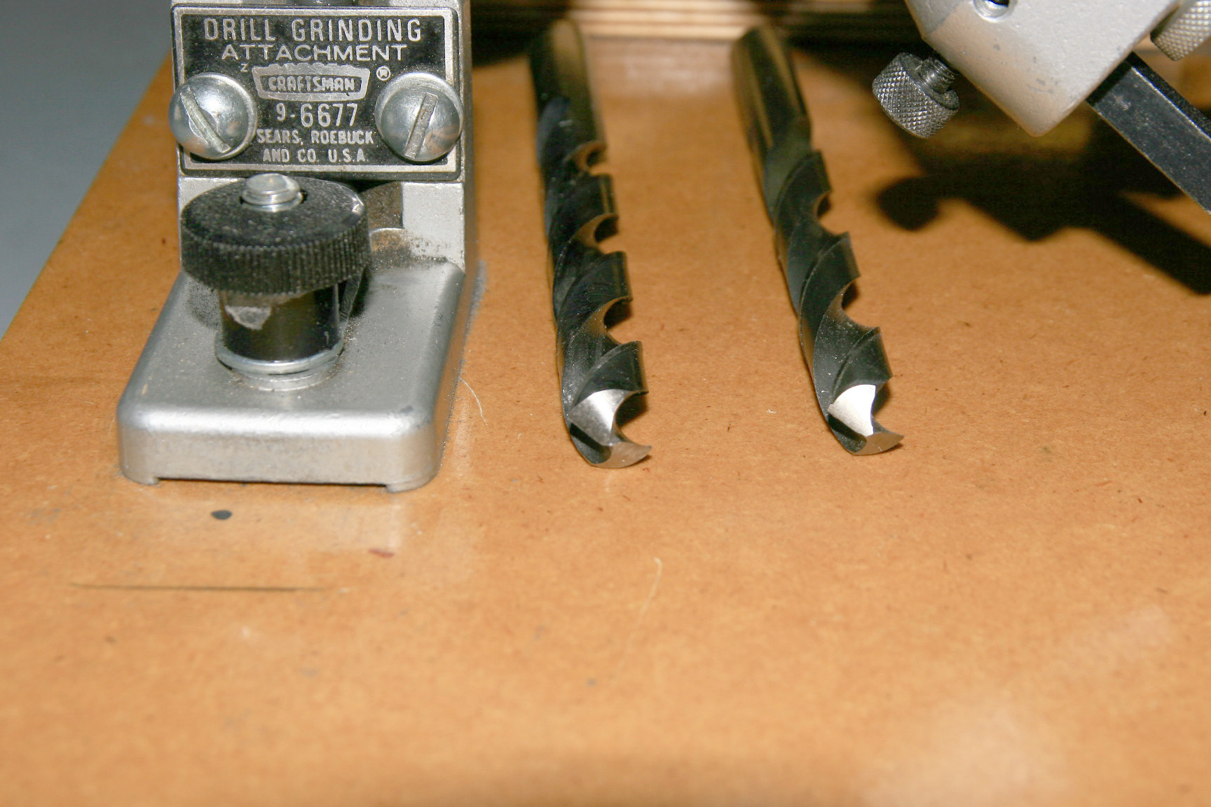

    An often over looked and under appreciated tool is the "old school" drill bit sharpener.
    General tools,Craftsman and now even being duplicated by (you know who).
    For about $20 to $30 you can get one.
    Grinding wheels for side grinding are available from Grizzly.
    Takes just a few minutes to grind or re-grind a drill bit.
    I can and do sharpen freehand but the results with the little jig are always better.
    I bought the grinder just for this purpose so I mounted it on a board with a short riser
    to bring the tool being ground a bit closer to center. Not necessary but that is where
    I like it. Sits under the bench until needed. I can always run a coarse wheel on the other end
    so the grinder will get used.
    Cheers, JR

    I recently purchased one from the you know who, HF. Seems to do the job decently
